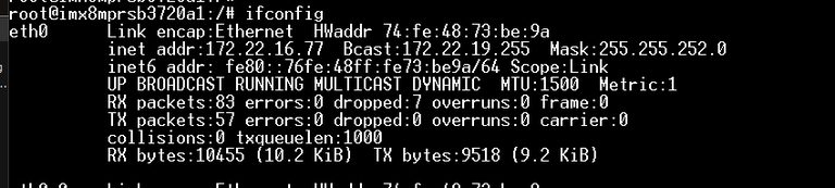

乙太網路使用方法(Ethernent Testing Method)​
Command: ifconfig
ifconfig eth0
ifconfig eth1
Command: ping 8.8.8.8
Ping 8.8.8.8

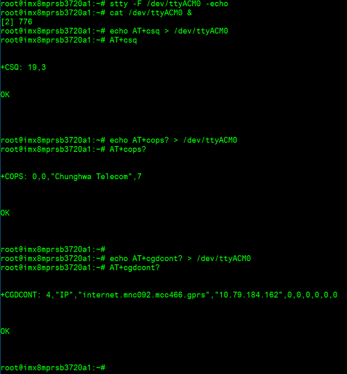

4G使用方法(4G Testing Method, Test with EWM-C117)​
Check and change module to pppd mode:
# stty -F /dev/ttyUSB3 -echo
# cat /dev/ttyUSB3 &
# echo AT+UUSBCONF? > /dev/ttyUSB3
4G step 1 - check config
Change to pppd mode:
# echo AT+UUSBCONF=0 > /dev/ttyUSB3
4G step 2 - set pppd mode
# echo AT+CFUN=16 > /dev/ttyUSB3
4G step 3 - reset module
The module will change to ttyACM0*, check again:
# stty -F /dev/ttyACM0 -echo
# cat /dev/ttyACM0 &
# echo AT+UUSBCONF? > /dev/ttyACM0
4G step 4 - verify ttyACM0
Set module to connect:
# echo AT+csq > /dev/ttyACM0
# echo AT+cops? > /dev/ttyACM0
# echo AT+cgdcont? > /dev/ttyACM0
4G step 5 - signal check

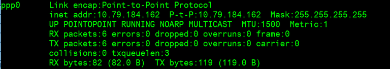

Connect to Internet:
# pppd connect 'chat -v -s -t 10 "" "AT" "" "ATDT*99***4#" "CONNECT" ""' \
user username password password /dev/ttyACM2 460800 nodetach crtscts debug usepeerdns defaultroute &
# ifconfig
4G step 6 - ifconfig after connect

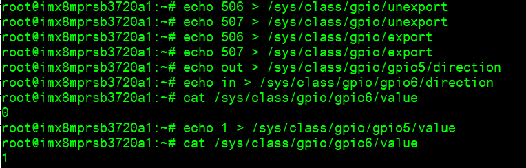

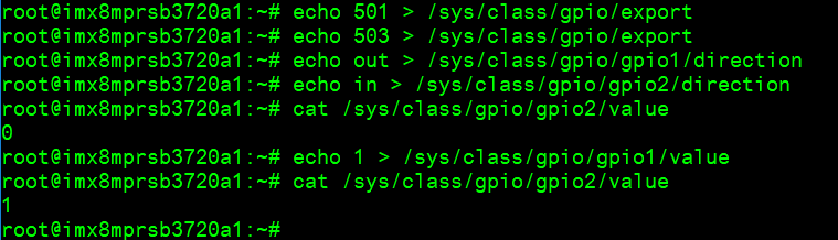

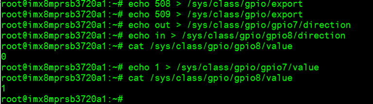

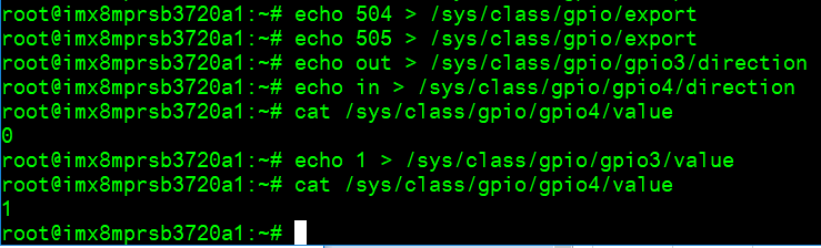

GPIO使用方法(GPIO Operating Method)​
You can use the following command to check the GPIO usage information:
cat /sys/kernel/debug/gpio
Here is an example on RSB-3720 2G Yocto5.0:
GPIO output from the GPIO expander:
  • gpiochip5: GPIOs 512-519, parent: i2c/0-0071, 0-0071
  • gpiochip6: GPIOs 520-527, parent: i2c/0-0070, 0-0070
GPIO2 and GPIO4 — outputs from GPIO expander 0x70, mapped to 520–527 (P0–P7)
GPIO5 to GPIO10 — outputs from GPIO expander 0x71, mapped to 512–519 (P0–P7)
CPU GPIO number formula: ((bank-1) × 32) + gpio_pin
  • GPIO11: ECSPI2_MOSI → GPIO5_IO11 → 139
  • GPIO12: ECSPI2_SCLK → GPIO5_IO10 → 138
RSB-3720 GPIO PinSourceNumber (Yocto3.0/3.3/4.0/4.2)Number (Yocto5.0)Number (Yocto5.0 imx8LBVF0153+)UIO-4030 GPIO
GPIO2i2c/0-0070, TCA9538 P5501525517
GPIO4i2c/0-0070, TCA9538 P7503527519
GPIO5i2c/0-0071, TCA9538 P0504512520DB9-1 DI1#
GPIO6i2c/0-0071, TCA9538 P1505513521DB9-6 DO1#
GPIO7i2c/0-0071, TCA9538 P2506514522DB9-2 DI2#
GPIO8i2c/0-0071, TCA9538 P3507515523DB9-7 DO2#
GPIO9i2c/0-0071, TCA9538 P4508516524DB9-3 DI3#
GPIO10i2c/0-0071, TCA9538 P5509517525DB9-8 DO3#

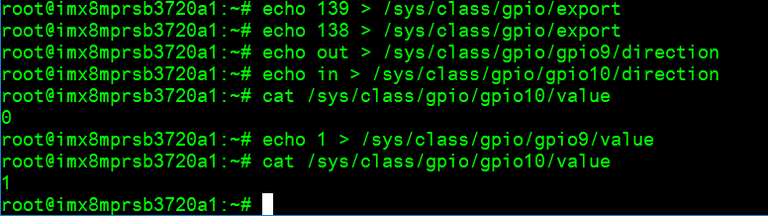

GPIO11MX8MP_IOMUXC_ECSPI2_MOSI__GPIO5_IO11139139139DB9-4 DI4#
GPIO12MX8MP_IOMUXC_ECSPI2_SCLK__GPIO5_IO10138138138DB9-9 DO4#
Short GPIO pin 2 & pin 4
GPIO short 2&amp;4
Short GPIO pin 5 & pin 6
GPIO short 5&amp;6
Short GPIO pin 7 & pin 8
GPIO short 7&amp;8
Short GPIO pin 9 & pin 10
GPIO short 9&amp;10
Short GPIO pin 11 & pin 12
GPIO short 11&amp;12

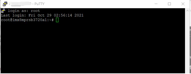

COM1複合使用方法(COM1 complex Port Operating Method)​

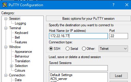

Note: please set the RS-485/RS-422 GPIO setting with SSH console.
ifconfig address for SSH
Reboot system
SSH connection
SSH connection login

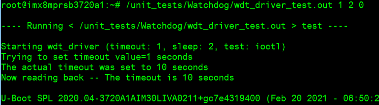

看門狗測試 (Watch Dog Test method)​
# System will reboot after 1 sec
/unit_tests/Watchdog/wdt_driver_test.out 1 2 0
Watchdog test

查看主板IP位址 (Check IP Address):
ifconfig
ifconfig IP address
Windows下SSH訪問及文件傳輸​
SSH Remote Log into Device
  • SSH遠程登陸,以putty選擇putty.exe(或者使用Xshell、SecureCRT等類似軟件)
  • 需要設置遠程設備的IP、通訊端口(默認22)、通訊方式,登錄后驗證用戶名密碼
SSH setting detail
SSH setting
SSH login
SSH console

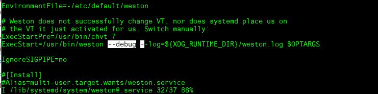

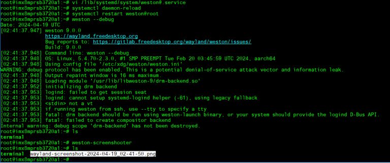

Screenshot on Weston by weston-screenshooter​
Add --debug in /lib/systemd/system/weston@.service:
Weston screenshooter config
Reload the service:
systemctl daemon-reload
systemctl restart weston@root
weston --debug
It will generate wayland-screenshot*.png:
Weston screenshot output
