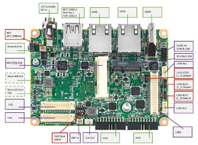

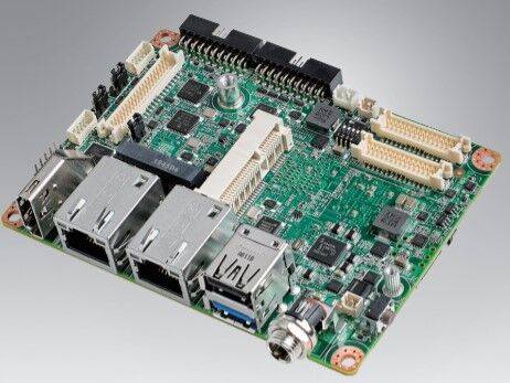

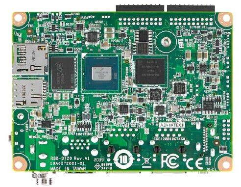

RSB-3720 接口布局圖(Board Dimension Layout)​
RSB-3720 board review
RSB-3720 connector location front
RSB-3720 connector location back
BATRTC Battery Connector
BL1LVDS Backlight 1
BL2LVDS Backlight 2
COM1COM + CAN Pin Header (default as debug console)
CSI1MIPI-CSI Camera Input 1
CSI2MIPI-CSI Camera Input 2
DCIN/DCIN 112V DC Power Input by DC Jack / by Pin Header
HDMIHDMI CONN
LAN1Ethernet 1
LAN2Ethernet 2
LOUTLine Out Pin Header
LVDSLVDS CONN.
M2M.2 Key E CONN.
MICMIC In Pin Header
MPCIEMini-PCIe CONN.
RSTReset Button
SDSD Slot
UIO1UIO40-Express Pin Header 1
UIO2UIO40-Express Pin Header 2
USB1USB CONN. (USB 3.2 Gen 1 on TOP + USB 2.0 on BOT)

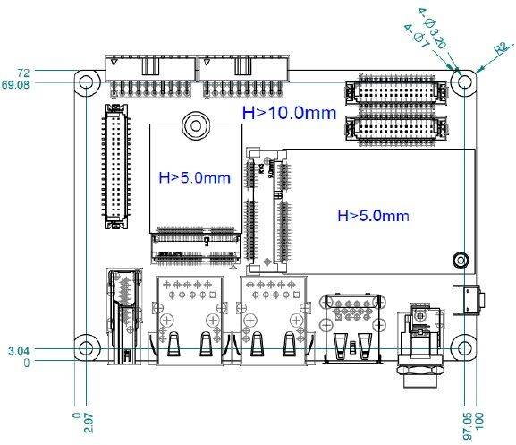

機械尺寸 (Mechanical Characteristics)​
RSB-3720 Board Dimensions

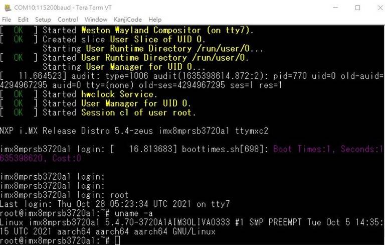

4. 設定終端機 (Set Debug Terminal)
以 Tera Term 為例介绍如何使用串口調試功能
波特率(Baud Rate):115200
數據位(Data):8
奇偶校驗(Parity):无 (none)
停止位(Stop):1
流控(Flow Control):无 (none)
Check the Serial port in Device Manager (查看PC端的串口號). If you cannot identify the Serial device, please check your serial driver.
5. 將可開機的SD 卡插入 SD 插槽, 並打開電源開機 (Plug the SD card into SD Card Slot, then turn on the power)
SD card slot

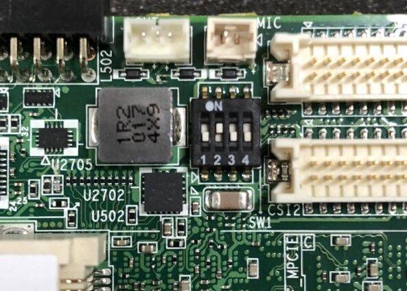

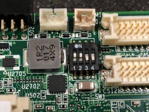

6. 確認撥碼開關 為 SD 卡開機模式 (Check the Switch)
SD 卡開機: 1, 2 on (Set the SD card boot up mode: 1 on, 2 on)
SD card boot switch
eMMC 開機: 2 on (Set the eMMC boot up mode: 2 on, others off)
eMMC boot switch

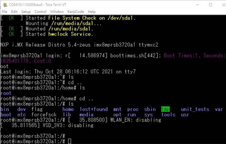

7. 打開電源,由終端機可看到開機訊息 (Turn on the power, you will see the debug message from Terminal tool)
Debug message on boot
8. 開機後請再重新開機一次,系統將會重新劃分磁區大小。(Reboot once; the system will reconfigure the partition.)

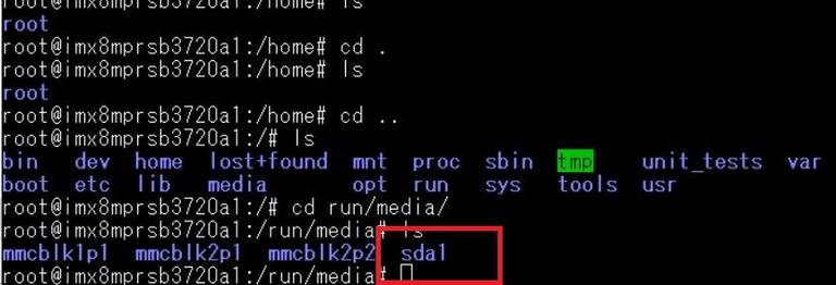

9. 燒錄eMMC前, 請將U盤插入USB port (Plug the USB Disk into USB port before flashing eMMC)
10. 在系統確認U盤 (Check the USB disk in the Yocto System)
Check USB disk in system

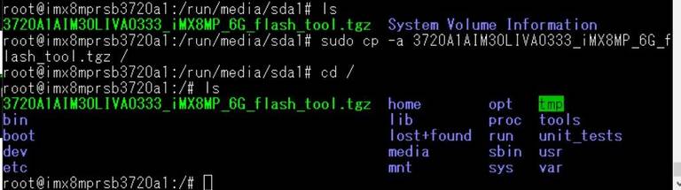

11. 將flash tool 燒錄鏡像,拷貝到根目錄 (Copy the flash tool into root file system)
Copy flash tool to root
Copy root check

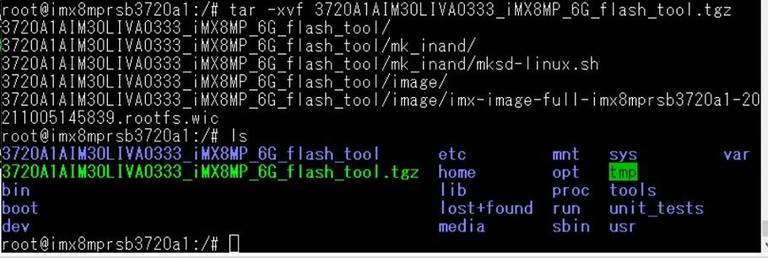

12. 解壓縮 flash tool (Unzip the flash tool)
Unzip flash tool

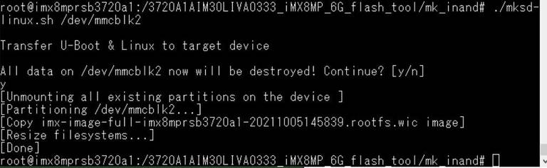

13. 執行燒錄eMMC (Execute the eMMC flash script)
Note: eMMC: /dev/mmcblk2
Flash eMMC done

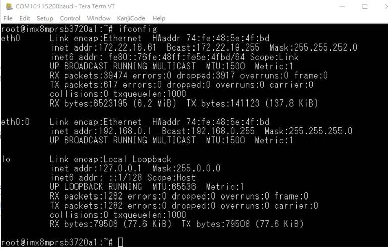

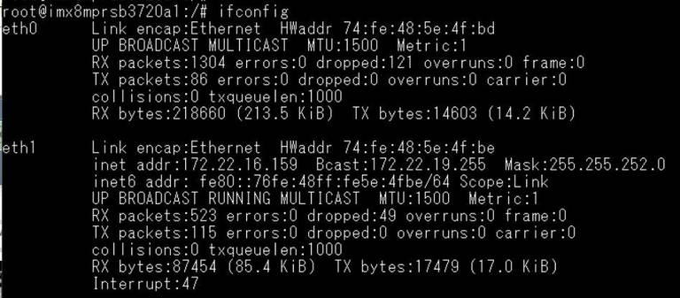

乙太網路使用方法(Ethernent Testing Method)​

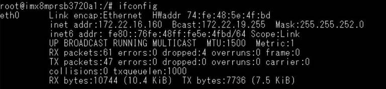

Command: ifconfig
ifconfig eth0
ifconfig eth1

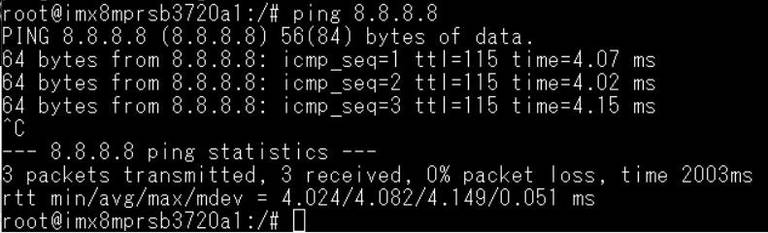

Command: ping 8.8.8.8
Ping 8.8.8.8

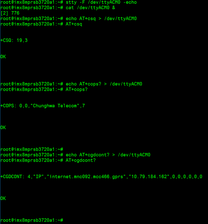

Set module to connect:
# stty -F /dev/ttyACM0 -echo
# cat /dev/ttyACM0 &
# echo AT+csq > /dev/ttyACM0
# echo AT+cops? > /dev/ttyACM0
# echo AT+cgdcont? > /dev/ttyACM0
4G step 5 - signal check

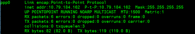

Connect to Internet:
# pppd connect 'chat -v -s -t 10 "" "AT" "" "ATDT*99***4#" "CONNECT" ""' \
user username password password /dev/ttyACM2 460800 nodetach crtscts debug usepeerdns defaultroute &
# ifconfig
4G step 6 - ifconfig after connect

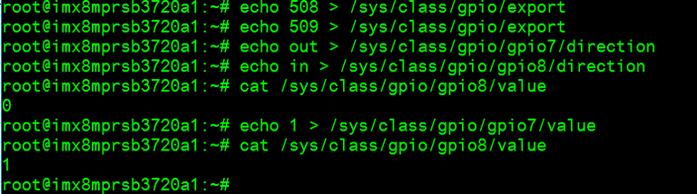

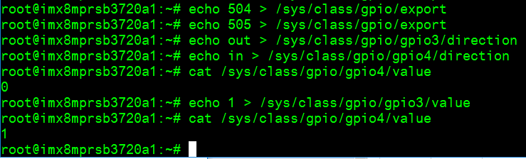

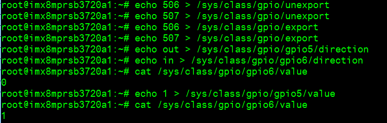

GPIO使用方法(GPIO Operating Method)​
You can use the following command to check the GPIO usage information:
cat /sys/kernel/debug/gpio
Here is an example on RSB-3720 2G Yocto5.0:
GPIO output from the GPIO expander:
  • gpiochip5: GPIOs 512-519, parent: i2c/0-0071, 0-0071
  • gpiochip6: GPIOs 520-527, parent: i2c/0-0070, 0-0070
GPIO2 and GPIO4 — outputs from GPIO expander 0x70, mapped to 520–527 (P0–P7)
GPIO5 to GPIO10 — outputs from GPIO expander 0x71, mapped to 512–519 (P0–P7)
CPU GPIO number formula: ((bank-1) × 32) + gpio_pin
  • GPIO11: ECSPI2_MOSI → GPIO5_IO11 → 139
  • GPIO12: ECSPI2_SCLK → GPIO5_IO10 → 138
RSB-3720 GPIO PinSourceNumber (Yocto3.0/3.3/4.0/4.2)Number (Yocto5.0)Number (Yocto5.0 imx8LBVF0153+)UIO-4030 GPIO
GPIO2i2c/0-0070, TCA9538 P5501525517
GPIO4i2c/0-0070, TCA9538 P7503527519
GPIO5i2c/0-0071, TCA9538 P0504512520DB9-1 DI1#
GPIO6i2c/0-0071, TCA9538 P1505513521DB9-6 DO1#
GPIO7i2c/0-0071, TCA9538 P2506514522DB9-2 DI2#
GPIO8i2c/0-0071, TCA9538 P3507515523DB9-7 DO2#
GPIO9i2c/0-0071, TCA9538 P4508516524DB9-3 DI3#
GPIO10i2c/0-0071, TCA9538 P5509517525DB9-8 DO3#
GPIO11MX8MP_IOMUXC_ECSPI2_MOSI__GPIO5_IO11139139139DB9-4 DI4#
GPIO12MX8MP_IOMUXC_ECSPI2_SCLK__GPIO5_IO10138138138DB9-9 DO4#

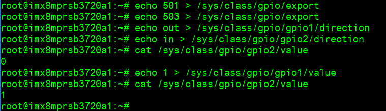

Short GPIO pin 2 & pin 4
GPIO short 2&amp;4
Short GPIO pin 5 & pin 6
GPIO short 5&amp;6
Short GPIO pin 7 & pin 8
GPIO short 7&amp;8
Short GPIO pin 9 & pin 10
GPIO short 9&amp;10

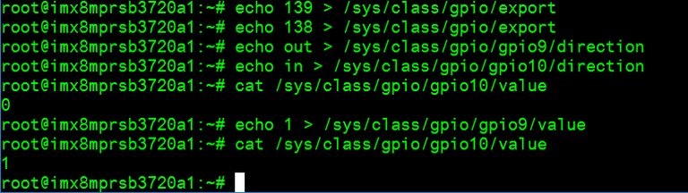

Short GPIO pin 11 & pin 12
GPIO short 11&amp;12

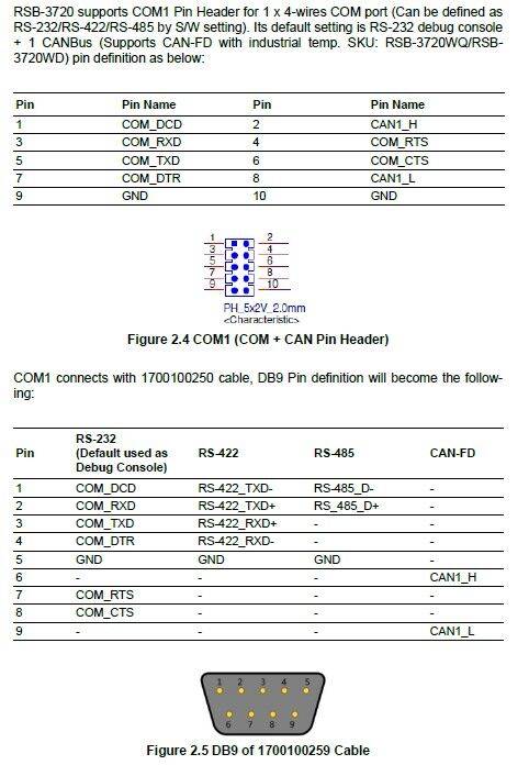

COM1複合使用方法(COM1 complex Port Operating Method)​

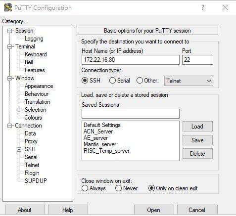

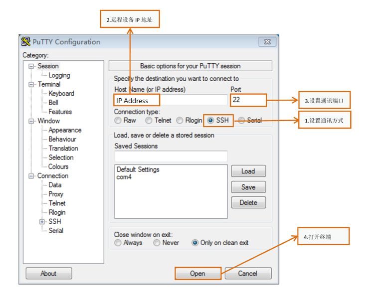

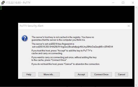

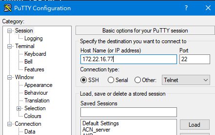

Note: please set the RS-485/RS-422 GPIO setting with SSH console.

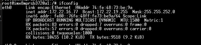

ifconfig address for SSH
Reboot system

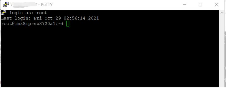

SSH connection
SSH connection login

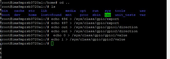

Set GPIO function mode
Set GPIO#496, #497:
Set to 0,1 for RS-485
Set to 1,1 for RS-422
Set to 0,0 for loopback
Set to 1,0 for RS-232
RS-232 (default as debug console)
COM1 connector

# echo 496 > /sys/class/gpio/export
# echo 497 > /sys/class/gpio/export
# echo out > /sys/class/gpio/gpio1/direction
# echo out > /sys/class/gpio/gpio2/direction
# echo 0 > /sys/class/gpio/gpio1/value
# echo 1 > /sys/class/gpio/gpio2/value

(Note: RSB-3720CQ & RSB-3720CD → CANBus only; RSB-3720WQ & RSB-3720WD → CAN-FD only)
Step 1: Connect UIO-4034 A101-2 CANbus port Pin 2 and Pin 7 to RSB-3720 COM1 with 1700100250 cable.

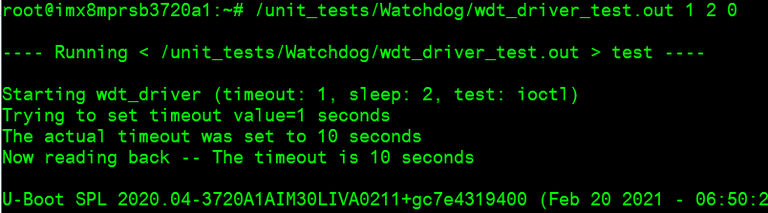

看門狗測試 (Watch Dog Test method)​
# System will reboot after 1 sec
/unit_tests/Watchdog/wdt_driver_test.out 1 2 0
Watchdog test

查看主板IP位址 (Check IP Address):
ifconfig
ifconfig IP address
Windows下SSH訪問及文件傳輸​
SSH Remote Log into Device
  • SSH遠程登陸,以putty選擇putty.exe(或者使用Xshell、SecureCRT等類似軟件)
  • 需要設置遠程設備的IP、通訊端口(默認22)、通訊方式,登錄后驗證用戶名密碼
SSH setting detail
SSH setting
SSH login
SSH console

網路Ping測試(Ping Network Testing)​
ping 8.8.8.8

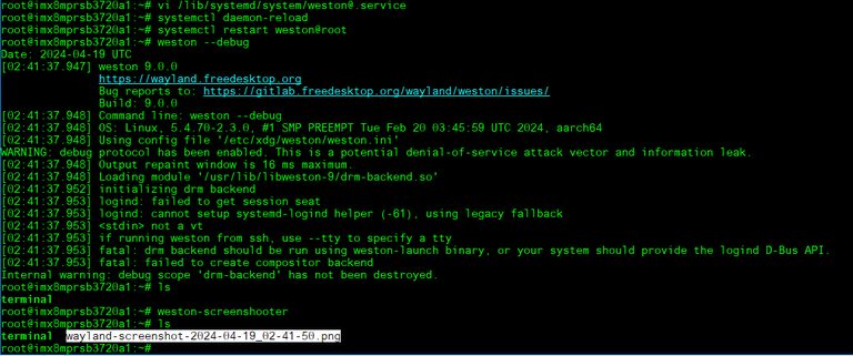

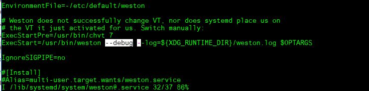

Screenshot on Weston by weston-screenshooter​
Add --debug in /lib/systemd/system/weston@.service:
Weston screenshooter config
Reload the service:
systemctl daemon-reload
systemctl restart weston@root
weston --debug
It will generate wayland-screenshot*.png:
Weston screenshot output
