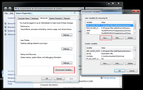

  1. Then refer to the following step to open system variables window: Computer -> Properties -> Advanced system settings -> Advanced -> envionment variables.
  2. Create a new system variable JAVA_HOME. The variable value is the location where JDK installed, such as: D:\Program Files\Java\jdk1.8.0_121
  3. Create a new system variable CLASS_PATH. The variable value is: .;%JAVA_HOME%\lib;%JAVA_HOME%\lib\tools.jar;
  4. Edit system variable PATH. Add: %JAVA_HOME%\bin;%JAVA_HOME%\jre\bin;

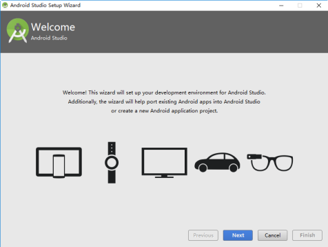

Please download "android-studio-bundle-145.3276617-windows.exe" from https://developer.android.com/studio/index.html . Launch the .exe file you downloaded. Follow the setup wizard to install Android Studio and any necessary SDK tools. The following pictures shows each step of the recommended setup procedure:

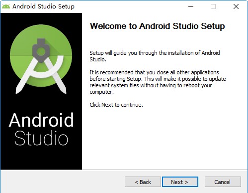

1 - Click Next to start setup.

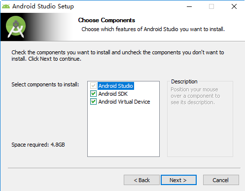

2 - Choose components.

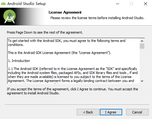

3 - Agree with the license.

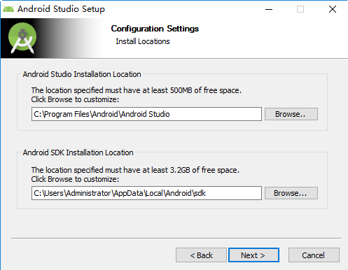

4 - Set installation location.

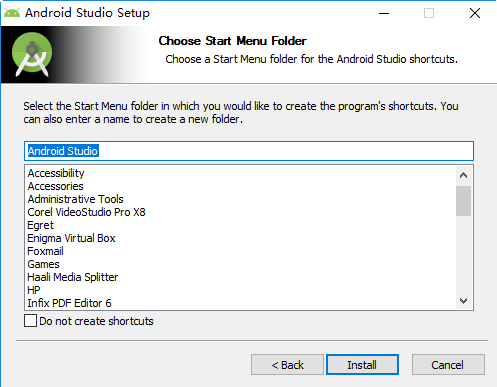

5 - Choose start menu folder.

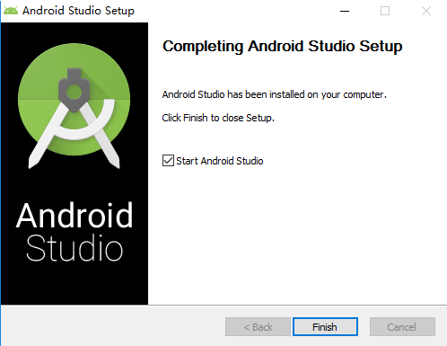

7 - Install finushed.

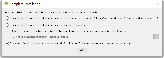

8 - Import settings from a previous version of studio.
9 - Click Cancel to continue.

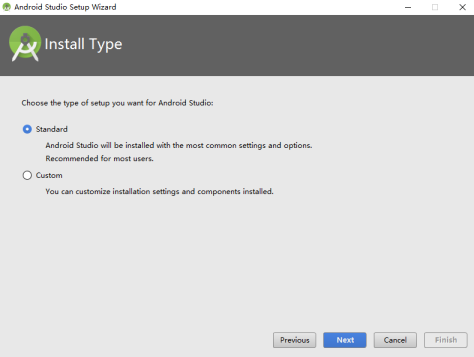

11 - Choose the setup type.

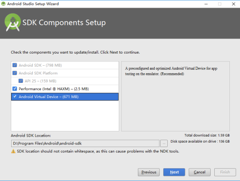

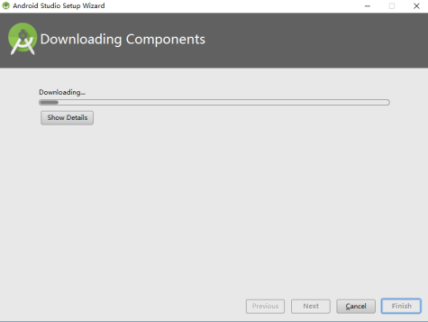

12 - Check the Android SDK components you want to install.

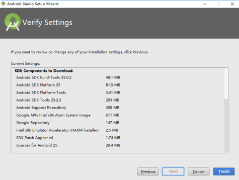

13 - Verify settings and start SDK install.
14 - Installing Android SDK.

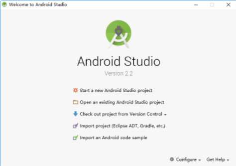

15 - Finished install.

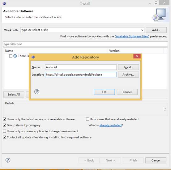

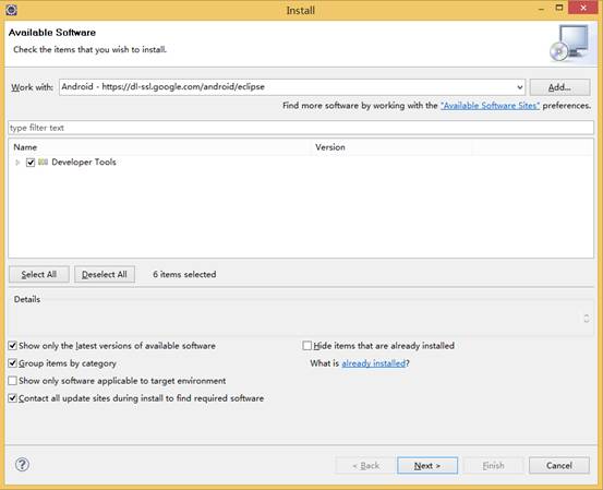

  1. Open eclipse->help->install new software
  2. Click Add to Add Repository Name:Android Location:
  3. Choose Developer Tools.

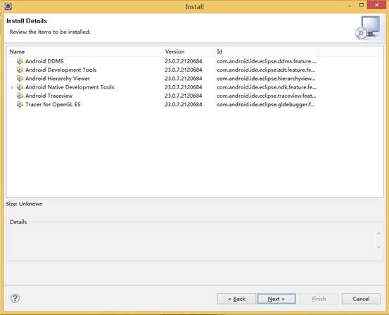

  4. Click Next.

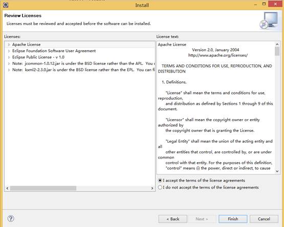

  5. Agree with the license.

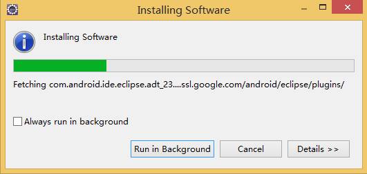

  6. Installing ADT plug-in.

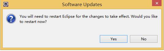

  7. Install finished and Restart Eclipse.

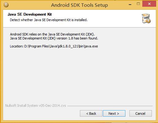

Please download " installer_r24.1.2-windows.exe " from https://dl.google.com/android/installer_r24.1.2-windows.exe . Launch the .exe file you downloaded . Follow the setup wizard to install necessary SDK tools.
  1. Click Next to start setup.

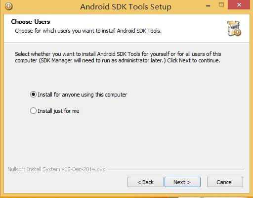

  2. Choose Users.

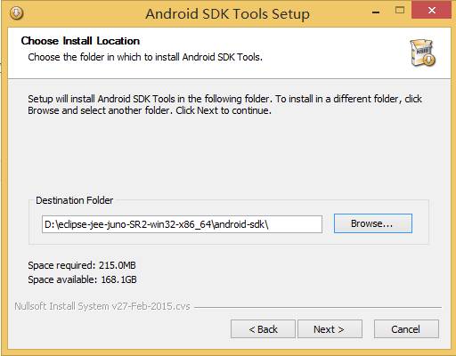

  3. Set installation location.

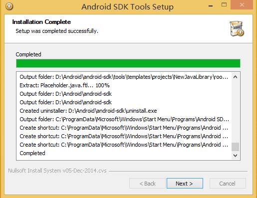

  4. Installing Android SDK Tool.
  5. Install SDK Tool finushed.

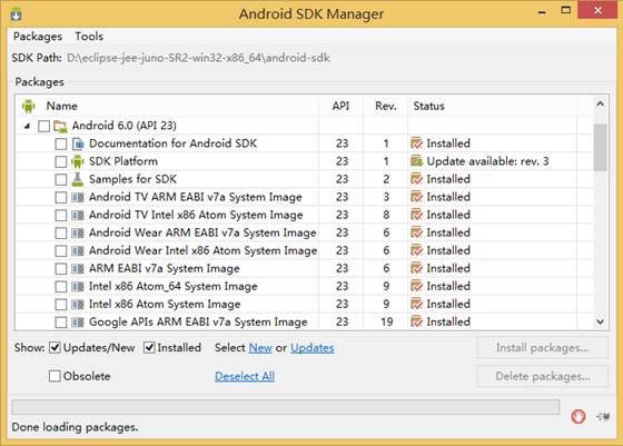

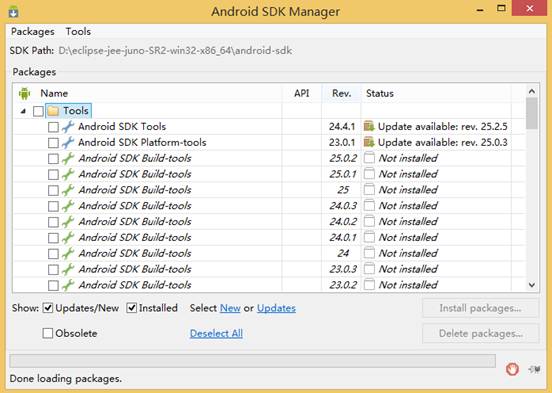

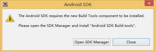

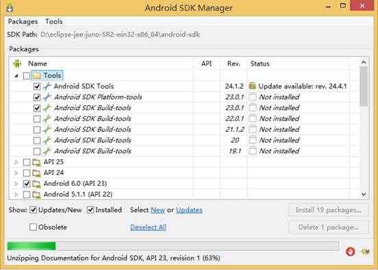

  6. Open SDK Manager.
  7. Choose the necessary components,Then click Install to installing SDK components.

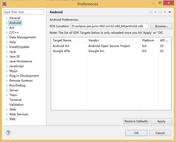

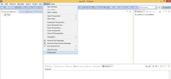

  9. Open eclipse->Window->preferences.
  10. Click Android and Browse to Set SDK Location. SDK Location: Fill in the path of your SDK installation

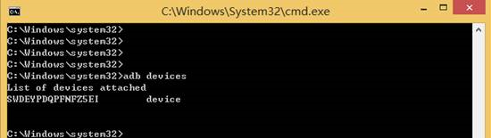

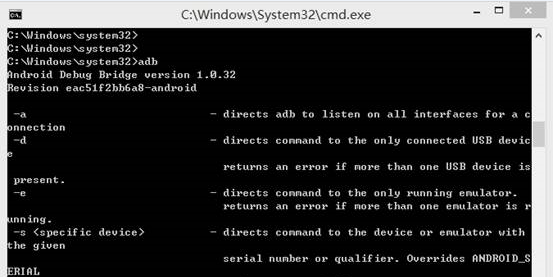

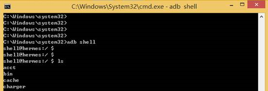

  3. Verification. Open cmd.exe and 3xecute adb command.

  1. View the device

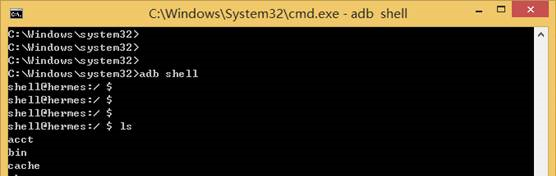

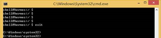

  2. Enter the shell terminal and execute the shell command
  3. Exit the shell command

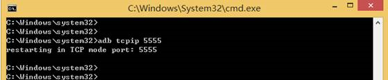

  1. Restart devices service Network debugging must ensure that debugging machine and equipment in the same local area network. First use the otg connect device to execute the following command and then disconnect the otg connection.

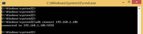

  2. connect devices
  3. Enter the shell terminal and execute the shell command

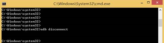

  5. Disconnect the devices
