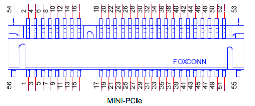

MINI PCIE接口
Mini PCIE​
RSB-4680 supports Mini-PCIE interface.
PinSignal NamePinSignal Name
1NC2+3.3V_PCIe
3NC4GND
5NC6NC
7NC8UIM_PWR
9GND10UIM_DATA
11NC12UIM_CLK
13NC14UIM_RST
15GND16UIM_VPP
17NC18GND
19NC20W_DISABLE#
21GND22PERST#
23NC24NC
25NC26GND
27GND28NC
29GND30NC
31NC32NC
33NC34GND
35GND36USB_MINIPCIE_N
37GND38USB_MINIPCIE_P
39+3.3V_PCIe40GND
41+3.3V_PCIe42LED_WWAN#
43GND44LED_WLAN#
45NC46LED_WPAN#
47NC48NC
49NC50GND
51NC52+3.3V_PCIe
