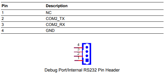

RS232/Debug Port (COM2)​
RSB-4680 can communicate with a host server (Windows or Linux) by using debug cable
