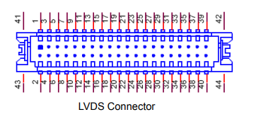

LVDS Connector (CN4)​
RSB-4680 provides a LVDS 20x2-pin board-to-board connector for dual channel 18/ 24/30 bit LVDS panel up to 1920 x 1080. For avoid to damage to the LCD panel, please make sure to set the right voltage level before powering on while connecting a LVDS panel (refer to jumper setting description for LVDS_BLP, LVDS_VDD1 and LVDS_VDD2 and LCD datasheet that you will use).
PinPin NamePinPin Name
1+VDD_LVDS2+VDD_LVDS
3GND4GND
5+VDD_LVDS6+VDD_LVDS
7LVDS0_D0-8LVDS1_D0-
9LVDS0_D0+10LVDS1_D0+
11GND12GND
13LVDS0_D1-14LVDS1_D1-
15LVDS0_D1+16LVDS1_D1+
17GND18GND
19LVDS0_D2-20LVDS1_D2-
21LVDS0_D2+22LVDS1_D2+
23GND24GND
25LVDS0_CLK-26LVDS1_CLK-
27LVDS0_CLK+28LVDS1_CLK+
29GND30GND
31LVDS0_D3-32LVDS1_D3-
33LVDS0_D3+34LVDS1_D3+
35LVDS_DDC_DAT36LVDS_DDC_CLK
37LVDS0_D4-38LVDS1_D4-
39LVDS0_D4+40LVDS1_D4+

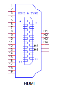

HDMI Display Interface (HDMI)​
RSB-4680 provides one HDMI interface connector. HDMI technology can support a maximum resolution of 3840 x 2160, but the actual resolution supported depends on the monitor being used.
PinDescriptionPinDescription
1HDMI _D2+11GND
2GND12HDMI _CLK-
3HDMI _D2-13HDMI_CEC
4HDMI_ D1+14NC
5GND15HDMI _CTRL_CLK
6HDMI _D1-16HDMI _CTRL_DAT
7HDMI _D1+17GND
8GND18+5V_HDMI_2
9HDMI _D0-19HDMI _HPD
10HDMI_CLK+
