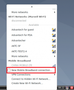

2. Power on the device, Click network connection icon,
then choose “New Mobile Broadband connection”.

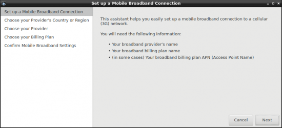

then you will see the following window, click "Next" button to the next step.

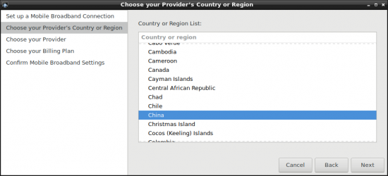

STEP 2 : Choose Provider's country or region of the SIM card you insert in STEP 0.

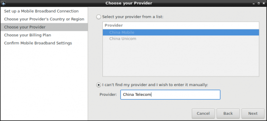

STEP 3 : Choose or Set the Provider's name.

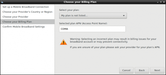

STEP 4 : Choose or Set APN.

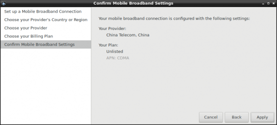

STEP 5 : Confirm your configuration and finish.
If the configuration has no error , then you could see a config file named "China Telecom connection" at /etc/NetworkManager/system-connections/.
