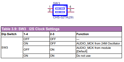

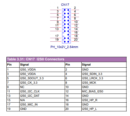

ROM-5880 supports 2 sound cards: 0 hdmi (with Audio), 1 rt5640-codec. (Connect Audio boardROM-EG57 on CN17 of SOM-DB2510 carrier board, set SW3 to 2.)

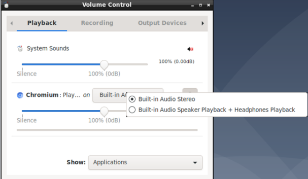

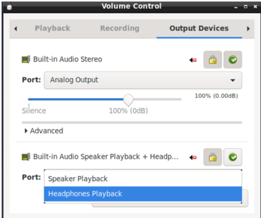

Set the default audio output when playing media files, if it supports audio. 1. Entry start->Sound & Video->PulseAudio Volume Control.
  1. Select “Build-in Audio stereo” for HDMI output or Select “Build-in Audio Speaker …” for rt5640-codec output.
