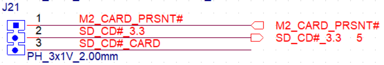

HW Setting for SOM-DB2510
SW1/2:1->ON ,2->OFF
J21:2-3
