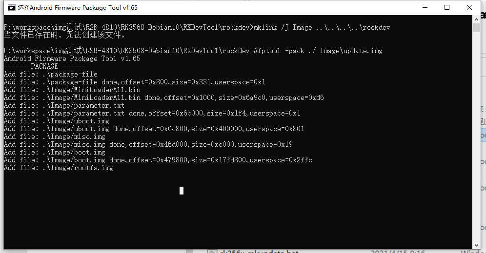

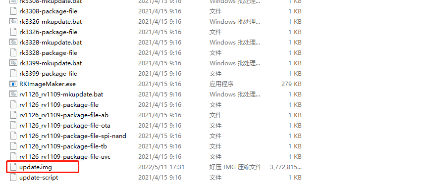

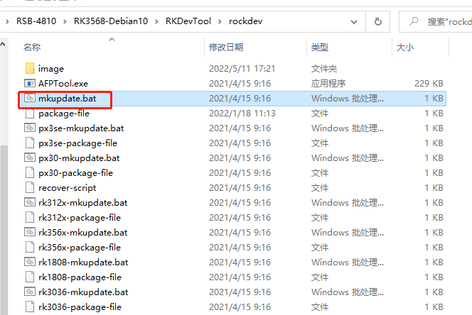

Step 1: Generate update.img , Double-click the mkupdate.bat file in the rockdev\ directory on your PC.​
Wait patiently to generate "rockdev\update.img".

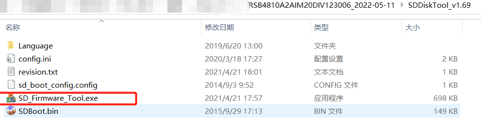

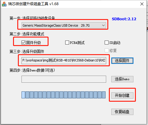

Step 2 :Decompress SDDiskTool v1.69.zip​
a ) Take an SD card with more than 8G (small card) Insert the SD card into the card reader, and then insert the device into the PC .
b )  Open SWick Create Upgrade disk tool v1.69, select the function mode as "Firmware upgrade" .
c )  Select the absolute path where the firmware upgrade is update.img .

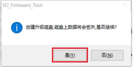

d )  Ignore Then click on "Start creating"
Wait patiently for burning success.

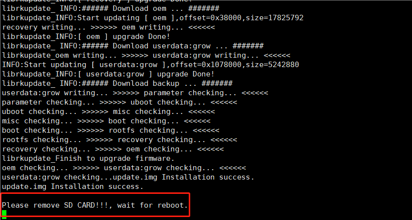

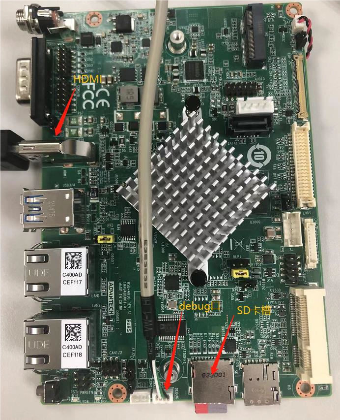

a ) Insert the SD card made just now into the SD card slot (it is recommended to connect the debug cable.
b )  Power on and wait for the burning to complete (connect the debug line to see the burning progress.
