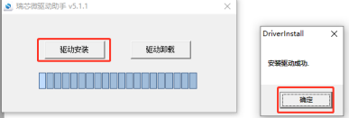

  • 2Step 1 :Extract Driver Assitant_v5.11.zip and follow these steps: Mounting driver.

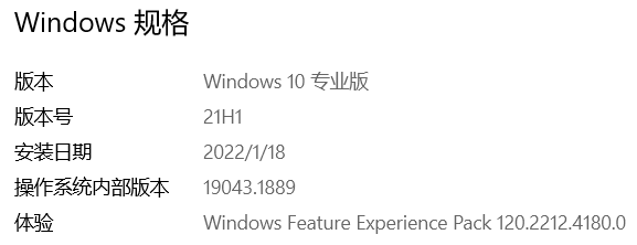

Step 0 :  For example, the PC used is a laptop. The specifications are as follows:​

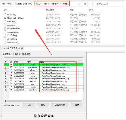

Decompress the downloaded image on the PC.

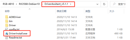

Step 1 :Extract Driver Assitant_v5.11.zip and follow these steps: Mounting driver.​
Run the installer and wait for the installation to succeed

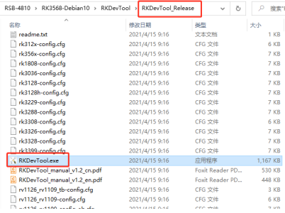

Step 2 : Go to the RKDevTool_Release folder and run the RKDevTool.exe program​
Step 3 : Ensure that the path to the burned file is correct​

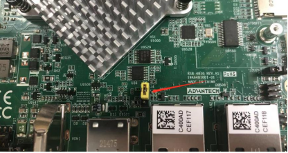

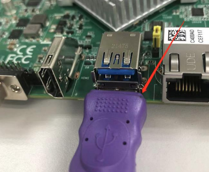

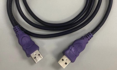

a ) A data cable with male USB connectors at both ends is available.

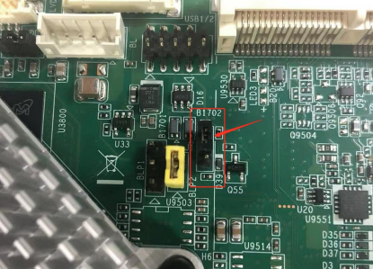

b ) Connect jumper cap J4 to Pin1 - Pin2(set USB-otg mode).
Note:Default jumper cap J4 Connect Pin2-Pin3 (Set USB-host mode)
c ) Connect one part of the USB cable to the USB port below and the other end to the computer.

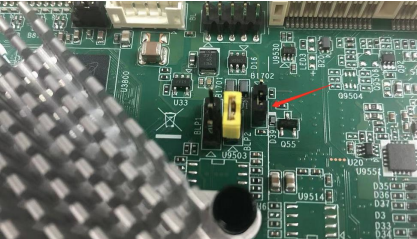

d ) Jump the J1 jumper cap to Pin1-Pin2, then switch on the 12V power supply.

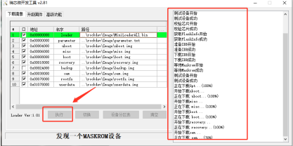

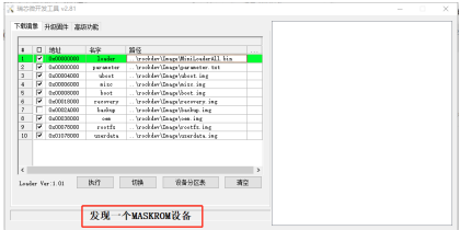

e ) Then the burning tool will appear: a MASKROM word found.
Note:Suspend or shut down the virtual machine during this process; otherwise, the pop-up information may affect the burning results.

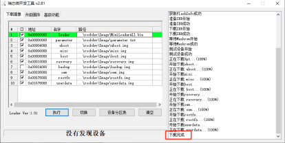

f ) Jump the J1 jumper cap back to Pin2-Pin3 and click "Execute"
g ) Just wait patiently for the burning to finish.
