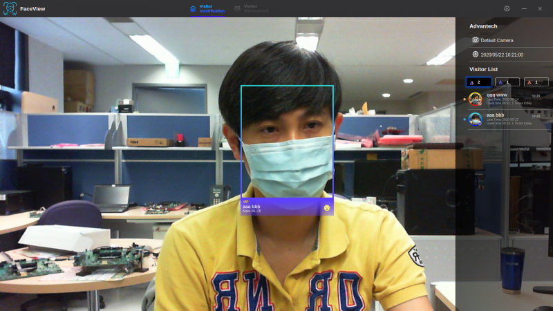

Run Application
To execute FaceView application, navigate to /usr/local/FaceView/ folder and double-click FaceView icon, or run the application by command mode.
$ cd /usr/local/FaceView/
$ ./FaceView
Then, you will be asked to input license key. Note: Please make sure your network connection is OK to activate the license successfully.
If the key is valid, you are able to see camera preview screen from the application.
For details of operations, please refer to the FaceView user guide.

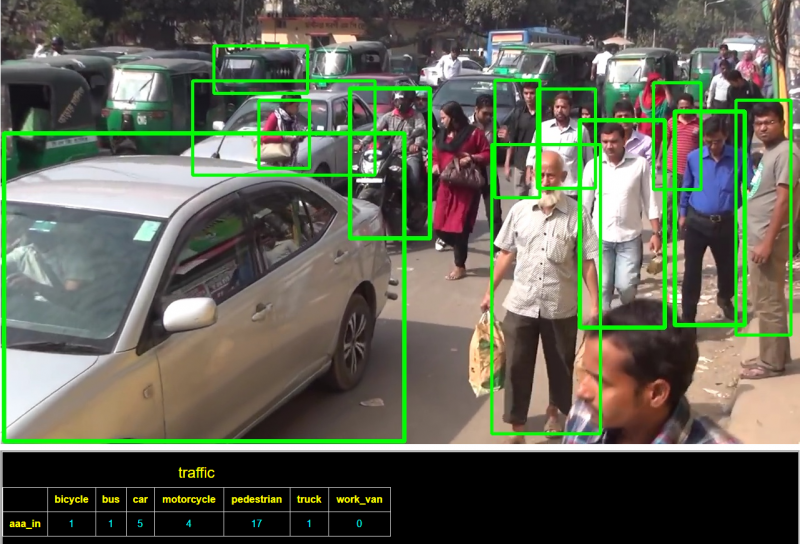

IVS
IVS service is a web application which provides intelligent video analysis for traffic issues, such as vehicle detection, license recognition, car parking & traffic counting.
Supported Platforms
- nVidia TX2: EPC-R7000
Run Application
You can connect the host PC with EPC-R7000 with microUSB cable (RNDIS) or Ethernet. Then, open browser with specific URL to access IVS service.
- RNDIS: 192.168.55.1:5000/admin
- Ethernet: <your device IP address>:5000/admin
After login with correct account/password, you can configure the monitor regions as your requirements.
For more details, please refer to the IVS user guide document.

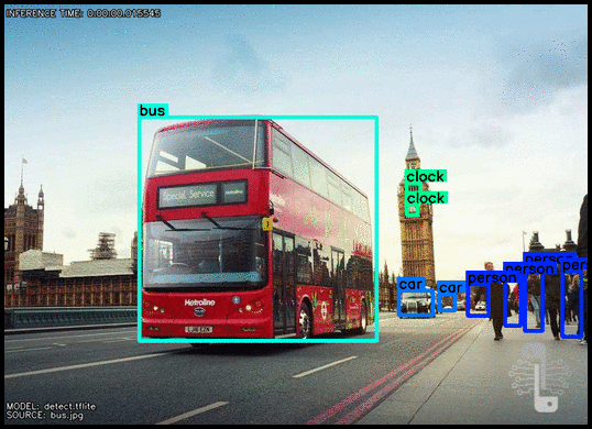

Demos Example - Running Object Detection SSD
Object detection is a computer technology related to computer vision and image processing that deals with detecting instances of semantic objects of a certain class (such as humans, buildings, or cars) in digital images and videos. Well-researched domains of object detection include face detection and pedestrian detection. Object detection has applications in many areas of computer vision, including image retrieval and video surveillance.
- Run the Object Detection Default Image demo using the following line: $ pyeiq --run object_detection_tflite
* This runs inference on a default image:
- Run the Object Detection Custom Image demo using the following line:
$ pyeiq --run object_detection_tflite --image=/path_to_the_image
- Run the Object Detection Video File using the following line:
$ pyeiq --run object_detection_tflite --video_src=/path_to_the_video
- Run the Object Detection Video Camera or Webcam using the following line:
$ pyeiq --run object_detection_tflite --video_src=/dev/video<index>
