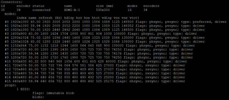

When the HDMI Cable is connected, the default resolution from edid (1920x1080) will be displayed on the screen. Maximum display 1920x1080. Check resolutions:
# modetest -c
# modetest -c
