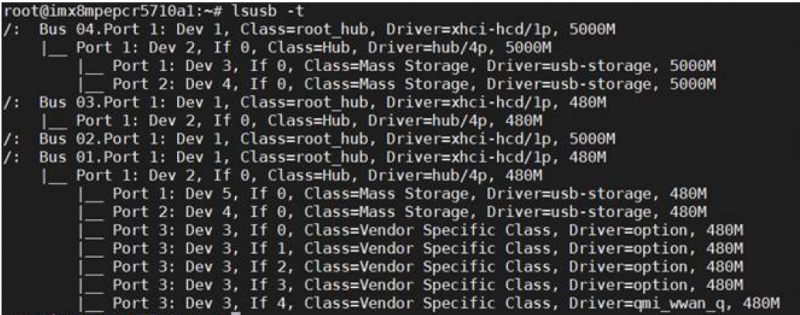

USB disk test (USB2.0/ USB3.2 port) Step 1: After inserting usb disk to USB 2.0 port or USB 3.2 port, issue the below command (lsusb -t) to check if the USB device is listed.
