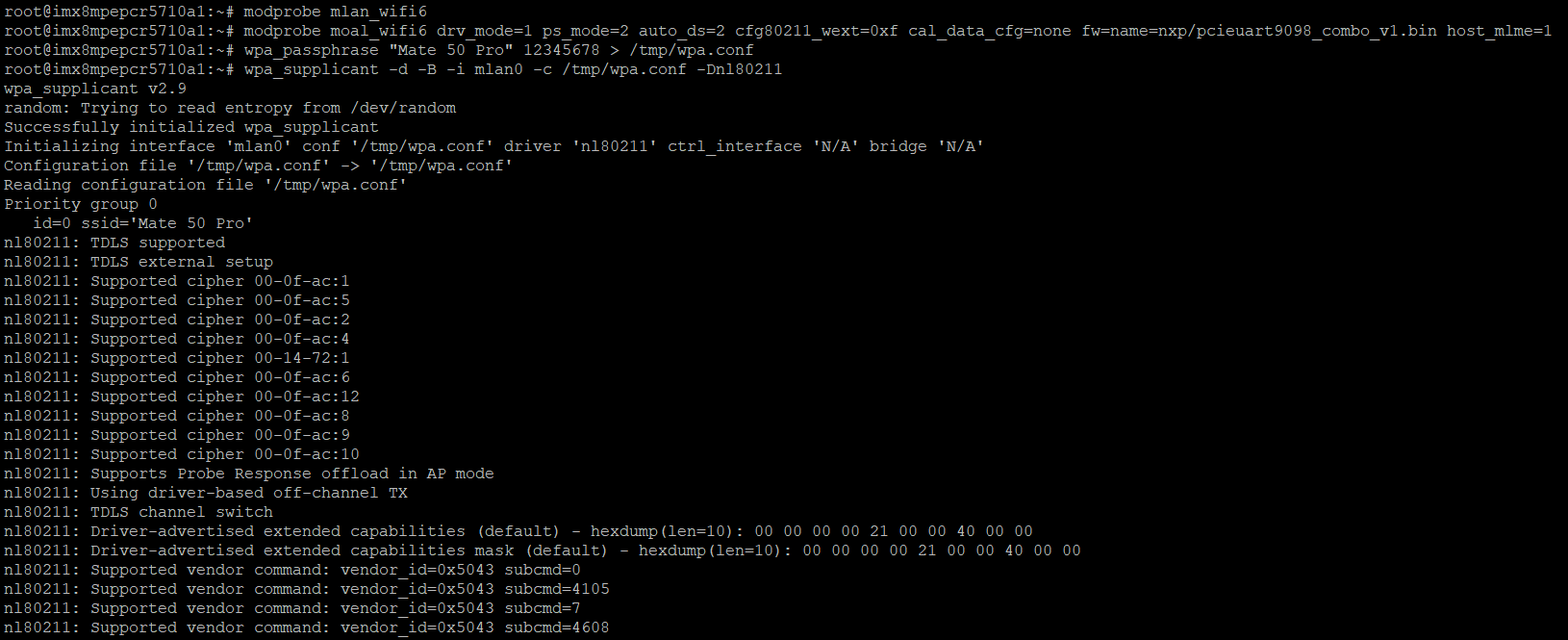

1. WiFi and Bluetooth modes can only one be selected. When switching is required, the system needs to be restarted.
# modprobe mlan_wifi6
# modprobe moal_wifi6 drv_mode=1 ps_mode=2 auto_ds=2 cfg80211_wext=0xf cal_data_cfg=none fw_name=nxp/pcieuart9098_combo_v1.bin host_mlme=1
# wpa_passphrase "SSID" Password > /tmp/wpa.conf
# wpa_supplicant -d -B -i mlan0 -c /tmp/wpa.conf -Dnl80211

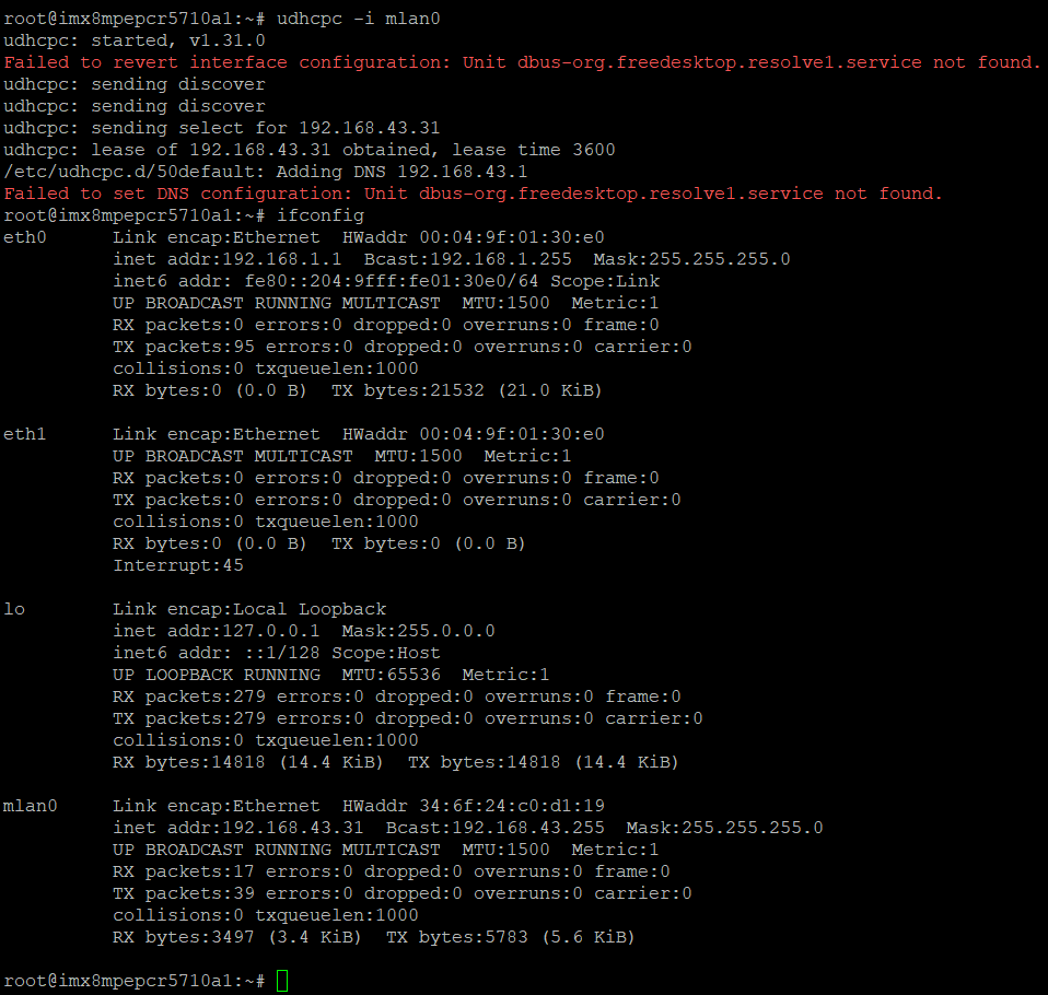

# udhcpc -i mlan0

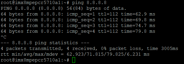

Ping network
ping -I mlan0 8.8.8.8

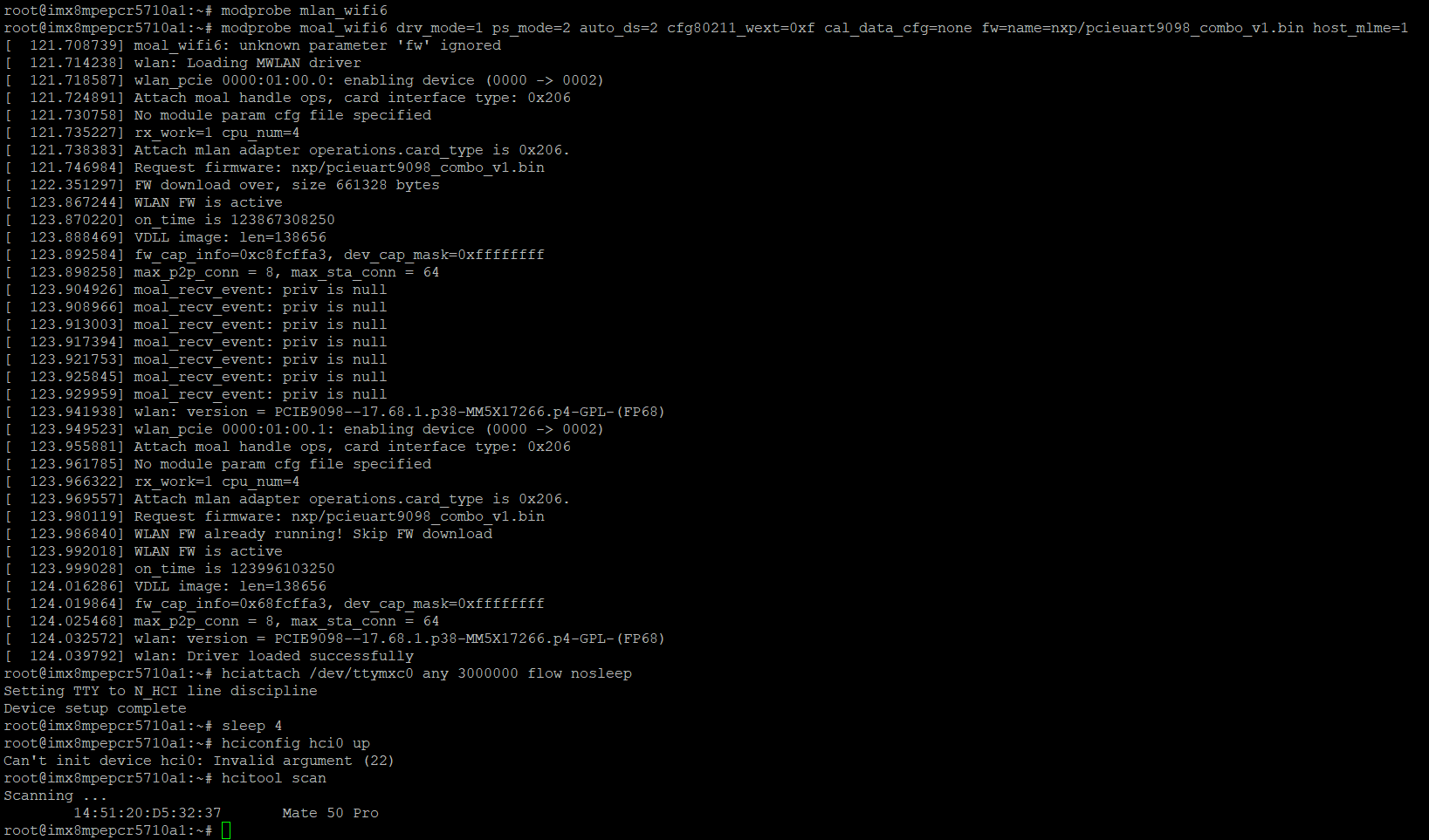

2. Test Bluetooth with AW-XM458MA Wifi6 Module (UART Interface) WiFi and Bluetooth modes can only one be selected. When switching is required, the system needs to be restarted
# hciattach /dev/ttymxc0 any 3000000 flow nosleep
# hciconfig hci0 up
# hcitool scan
