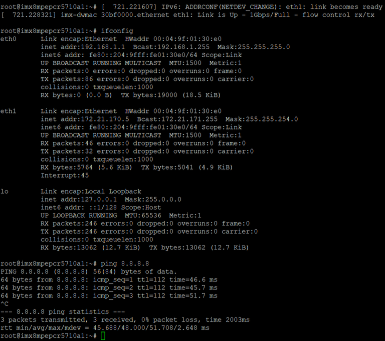

Eth1 Step 1: Check Ethernet device
Step 2 : Connect cable and ping test (eg. Eth1)
Routing function test: When LAN5 is already connected to an external network, LAN1 to LAN4 and FIBER can connect to other devices for network access.
