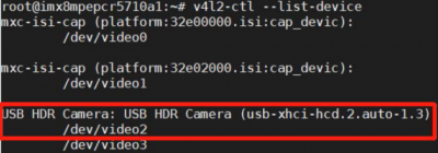

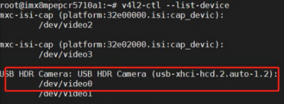

Enter the following command to view the USB camera node.
# v4l2-ctl --list-device
The execution results and commands are shown in the following figure. If the result is shown in Figure 1, enter command 1. If the result is shown in Figure 2, please enter command 2.
command1:
# sed -i 's/\/dev\/video[0-3]*/\/dev\/video0/g' /home/root/apps/detection/detection.sh
Figure 1:
command2 :
# sed -i 's/\/dev\/video[0-3]*/\/dev\/video2/g' /home/root/apps/detection/detection.sh
