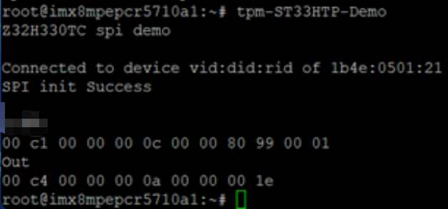

TPM-Z32H330TC​
Execute command (tpm-ST33HTP-Demo). If the following message appears, it is successful.
Note:This device is an i2c communication device, and the testing method is the same as described in section 3.7.4 above.
