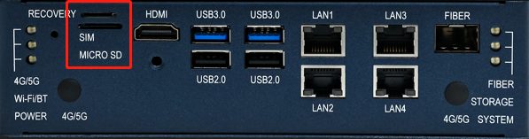

SIM&SD
EPC-R5710 support 1standard SIM socket and 1Micro SD socket at the rear side.
