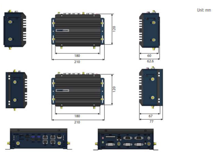

接口布局和尺寸(Layout and Sizes)​
External I/O​
EPC-R5710 Dimensions
接口布局圖 Board Dimension Layout​

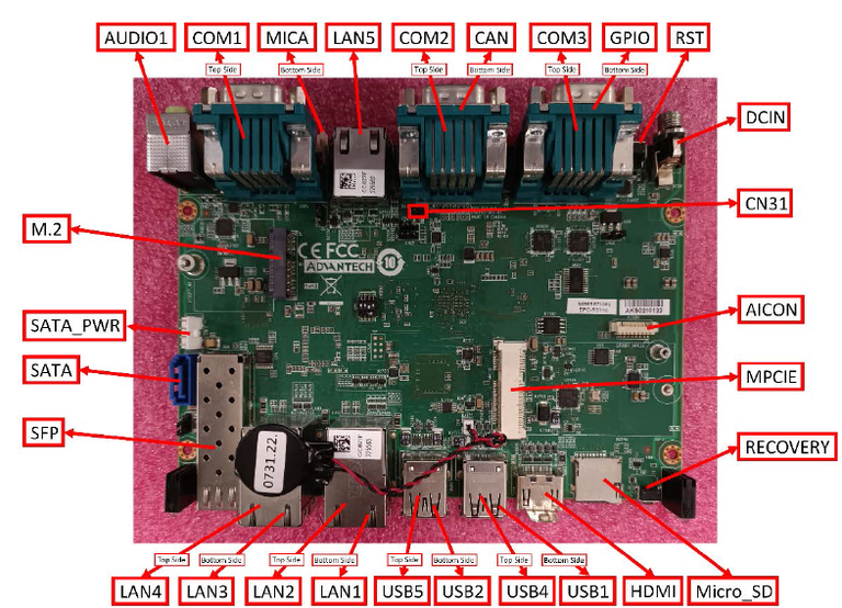

硬件接口说明(Hardware interface description)​
Connector List​
  1. DC Power Jack(DC-IN)
  2. USB Ports
  3. LAN Ports
  4. HDMI
  5. CAN
  6. RS232&DEBUG
  7. SIM&SD
  8. Reset
  9. Recovery
  10. GPIO
  11. I2S/I2C

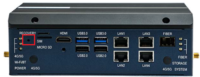

Button for System Recovery With SD Card
Function: used to upgrade or use the operating system in the SD card.
Operation method: press the recovery button, plug in the power supply, power on the machine, press it for 2 seconds, and start it from the SD card.
After starting from the SD card, whether the customer needs to upgrade or use the SD card system is customized by the customer (by modifying the files in the SD card).
EPC-R5710 Recovery Button

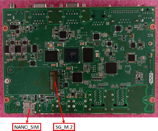

Mini-PCIE: 4G (EC20CEFHLG)​
M.2 KEY-E: WiFi5/6​
M.2 KEY-B: 5G​
