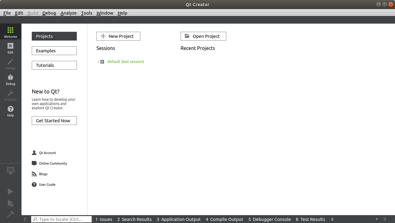

$ qtcreator
  1. The QtCreator's main window shows up.

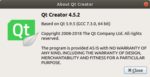

  2. Check QtCreator's version by using "Help" -> "About Qt Creator".

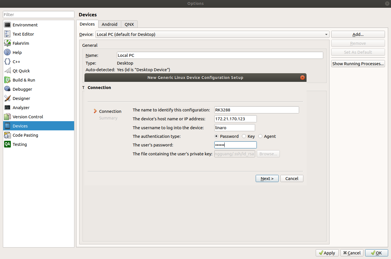

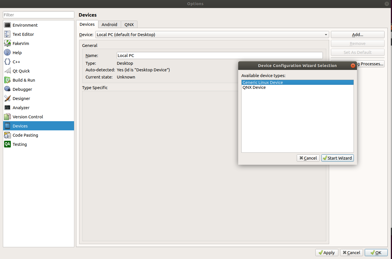

  2. Select the "Devices" page on the left, and click "Add..."
  3. Select "Generic Linux Device" and click "Start Wizard".
  4. Specify proper settings and click "Next>"
  5. Click "Finish"

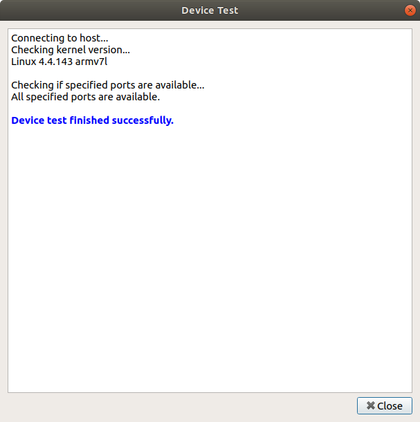

  6. Device test finished successfully. Click "Close". If device test failed, please go back to specify proper settings. (It is necessary to set a blank password at least, null password does not work.) (It means device's IP is incorrect or some network issues occured.)

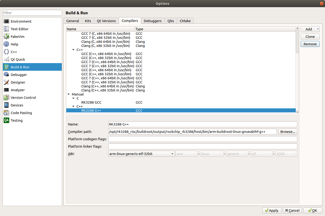

  8. Select the "Build & Run" page on the left, switch to "Compilers" tab, drop down "Add" menu and choose "GCC-->C++".
  9. Name the compiler as "RK G++"
  10. Click "Browse..." to select "/opt/rk3288_risc/buildroot/output/rockchip_rk3288/host/bin/arm-buildroot-linux-gnueabihf-g++"
  11. Click "Apply"

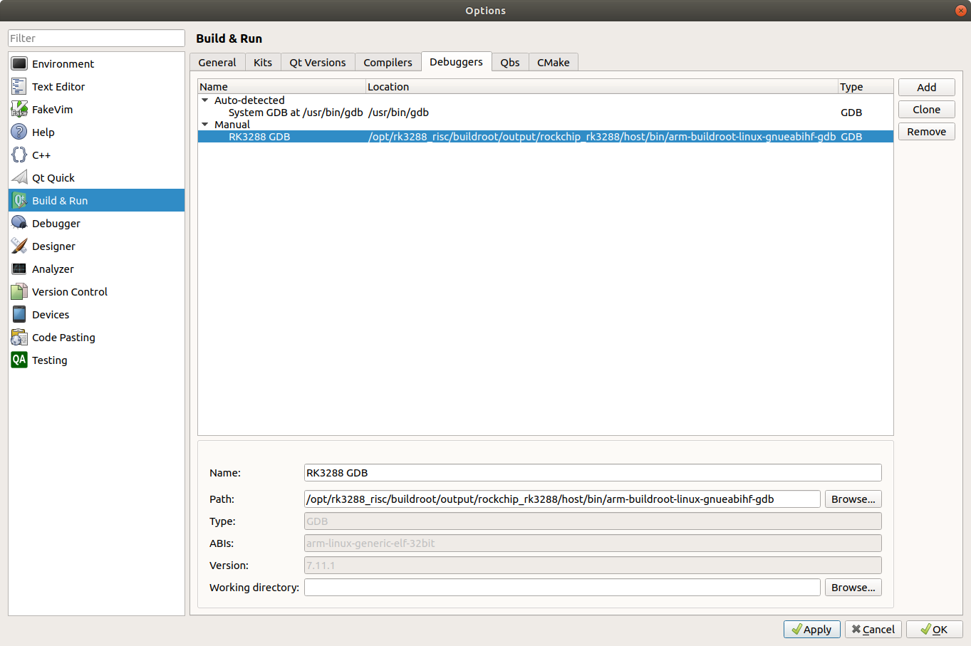

  12. Switch to the "Debuggers" tab
  13. Click "Add"
  14. Name the debugger as "RK GDB"
  15. Click "Browse..." to select "/opt/rk3288_risc/buildroot/output/rockchip_rk3288/host/bin/arm-buildroot-linux-gnueabihf-gdb"
  16. Click "Apply"

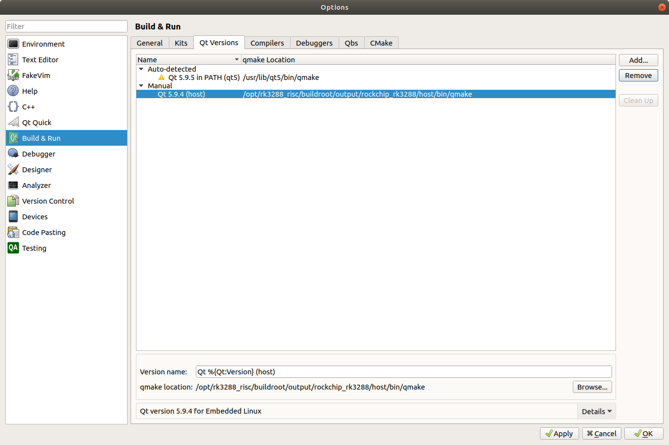

  17. Switch to the "Qt Versions" tab.
  18. Check if the "Qt 5.9.4 (host)" is auto detected in "Manual" item ? If not, click "Add..." to choose the proper qmake.
  19. Click "Apply"

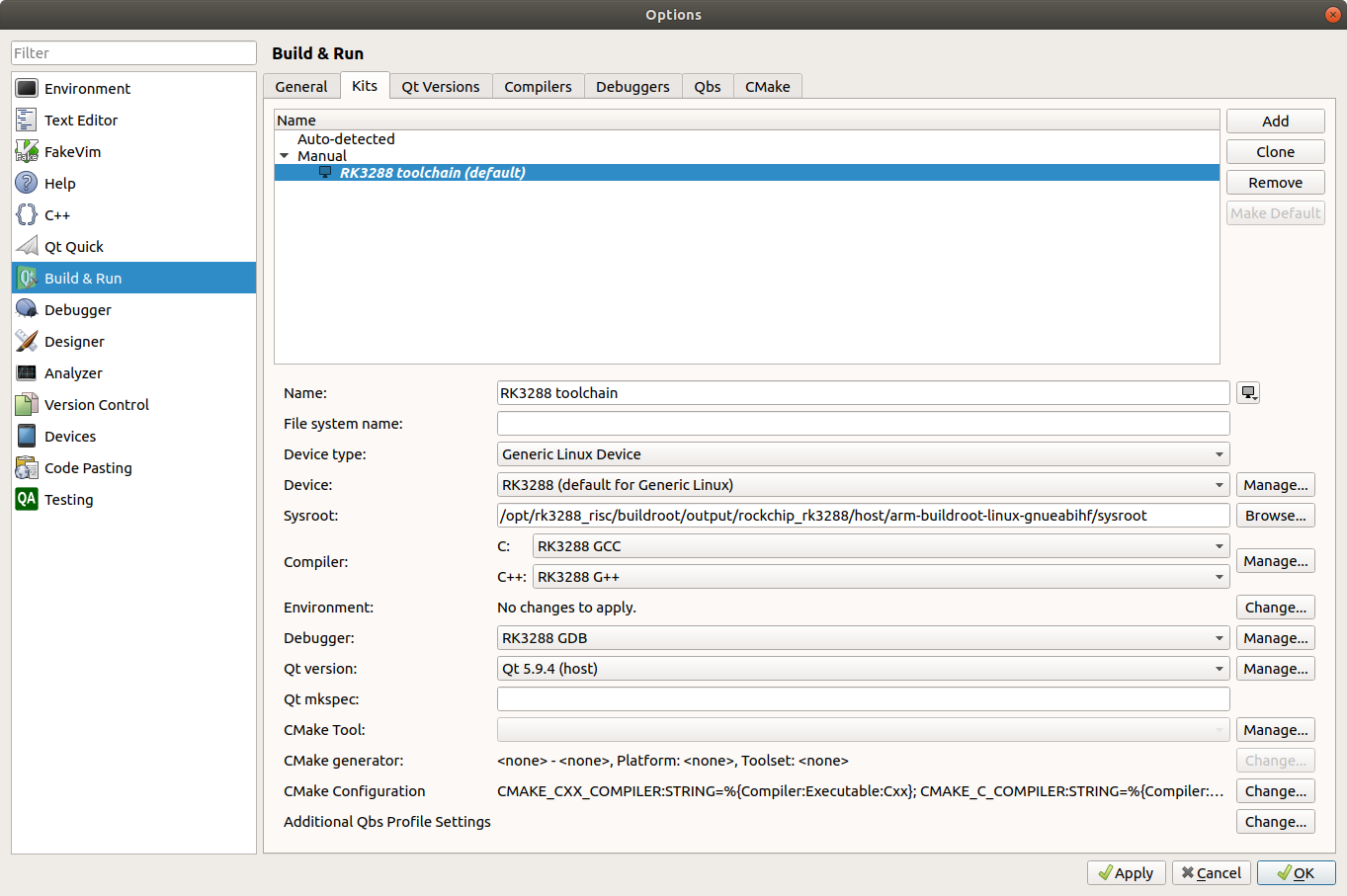

  20. Switch to the "Kits" tab.
  21. Click "Add".
  22. Name the kit as "RK toolchain"
  23. Specify the correct "Device Tpye", "Compiler", "Debugger" and "Qt version"
  24. Click "Browse..." to select "/opt/rk3288_risc/buildroot/output/rockchip_rk3288/host/arm-buildroot-linux-gnueabihf/sysroot" as sysroot
  25. Click Apply
  26. Click OK to finalize the configuration.

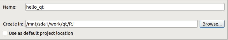

  4. Use "hello_qt" as name
  5. Create in "/mnt/sda1/work/qt/PJ"

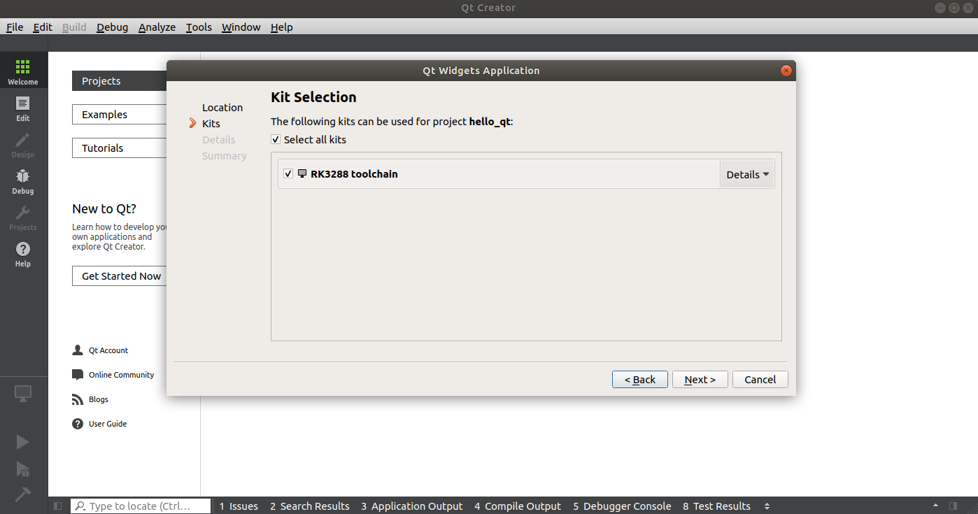

  6. Click "Next"
  7. Check "RK3288 toolchain"
  8. Click "Next".

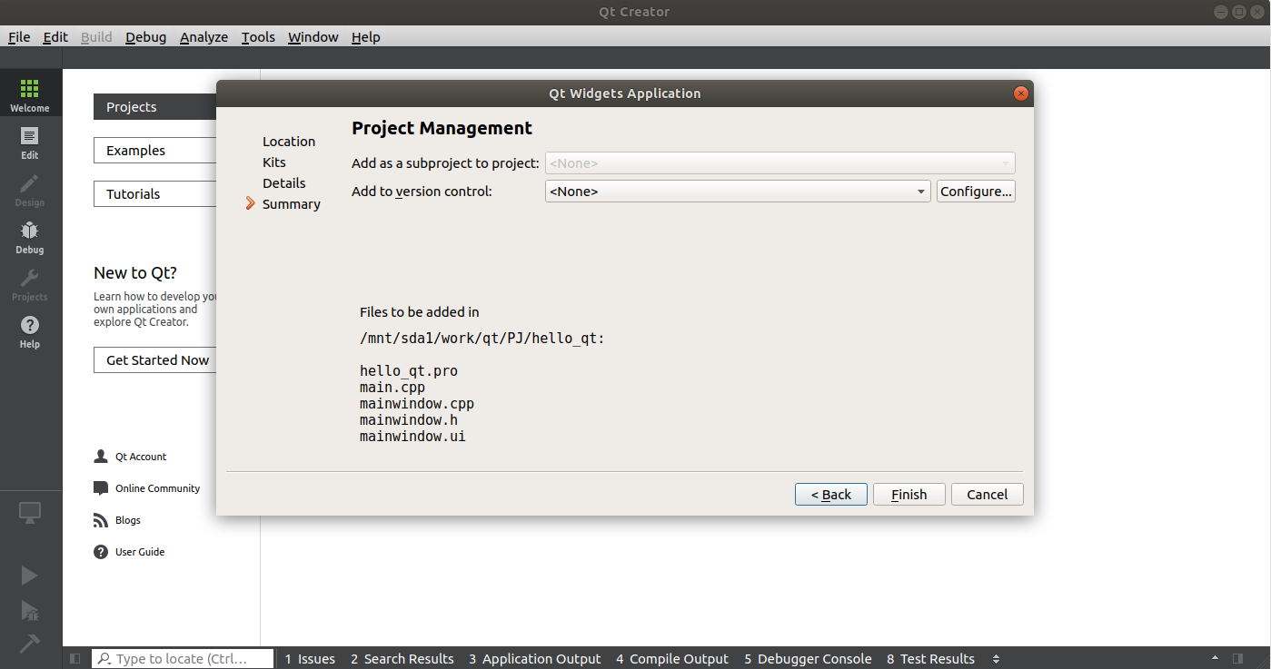

  9. Use default settings for "Class Information"
  10. Click "Next"
  11. Use default settings for "Project Management"
  12. Click "Finish"

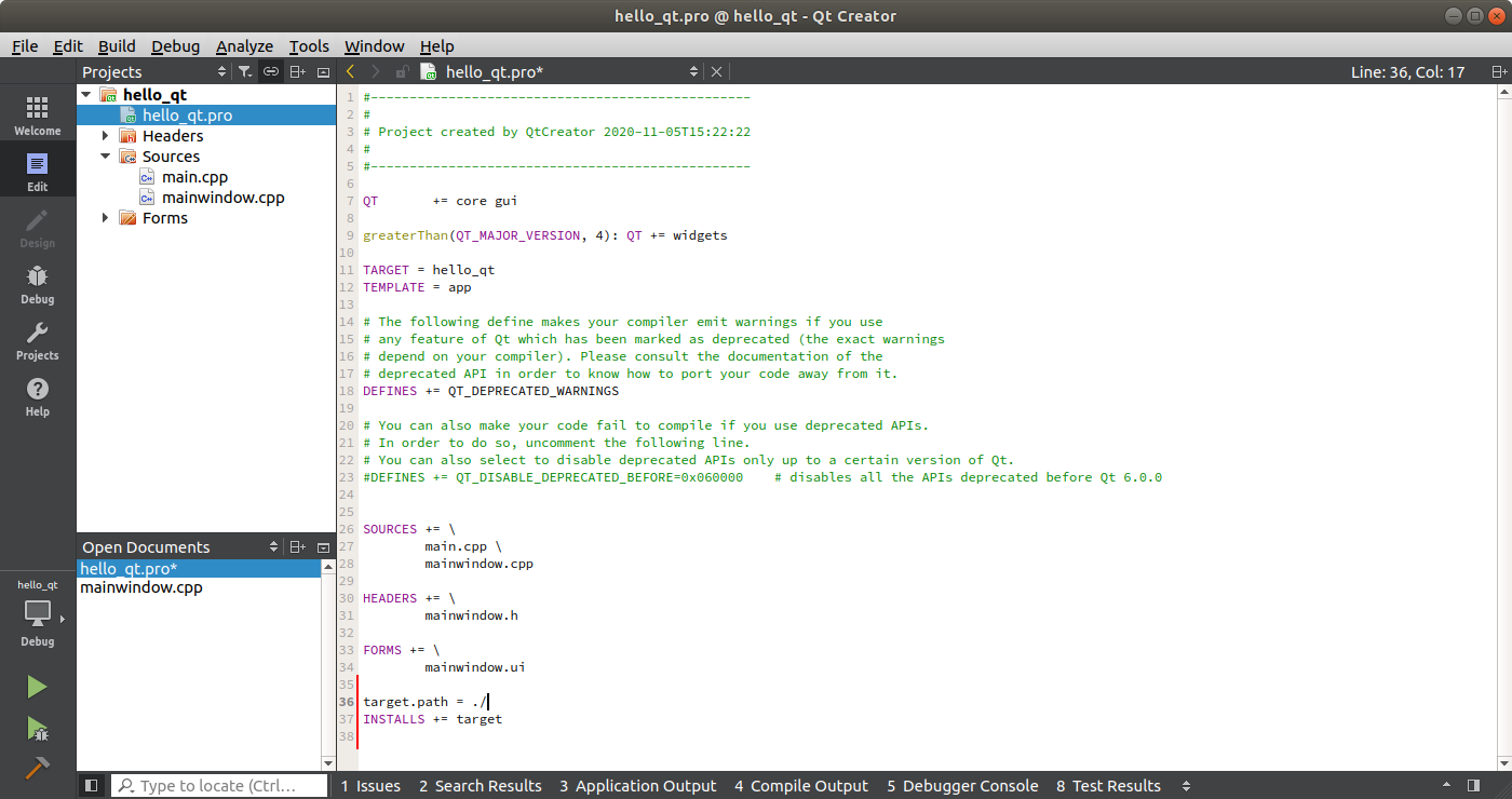

  13. Double click "hello_qt.pro" to switch to editor window
  14. In new project it is necessary to add following two lines into qt project file. target.path = ./INSTALLS += target
  15. Press "Ctrl+S" to save file.

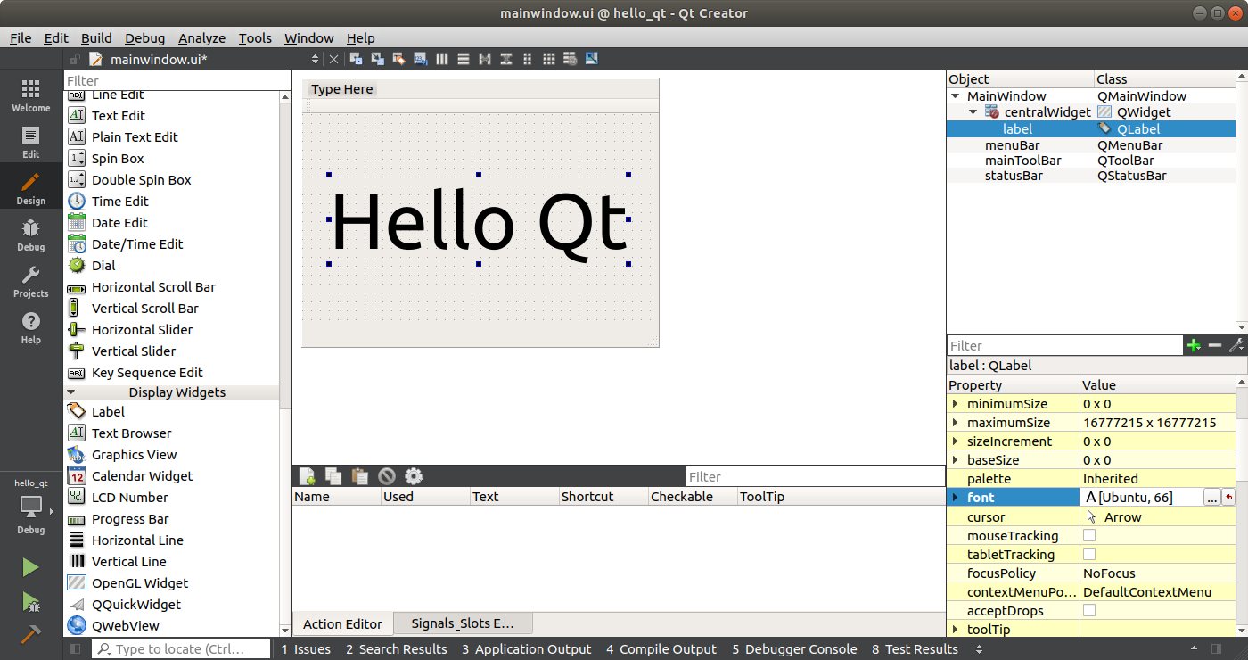

  16. Double click "mainwindow.ui" to switch to Design mode
  17. Drag & drop one Label widget on main form, use property editor on the right side to change text and font size
  18. Save all project files using "File" -> "Save All"

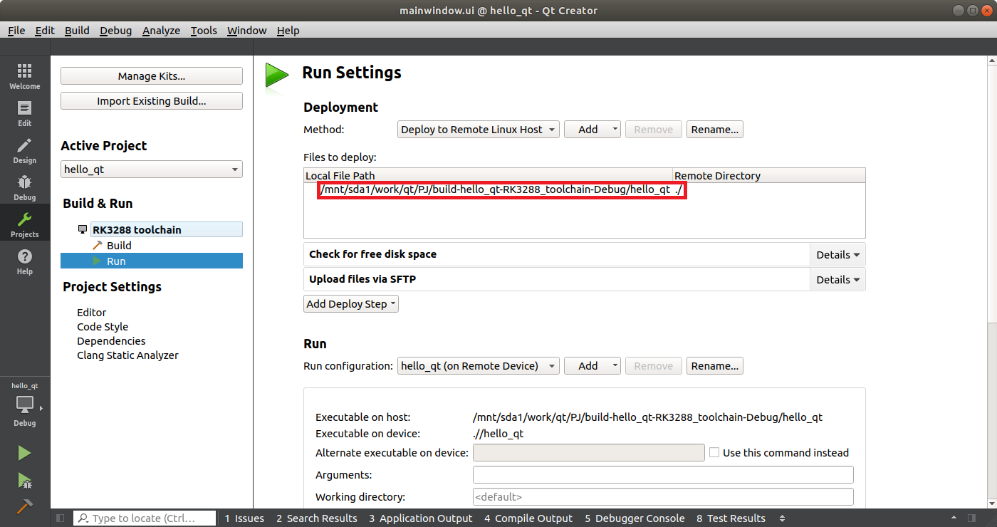

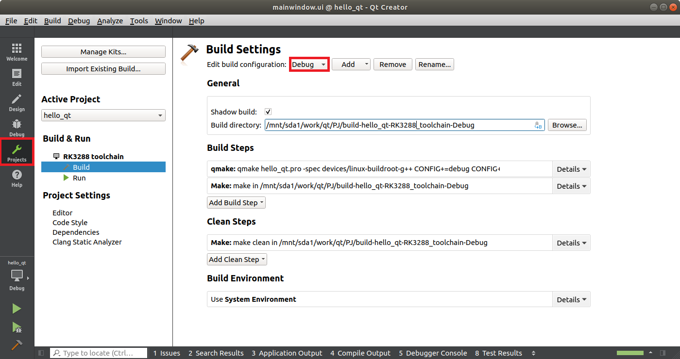

  1. Switch to "Projects" mode
  2. Check if "build configuration" is set to "Debug".
  3. Check if "Files to deploy" is correct

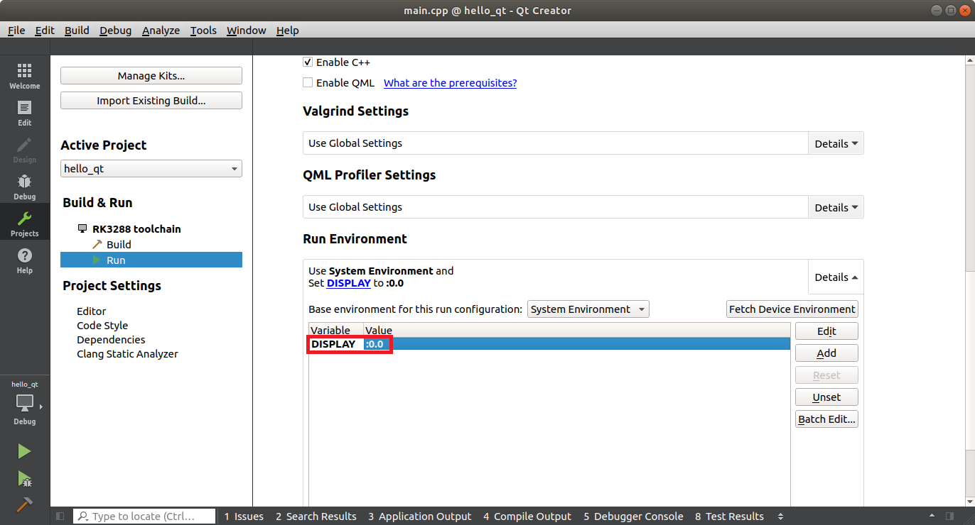

  4. Set environment variable DISPLAY in QtCreator -> Projects -> Run -> Run Environment. The value of DISPLAY is obtained from the rk3288. For example, execute instruction echo $DISPLAY on RK3288.
  5. Switch to "Edit" mode

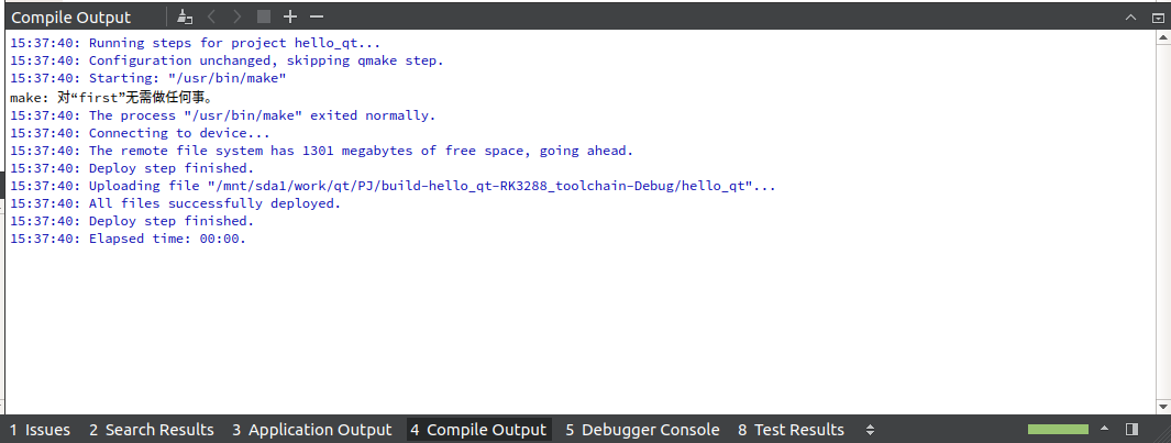

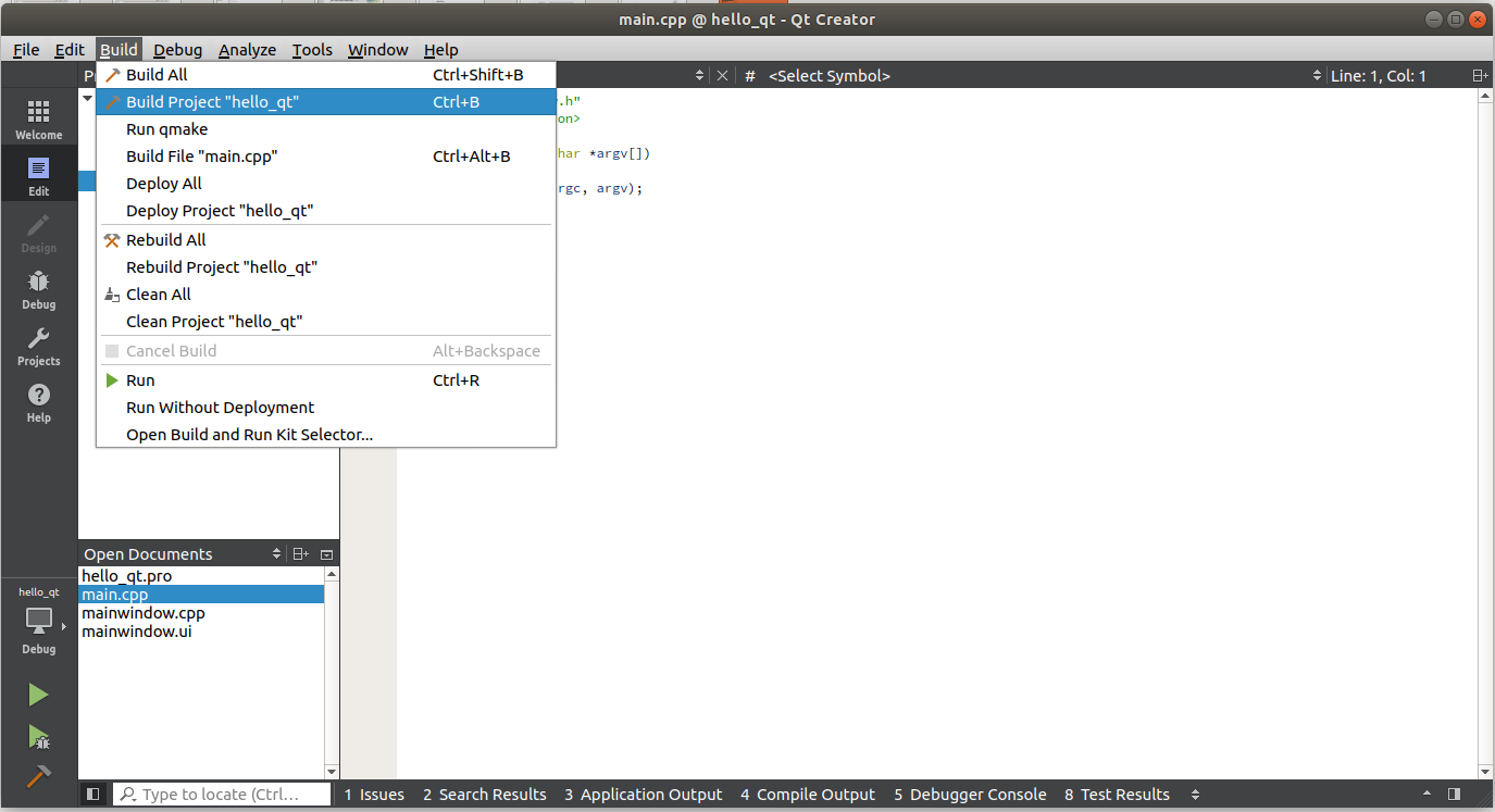

  6. Click "Build" using context menu of project "Hello"
  7. The green "Build" bar means no error occured.
  8. Press "Alt+4" to show "Compile Output".
Deploying the Application​
  1. Click "Deploy" using context menu of project hello_qt
  2. The green "Deploy" bar indicates no error occured.

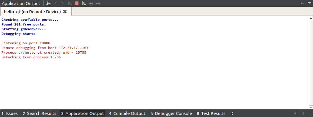

  2. Press "Alt+3" to show "Application Output"
  3. The "hello_qt" shows up on primary display.
