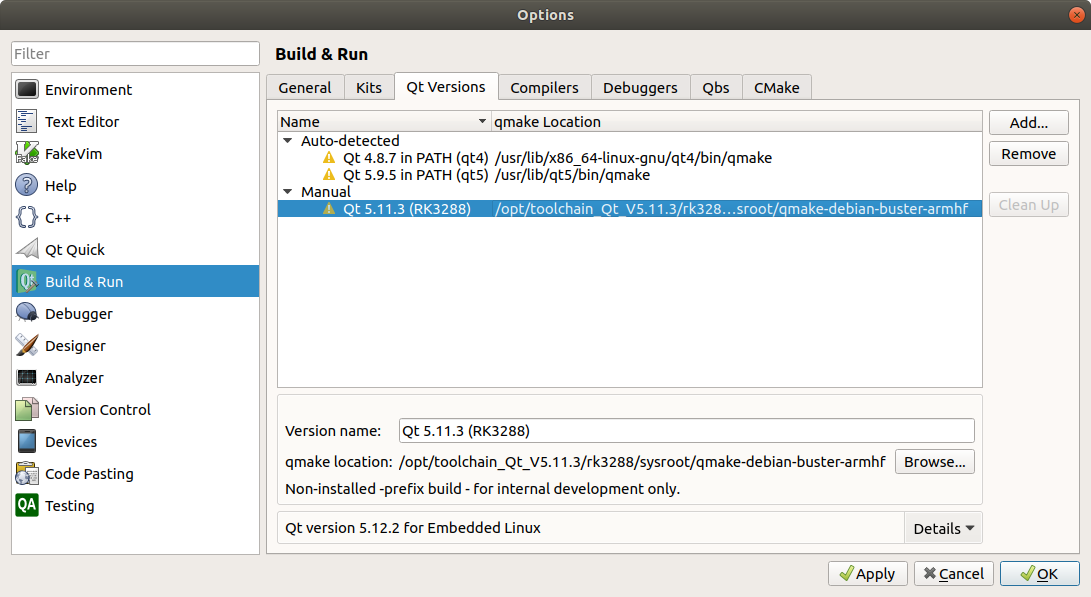

Config QtCreator ---- Qt Versions
  1. Bring up the options dialog using "Tools" -> "Options..."
  2. Select the "Build & Run" page on the left, switch to "Qt Versions" tab, and click "Add..."
  3. Select qmake file Select "/opt/toolchain_Qt_V5.11.3/rk3288/sysroot/qmake-debian-buster-armhf". or RK3399 Select "/opt/toolchain_Qt_V5.11.3/rk3399/sysroot/qmake". or RK3399 Select "/opt/toolchain_Qt_V5.11.3/rk3399/sysroot/qmake-debian-buster-armhf "
  4. Input Version name "Qt 5.11.3 (RK3288 )" or "Qt 5.11.3 (RK3399 )".

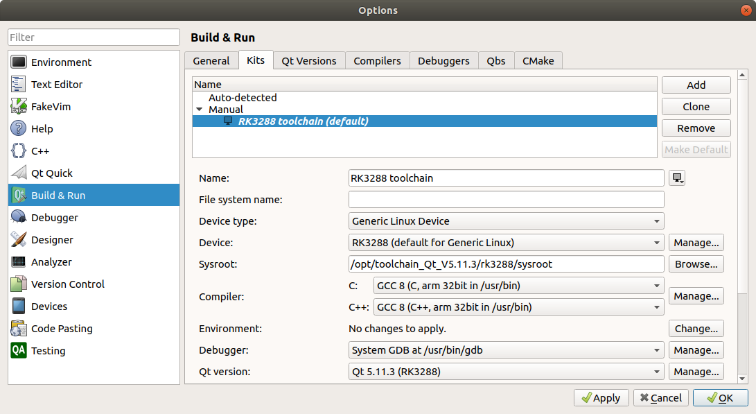

Config QtCreator ---- Kits
  2. Select the "Build & Run" page on the left, switch to "Kits" tab, and click "Add..."
  3. Click "Add".
RK3288 Name input "RK3288 toolchain" Device Tpye Select "Generic Linux Device" Device Select "RK3288" Compiler Select "GCC (C,arm 32bit in /usr/bin)" and "GCC (C++,arm 32bit in /usr/bin)" Qt version Select "Qt 5.11.3 (RK3288)"
RK3399
Name input "RK3399 toolchain" Device Tpye Select "Generic Linux Device" Device Select "RK3399" Compiler Select "GCC (C,arm 64bit in /usr/bin)" and "GCC (C++,arm 64bit in /usr/bin)" Qt version Select "Qt 5.11.3 (RK3399)"
