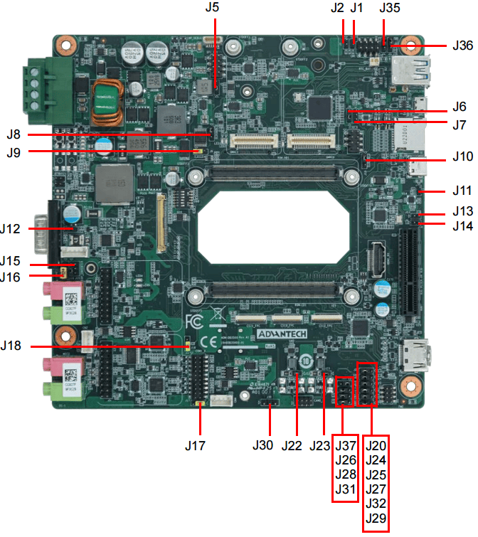

Jumper Locations​

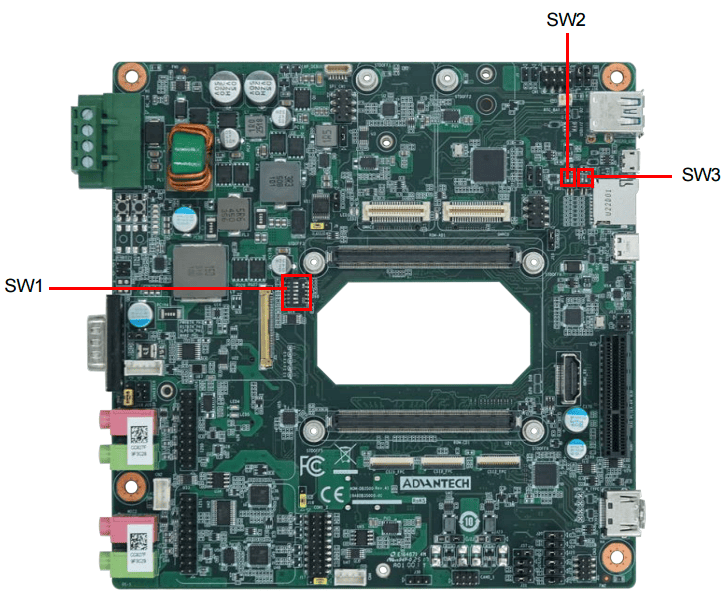

Switch Locations​
Button Locations​
LableFunctionLableFunctiion
PWR BTNPower ButtonJ8M2_E1 Power Select
RST BTNReset ButtonJ10M.2_B Power Selsct
SW1BOOT SELECT SwitchJ9UART1 to M2_E2 or M2_E1 Connector Select
SW2USB0 PWE_EN Select SwitchJ2AT/ATX Select Header
SW3USB0 OC# Select SwitchJ37GPIO4_Z_G Selection
J12EDP0/LVDS0/DSI Hot-Plug   Detect Selection HeaderJ26GPIO0_Z_G Selection
J15EDP VDD Power SelectJ28GPIO0 Selection
J16EDP Backlight Power SelectJ31GPIO4 Selection
J17Header For SD1 SelectionJ20GPIO7 Selection
J18Header For SD1_CD# SelecttionJ24GPIO7A Selection
J30Header For  EDP0_BKLT_EN and EDP0_BKLT_PWMJ25GPIO1 Selection
J22CAN0 BUS Terminal ResistorJ27GPIO1_Z_G Selection
J23CAN1 BUS Terminal ResistorJ29GPIO6 Selection
J14Header For WDT_OUT#  Link SelectionJ32GPIO5 Selection
J13Header For WDT_OUT# SelectionJ1SD0_WP Select Header
J11TYPEC_OTG_ID Selection HeaderJ5SPI1_CS#  Select Header
J6SPI0_CS#  Select HeaderJ7USB3 2.0 OTG and Host Select  Header
J35U7 mode SelectJ36U58 mode Select
