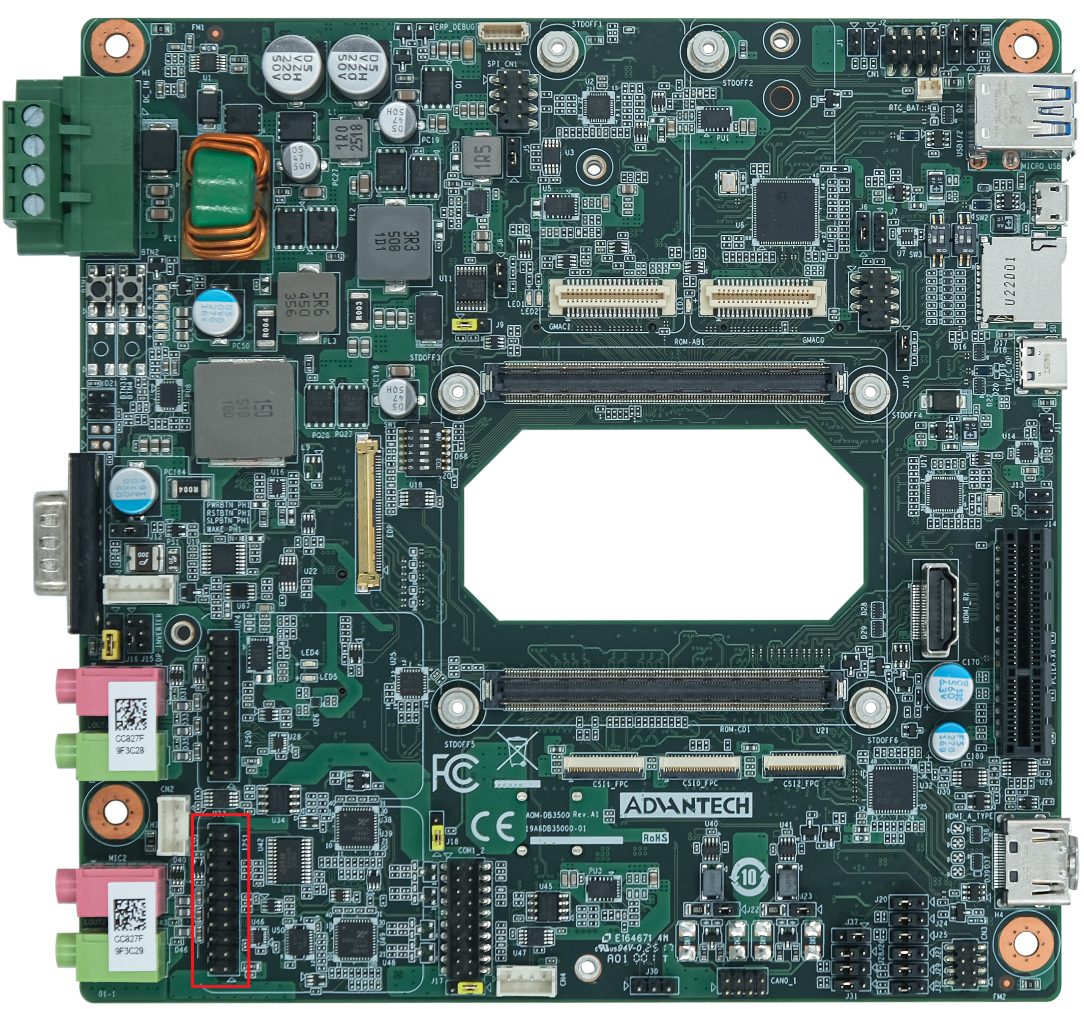

AUDIO MIC1/OUT1(Compatible with ROM-EG57)

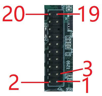

HW Pin Header
I2S0 Connector Pin Definition
Pin
1
2
3
4
5
6
7
8
9
10
11
12
13
14
15
16
17
18
19
20

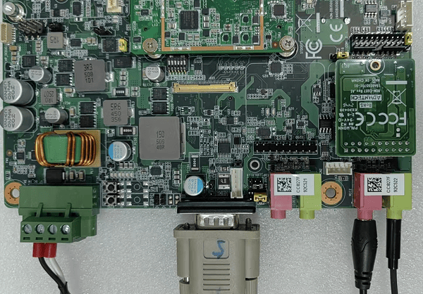

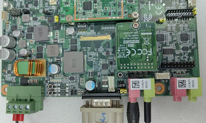

Record Take Card ID 1 for example:
# arecord -Dplughw:1,0 -f S16_LE -r 16000 -d 10 -t wav test.wav
Playback Take Card ID 1 for example:
# aplay -Dplughw:1,0 -t wav test.wav
