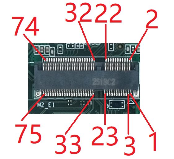

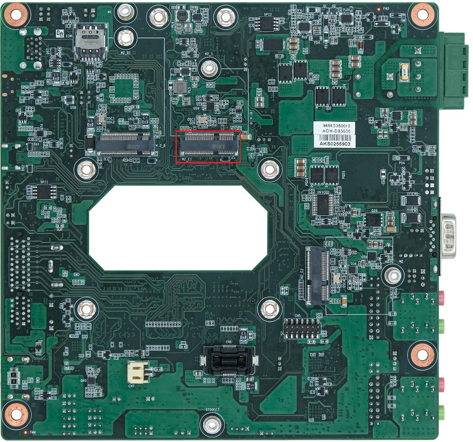

M2_E1 Key Pin define
M2_E1 M2_E1 Connector Pin Definition
Pin
1
2
3
4
5
6
7
8
9
10
11
12
13
14
15
16
17
18
19
20
21
22
23
24-31
32
33
34
35
36
37
38
39
40
41
42
43
44
45
46
47
48
49
50
51
52
53
54
55
56
57
58
59
60
61
62
63
64
65
66
67
68
69
70
71
72
73
74
75

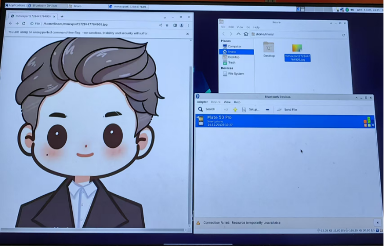

BT(For example:“Mate 50 Pro”)
Step1 :Click “Applications” -> “Settings”-> “Bluetooth manager”. Click the “Search” button to search for Bluetooth devices.
Step2 :Right-click to select a device, such as “Mate 50 Pro”, and Connect Bluetooth.
Step3 :AOM-3821 will start sending files when the receiver device, such as “Mate 50 Pro ”, confirms bluetooth reception.
Step4:View the location and information of the sent file.
