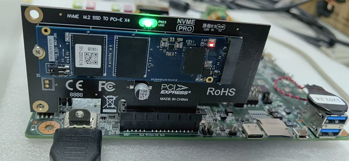

AOM-DB3500 PCIE X4
Insert NVMe SSD
NVMe (SQF-C8BV2-128G-EDE) UGREEN KB-SA0093-A1 + JZ-SSD256G-5NVMe (SQF-C8BV2-128G-EDE) UGREEN KB-SA0093-A1 + JZ-SSD256G-5
Note!
  1. Make sure the device is power off before insert PCIE disk, otherwise the device and/or PCIE disk may be damaged. 2. Make sure PCIE disk is partitioned and formatted.
