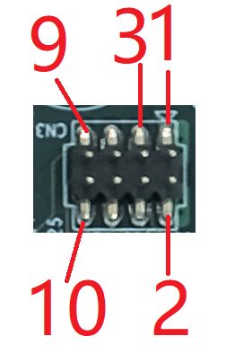

AOM-DB3500 GPIO CN3

AOM-DB3500 GPIO Connector
CN3_GPIO Connector Pin Definition
Pin
1
2
3
4
5
6
7
8
9
10
