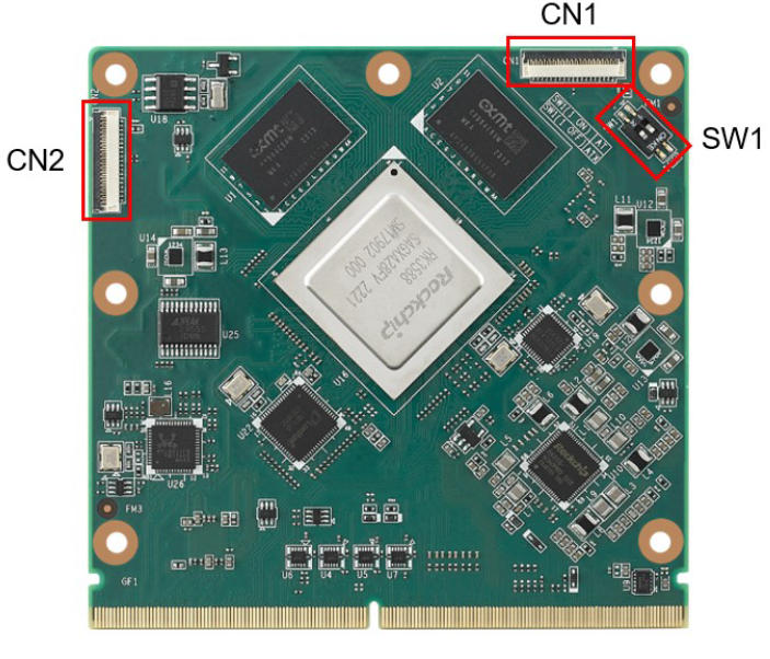

ROM-6881接口佈局图 Board Dimension Layout​
SOM-DB2510 A1 Board Dimension Layout​
The figures below indicate the main chips on SOM-DB2510 Development Board for  SMARC 2.1.

ROM-6881 Switch Settings
  • SW1 (AT & ATX Mode Switch)

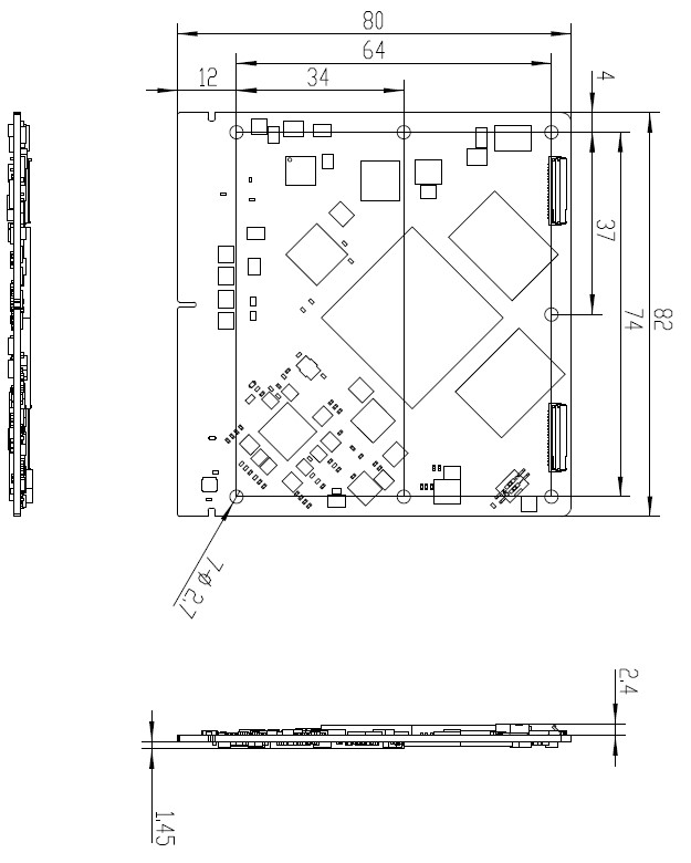

ROM-6881 機械尺寸(Mechanical Characteristics)​
  • Dimension: SMARC form factor size: (D x W) 82 x 80 mm / 3.22 x 3.15 inch
  • Height on Top: 2.4 mm
  • Height on Bottom: 1.45 mm
SOM-DB2510_A1 机械尺寸 ( Mechanical Characteristics)​
For more details regarding our 2D/3D models, please visit the Advantech COM support  service website at: http://com.advantech.com .
Board Mechanical Diagram -Front​
Board Mechanical Diagram -Side1
Board Mechanical Diagram -Side2

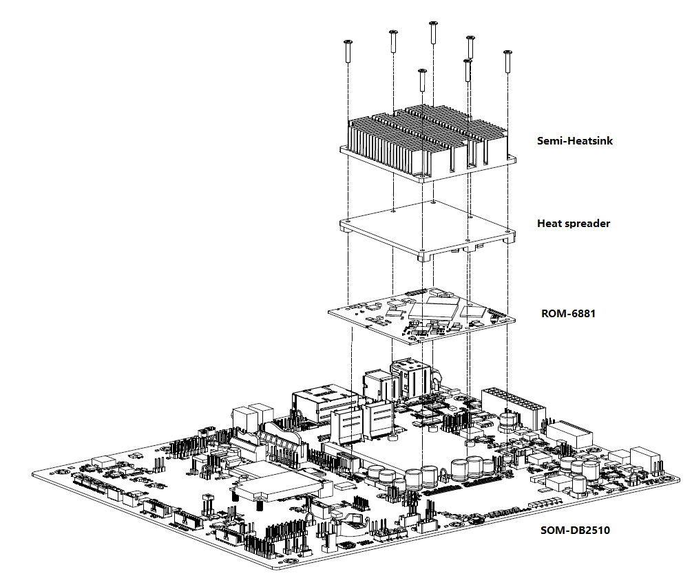

Assemblly Diagram​
These figures demonstrate the order of assembly needed when attaching the thermal  module and COM module to the carrier board.
