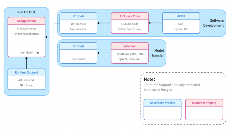

AI Program Development​
AI Program Development for Rockchip platform mainly has two stages:
  • AI Model Transfer.
  • Program Development.
We provide PC tools (rknn-toolkit2) to do "AI Model Transfer" and provide "AI API (rknpu2)" and "Qt/Gcc toolchain" to develop AI applications.
Gcc toolchain can be gotton from released image.
Qt toolchain can be gotton from .
To get more details about RKNN C API from "rknpu2/doc/Rockchip_RKNPU_UserGuide_RKNN_API_V*.ptf"
To get more details about RKNN Python API from "rknn-toolkit2/rknn_toolkit_lite2/docs/Rockchip_UserGuide_RKNN_Toolkit_Lite2_V*.ptf"

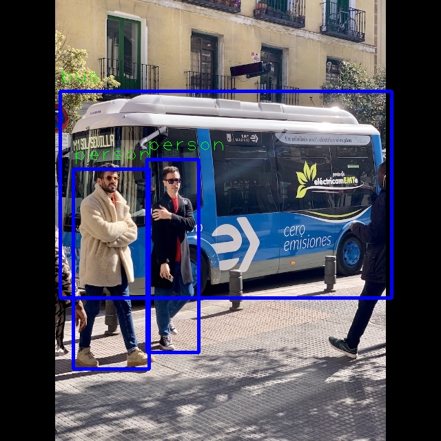

rknn_ssd_demo​
cd /tools/test/adv/npu2/rknn_ssd_demo
./rknn_ssd_demo model/ssd_inception_v2.rknn model/bus.jpg
resize 640 640 to 300 300
Loading model ...
rknn_init ...
model input num: 1, output num: 2
input tensors:
index=0, name=Preprocessor/sub:0, n_dims=4, dims=[1, 300, 300, 3], n_elems=270000, size=270000, fmt=NHWC, type=INT8, qnt_type=AFFINE, zp=0, scale=0.007843
output tensors:
index=0, name=concat:0, n_dims=4, dims=[1, 1917, 1, 4], n_elems=7668, size=7668, fmt=NCHW, type=INT8, qnt_type=AFFINE, zp=50, scale=0.090787
index=1, name=concat_1:0, n_dims=4, dims=[1, 1917, 91, 1], n_elems=174447, size=174447, fmt=NCHW, type=INT8, qnt_type=AFFINE, zp=58, scale=0.140090
rknn_run
loadLabelName
ssd - loadLabelName ./model/coco_labels_list.txt
loadBoxPriors
person @ (106 245 216 535) 0.994422
bus @ (87 132 568 432) 0.991533
person @ (213 231 288 511) 0.843047
