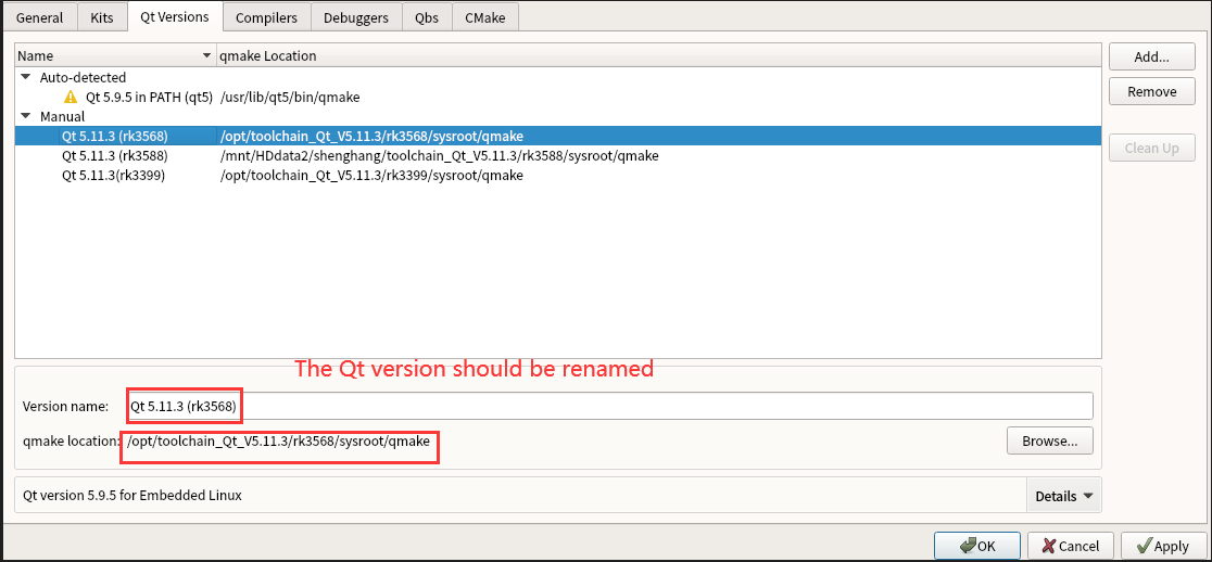

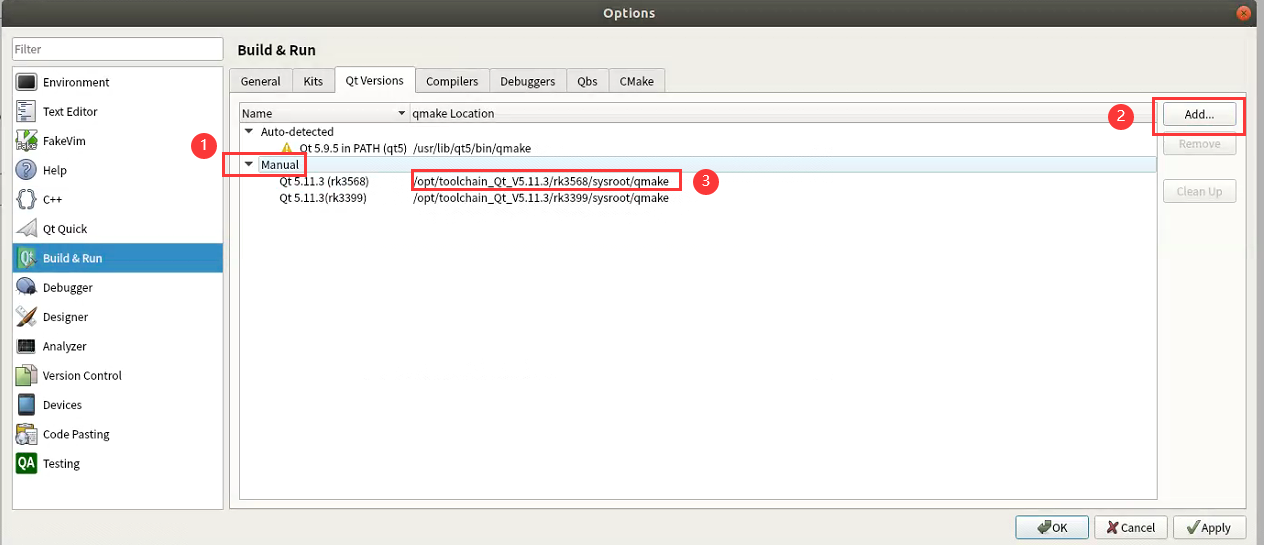

Config QtCreator ---- Qt Versions​

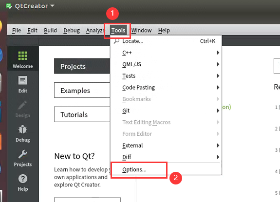

  1. Select Tools --> options -->
  1. Select Qt versions --> Manual -->Add -->
Path:/opt/toolchain_Qt_V5.11.3/ RK3568 or RK3399 or RK3288 /sysroot/qmake
Path:/opt/toolchain_Qt_V5.15.2/ RK3588 /sysroot/qmake

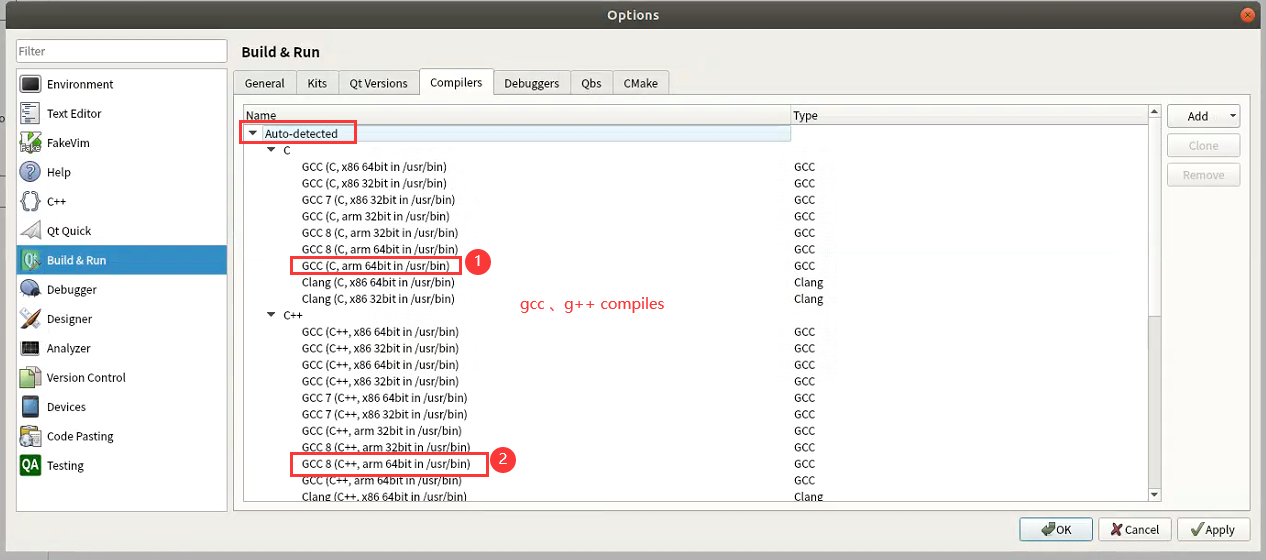

Config QtCreator ---- Qt Complers​
  1. Select compilers -->
  2. Because Gcc and G++ has been installed earlier, the compiler will generally detect it automatically.
If no Auto-detected, just Add it.
' Path for' RK3588 (64) :/usr/bin/arrch64-linux-gnu-gcc
/usr/bin/aarch64-linux-gnu-g++
' Path for' RK3568 (64) :/usr/bin/arrch64-linux-gnu-gcc
' Path for' RK3399 (64) :/usr/bin/aarch64-linux-gnu-gcc
' Path for' RK3288(32) :/usr/bin/arm-linux-gnueabihf-gcc
/usr/bin/arm-linux-gnueabihf-g++
The following figure uses rk3568  as an example :

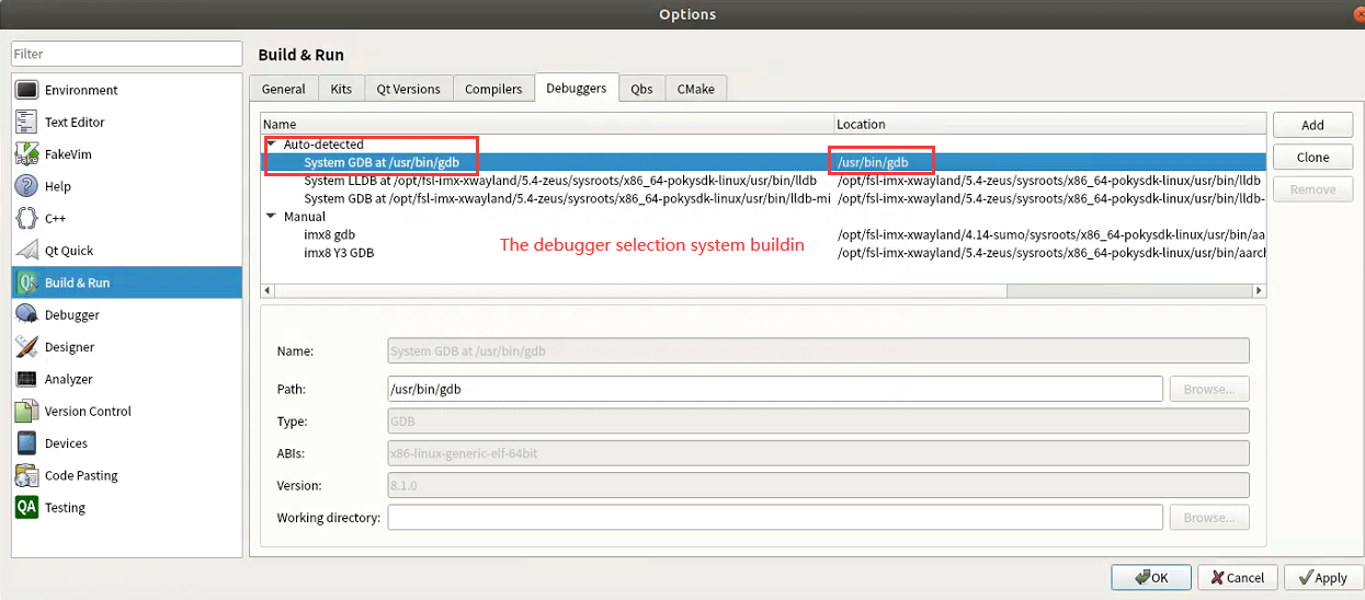

Config QtCreator ---- Qt Debuggers​
  1. Select Debuggers -->
  2. The Debuggers selection system buildin,If no Auto-detected , just Add it:
Path: /usr/bin/gdb

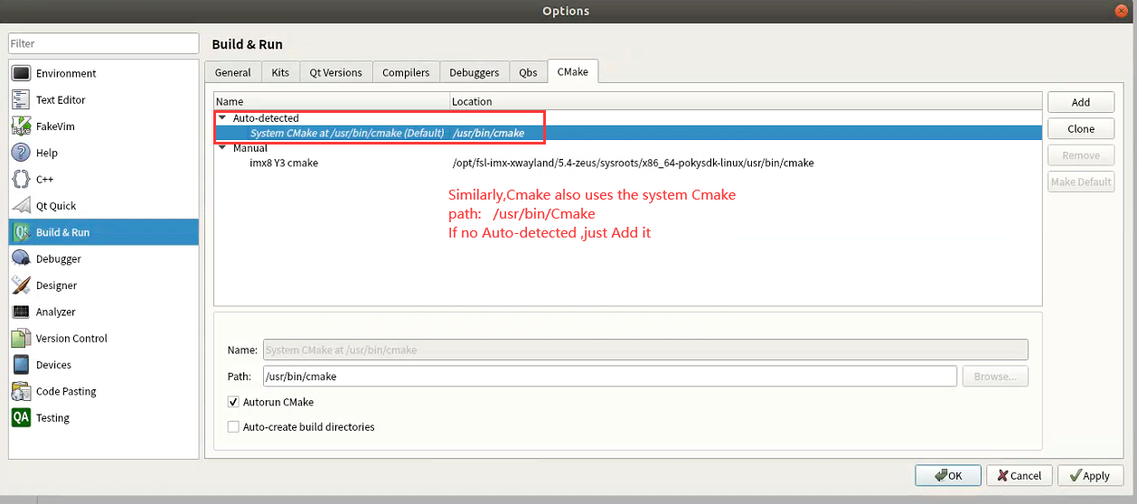

Config QtCreator ---- Qt Cmakes​
  1. Select Cmake -->
  2. Similarly,Cmake also uses the system Cmake , if no Auto-detected , just Add it :
Path: /usr/bin/Cmake

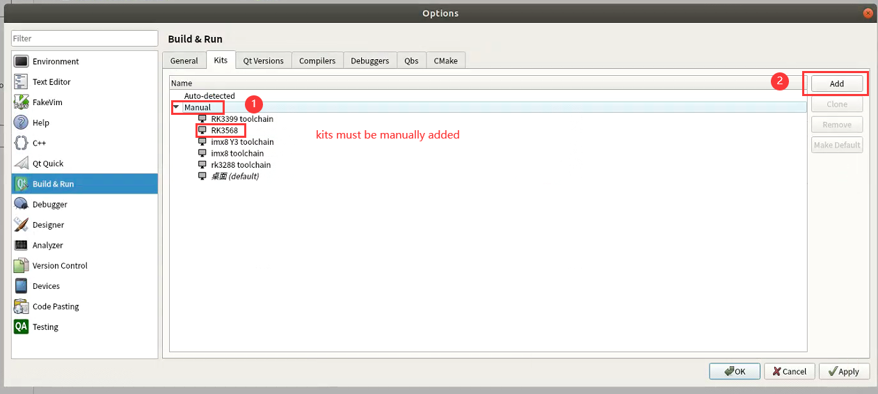

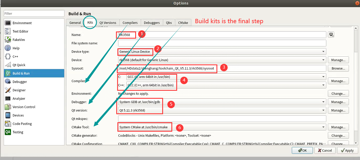

Config QtCreator ---- Qt kits​
  1. Select Kits
  2. Configure "Qt version"、"Compilers"、"Debuggers" and "Cmake" configurations in Kits.
The picture below uses rk3568 as an example:

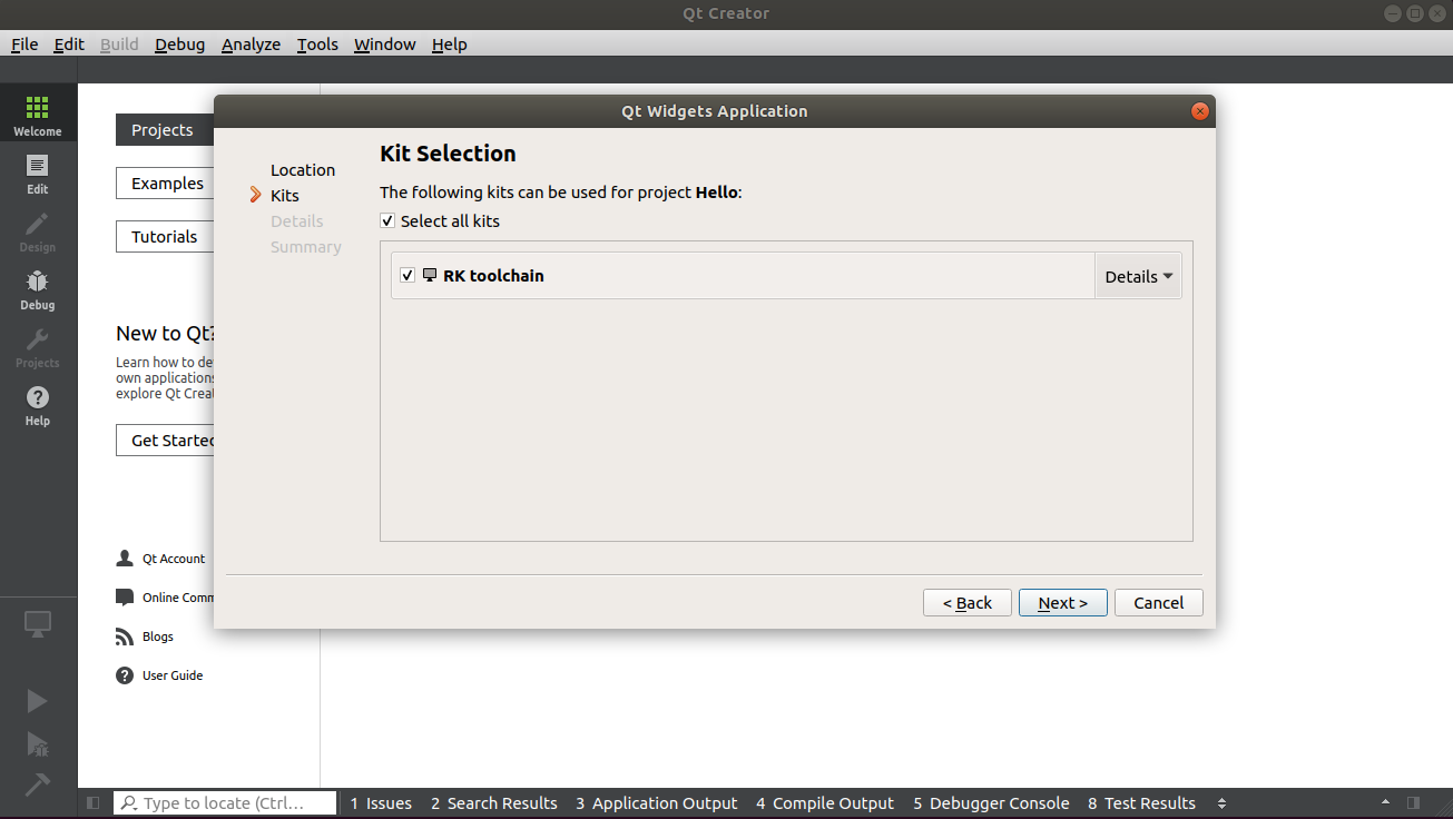

Creating the Project​

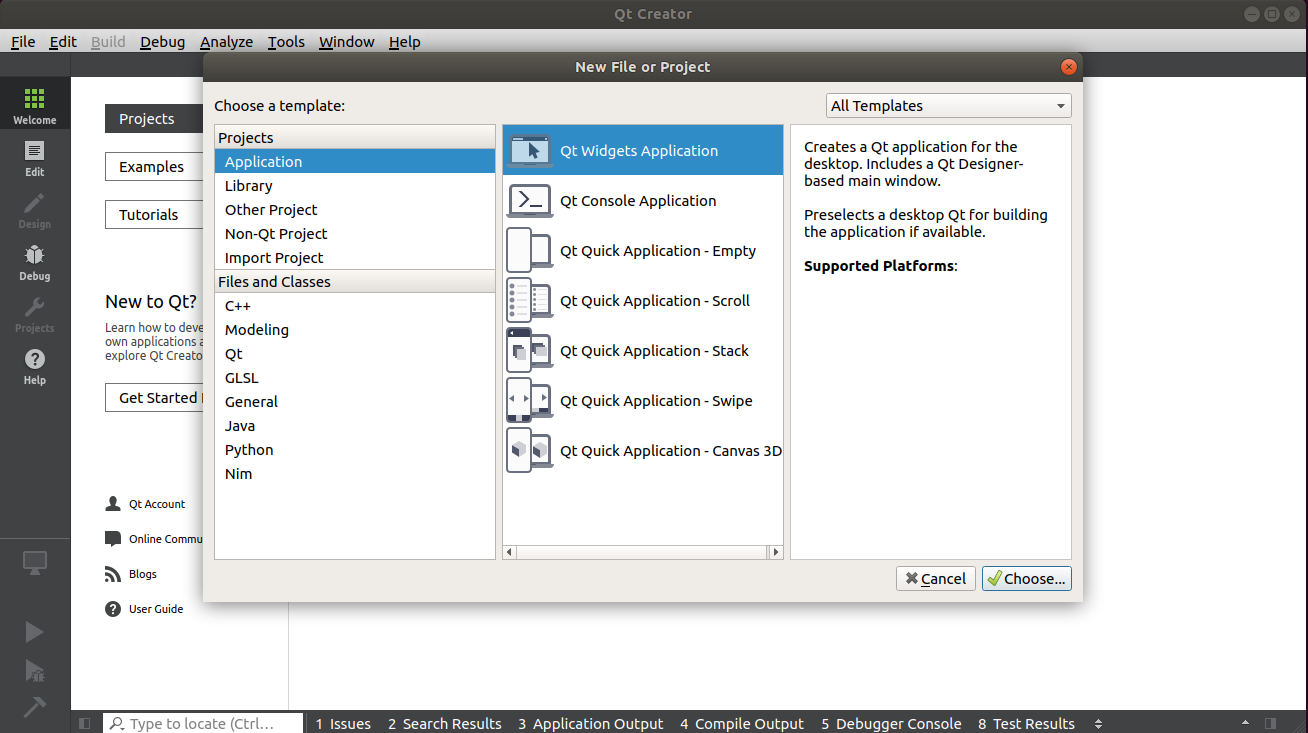

  1. Bring up "New" dailog using "File" -> "New File or Project..."
  2. Select "Applications" -> 'Qt Widgets Application"
  3. Click "Choose..."

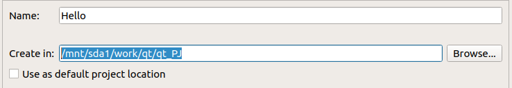

  4. Use "Hello" as name
  5. Create in "/mnt/sda1/work/qt/qt_PJ"
  6. Click "Next"
  7. Check "RK toolchain"
  8. Click "Next".

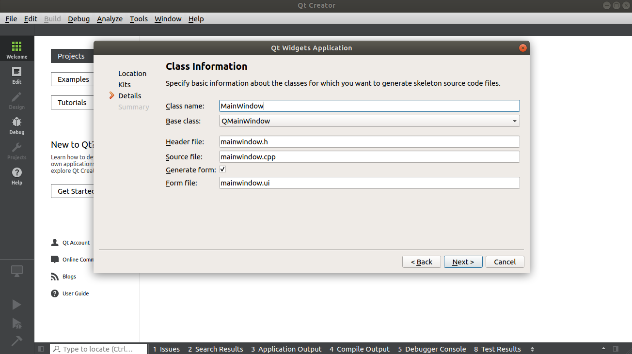

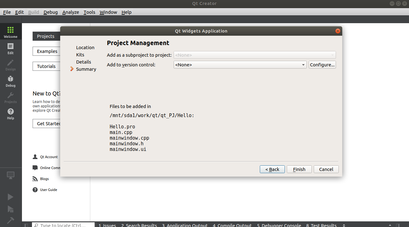

  9. Use default settings for "Class Information"
  10. Click "Next"
  11. Use default settings for "Project Management"
  12. Click "Finish"

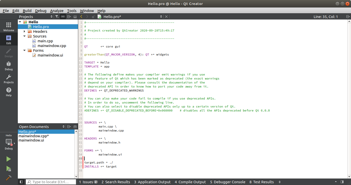

  13. Double click "Hello.pro" to switch to editor window
  14. In new project it is necessary to add following two lines into qt project file. target.path = .INSTALLS += target
  15. Press "Ctrl+S" to save file.

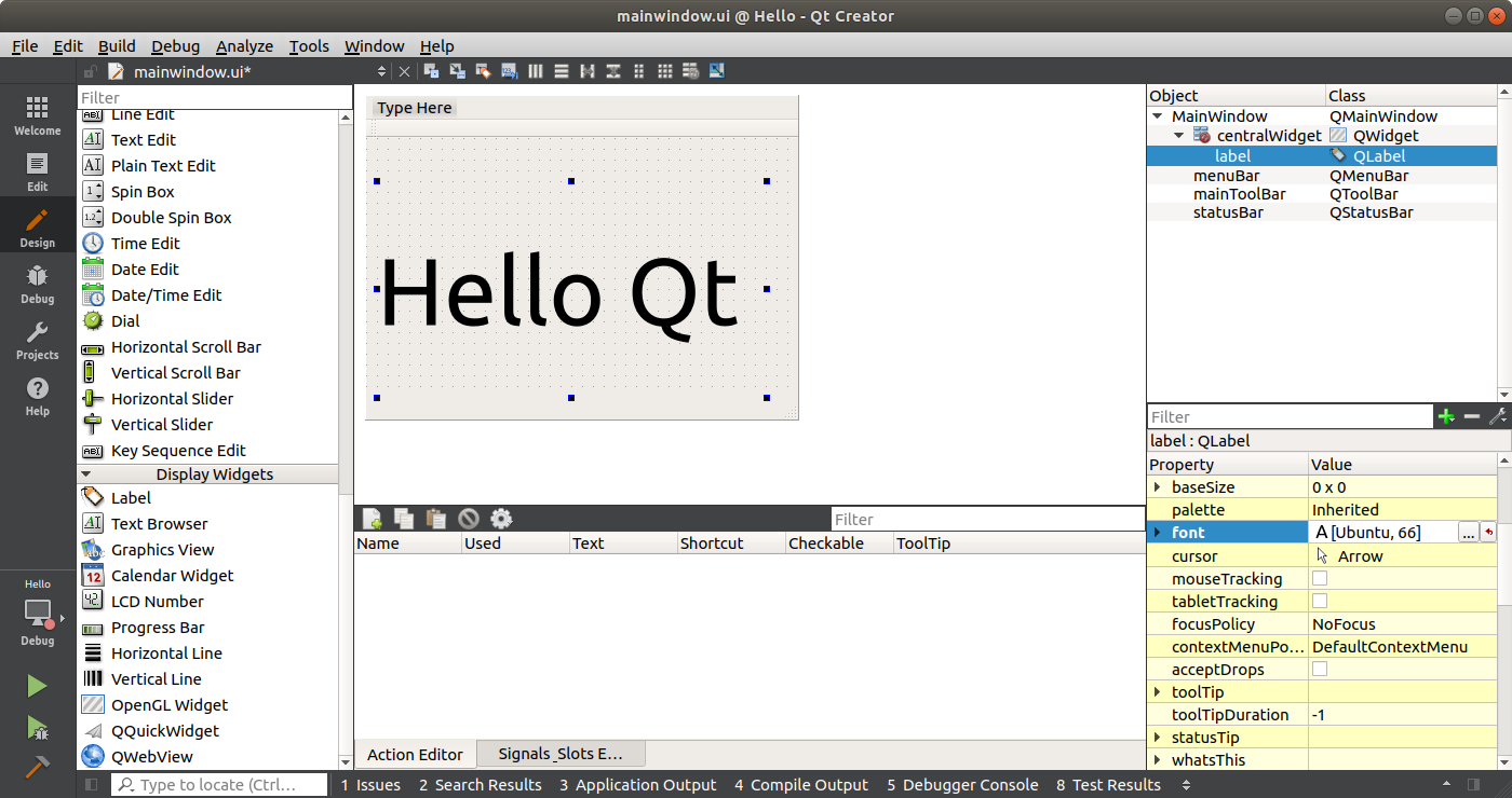

  16. Double click "mainwindow.ui" to switch to Design mode
  17. Drag & drop one Label widget on main form, use property editor on the right side to change text and font size

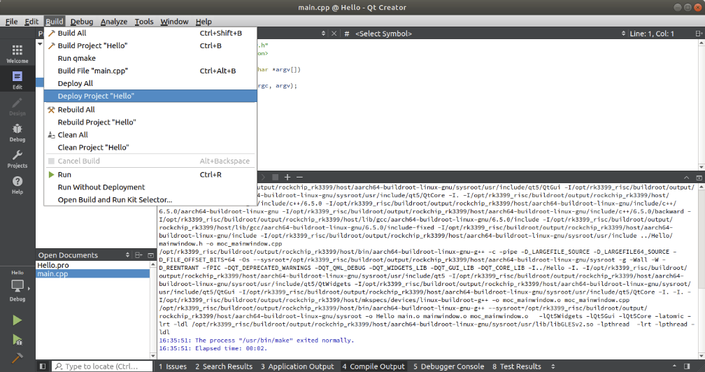

Building the Project​

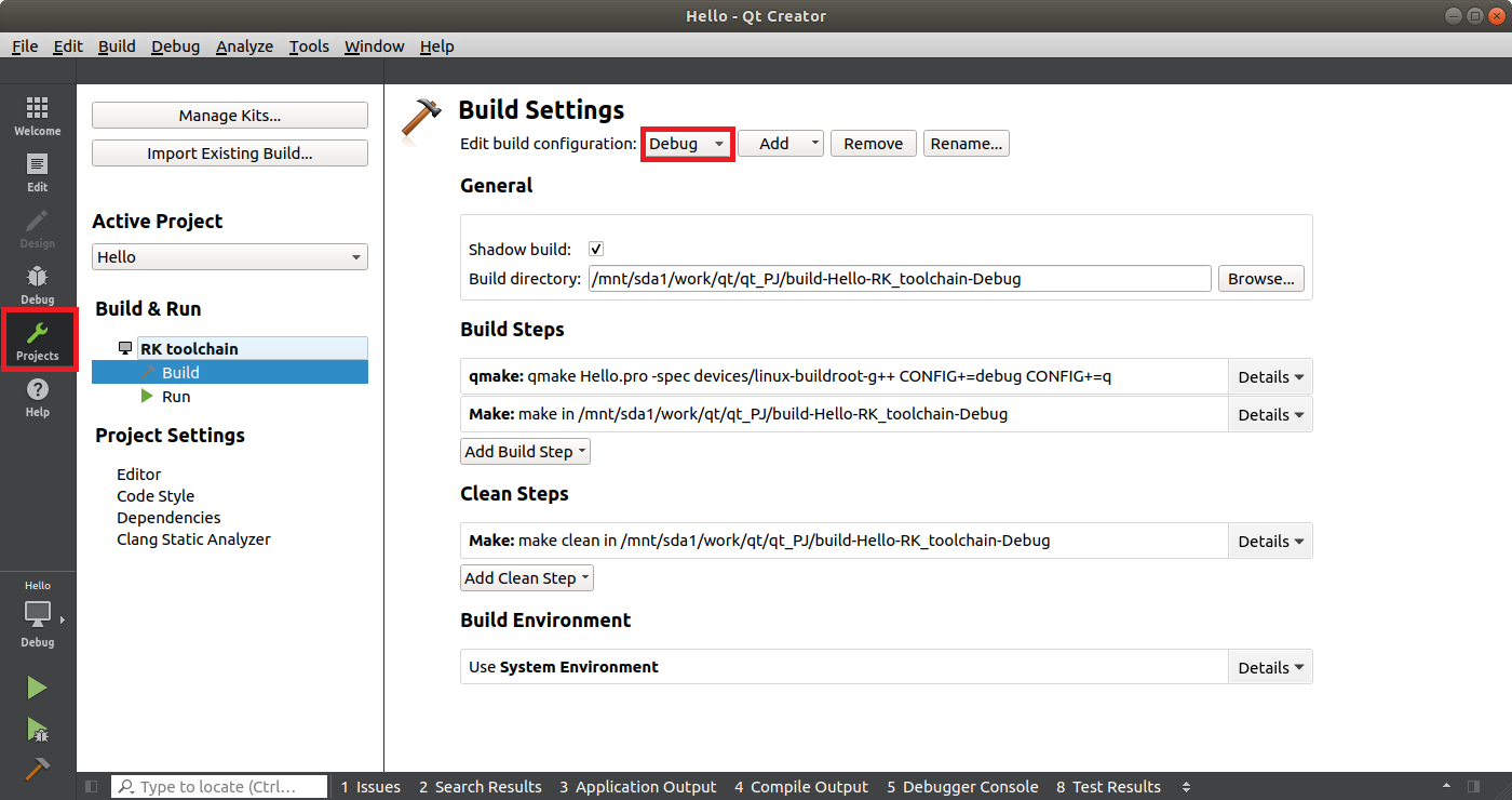

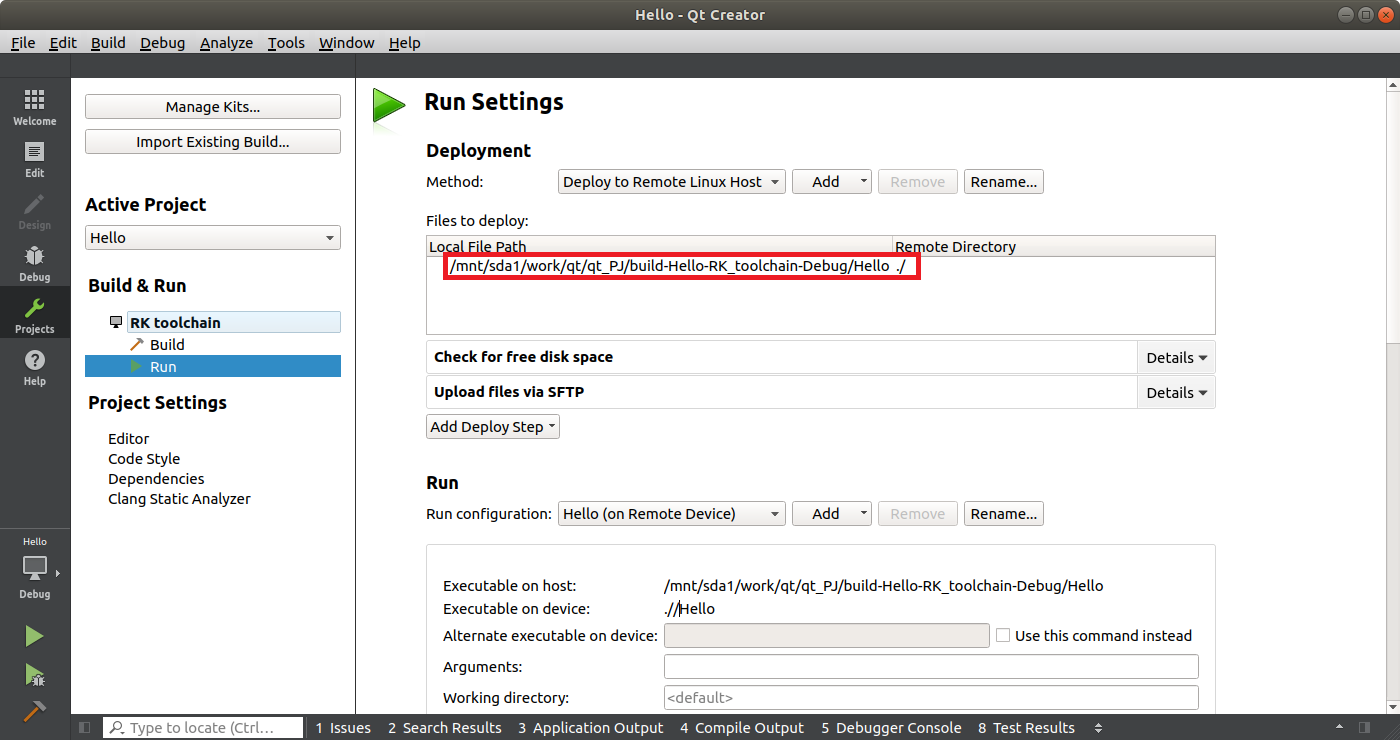

  1. Switch to "Projects" mode
  2. Check if "build configuration" is set to "Debug".
  3. Check if "Files to deploy" is correct

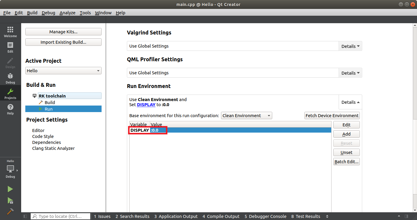

  4. Set environment variable DISPLAY in QtCreator -> Projects -> Run -> Run Environment. The value of DISPLAY is obtained from the rk3399. For example, execute instruction echo $DISPLAY on RK3399.

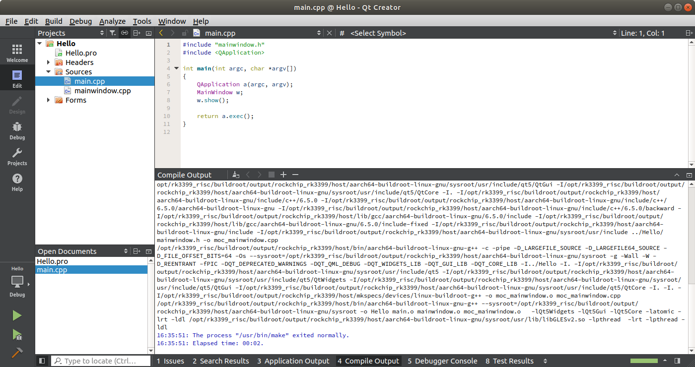

  5. Switch to "Edit" mode

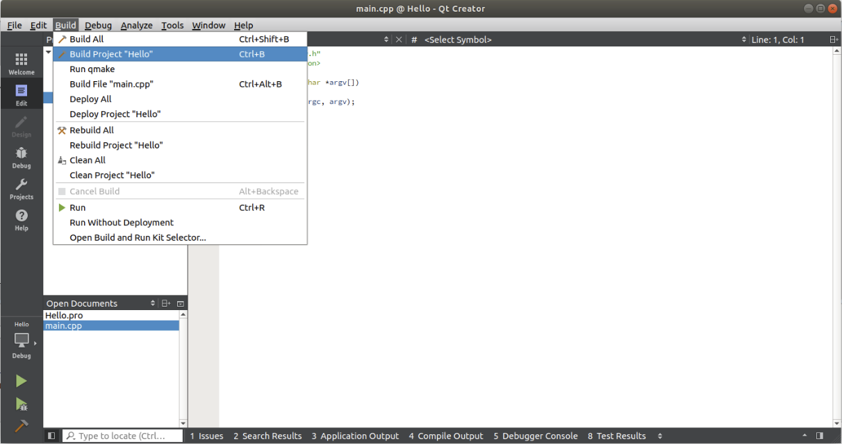

  6. Click "Build" using context menu of project "Hello"

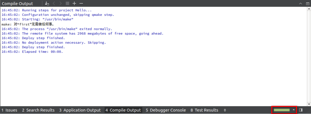

  7. The green "Build" bar means no error occured.
  8. Press "Alt+4" to show "Compile Output".
Deploying the Application​
  1. Click "Deploy" using context menu of project Hello
  2. The green "Deploy" bar indicates no error occured.

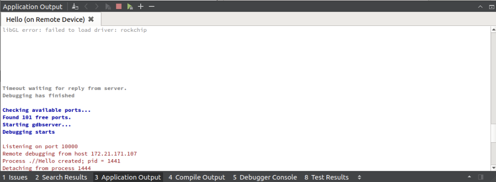

Debugging the Application​
  1. Click debug icon to start debugging.
  2. Press "Alt+3" to show "Application Output"
  3. The "Hello" shows up on primary display.

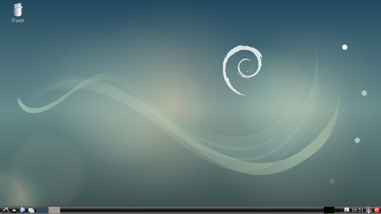

  4. Click "stop" to stop debugging.
  5. The default desktop returns back.
