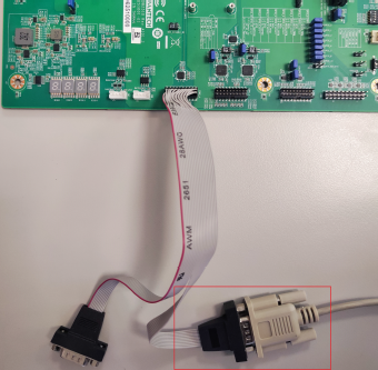

Hardware PIN define
  1. Connect debug port cable (1701200220) to COM2_4 on SOM-DB2510.
2. Connect it to your PC with USB to UART Cable.
ItemP/NPicture
Debug Port Cable1701200220

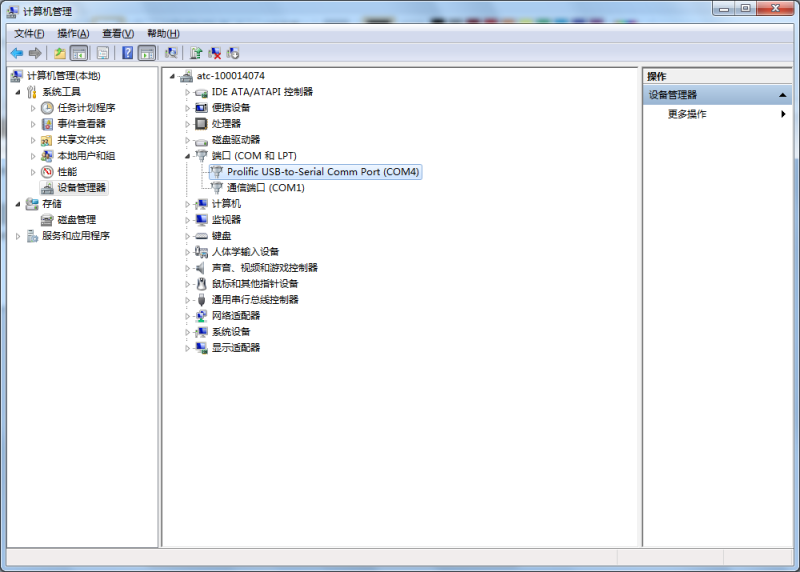

Install usb2uart adapter's driver. Connect adapter to PC , you will find COM port like :
![](../../../../bsp/rockchip/General/Debug/Serial Port/img/COM_Port_On_Windows.png)

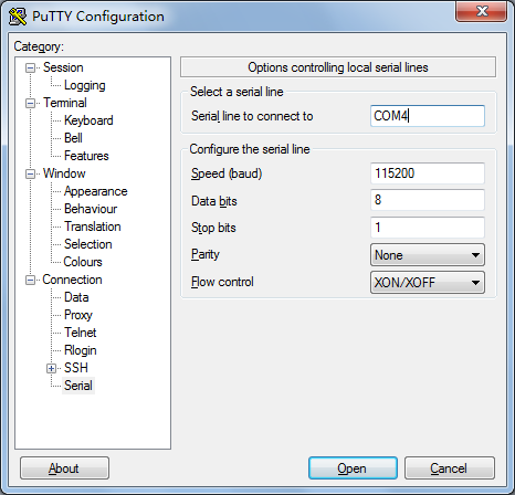

Putty is very populate tool on Windows. Download putty here.
Run PUTTY.exe, select Connection type of "Serial" , input COM port found in Device Manager.
Set Parameter like :
![](../../../../bsp/rockchip/General/Debug/Serial Port/img/Putty_COM_Configuration.png)
Then Click "Open" to start debug console.
