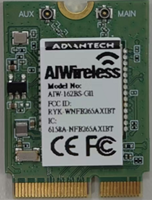

WIFI/BT
AOM-3841 supports AIW-162BS-GI1.(Broadcom AP6275P, - 40°C~85°C PCIE+UART)

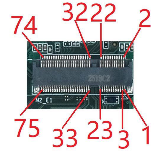

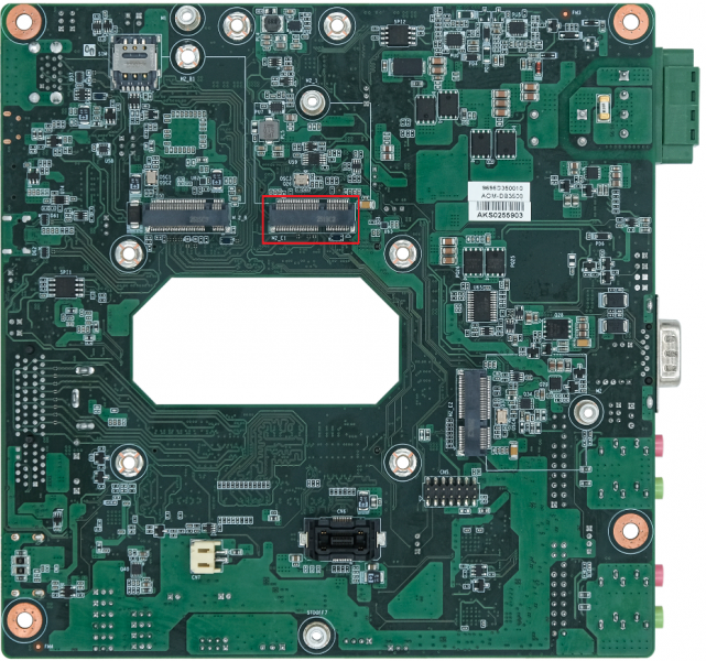

M2_E1 Key Pin define
M2_E1 M2_E1 Connector Pin Definition
Pin
1
2
3
4
5
6
7
8
9
10
11
12
13
14
15
16
17
18
19
20
21
22
23
24-31
32
33
34
35
36
37
38
39
40
41
42
43
44
45
46
47
48
49
50
51
52
53
54
55
56
57
58
59
60
61
62
63
64
65
66
67
68
69
70
71
72
73
74
75
J8 M2_E1 Power Setting
PinFunction
J8(1-2)M2_E1 power 3.3V (Default)
J8(2-3)M2_E1 power 3.8V
J9 M.2_B Power Setting
PinFunction
J9(1-2)(B2B pin B76-B79) to M2_E1 (Default)
J9(2-3)UART1 (B2B pin B76-B79) to M2_E2

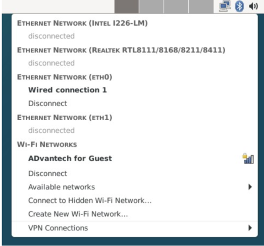

Configure WIFI

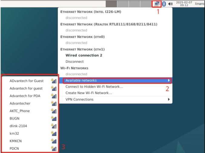

1、Click the network icon in the top right corner of the screen and click the line of “Available networks” to select a Wi-Fi connection (for example: Advantech for guest)

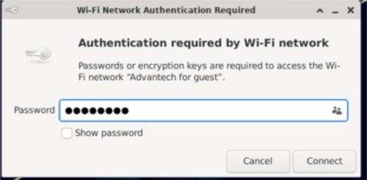

2、Enter the Wi-Fi password to connect to the device.
3、If the password is correct, the device will connect quickly.
After connection, Wi-Fi will create a net point “wlan0”.
# ping -I wlan0 www.advantech.com

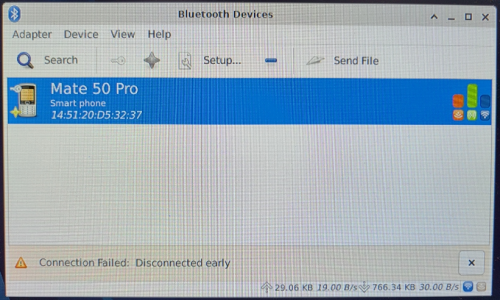

BT(For example:“Mate 50 Pro”)

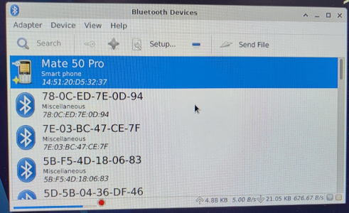

Step1:Click “Applications” -> “Settings”-> “Bluetooth manager”. Click the “Search” button to search for Bluetooth devices.

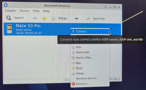

Step2:Right-click to select a device, such as “Mate 50 Pro”, and Connect Bluetooth.

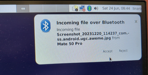

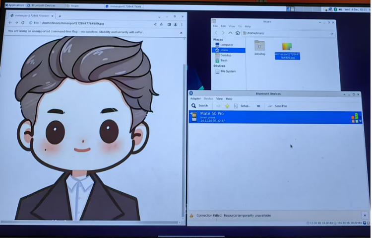

Step3:AOM-3821 will start sending files when the receiver device, such as “Mate 50 Pro”, confirms bluetooth reception.
Step4:View the location and information of the sent file.

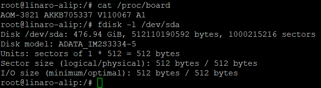

SATA(model:IM2S3334-512GCTB4
M.2_E-KEY PCIE TEST:
# fw_setenv combphy1 sata
# reboot
# fdisk -l /dev/sda
