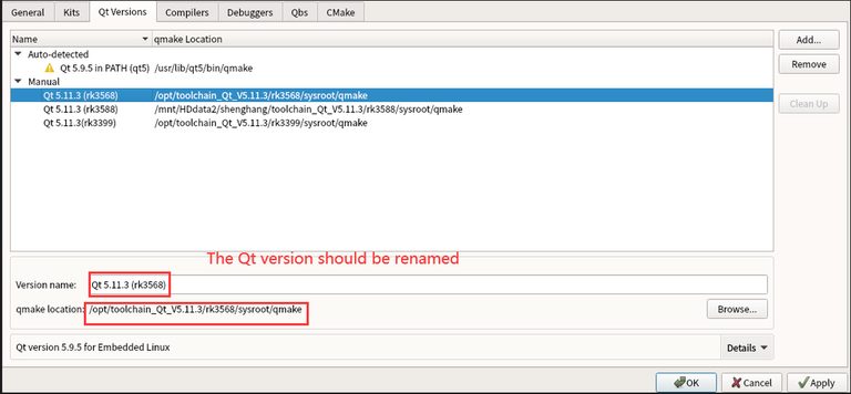

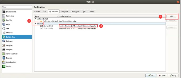

Config QtCreator ---- Qt Versions

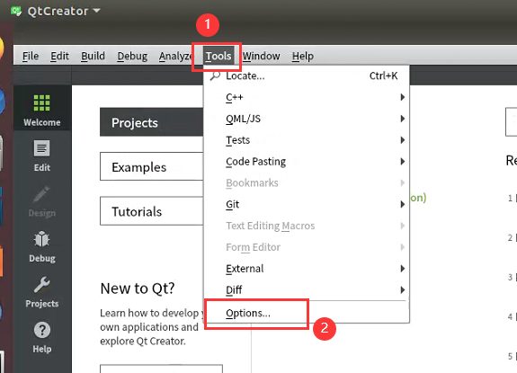

  1. Select Tools --> options -->
  1. Select Qt versions --> Manual -->Add -->
Path:/opt/toolchain_Qt_V5.11.3/ RK3568 or RK3399 or RK3288 /sysroot/qmake
Path:/opt/toolchain_Qt_V5.15.2/ RK3588 /sysroot/qmake

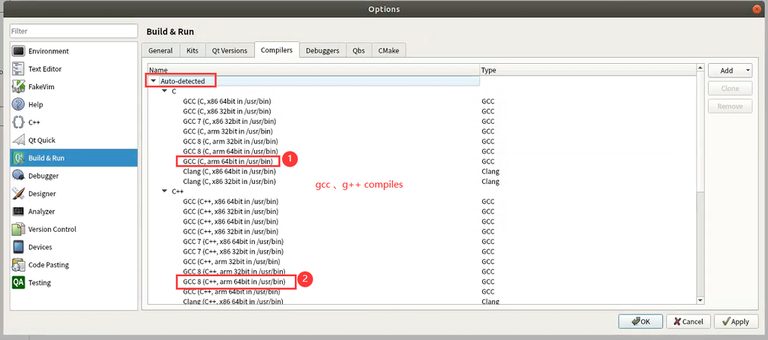

  1. Select compilers -->
  2. Because Gcc and G++ has been installed earlier, the compiler will generally detect it automatically.
If no Auto-detected, just Add it.
Path for RK3576 (64) :/usr/bin/arrch64-linux-gnu-gcc
/usr/bin/aarch64-linux-gnu-g++
Path for RK3588 (64) :/usr/bin/arrch64-linux-gnu-gcc
Path for RK3568 (64) :/usr/bin/arrch64-linux-gnu-gcc
Path for RK3399 (64) :/usr/bin/aarch64-linux-gnu-gcc
Path for RK3288(32) :/usr/bin/arm-linux-gnueabihf-gcc
/usr/bin/arm-linux-gnueabihf-g++
The following figure uses rk3568  as an example :

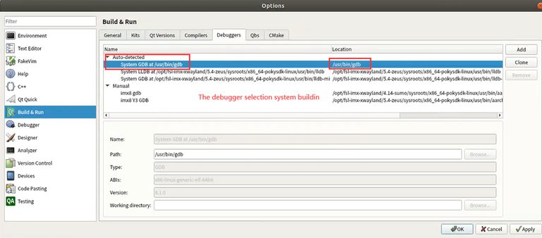

Config QtCreator ---- Qt Debuggers
  1. Select Debuggers -->
  2. The Debuggers selection system buildin,If no Auto-detected , just Add it:
Path: /usr/bin/gdb

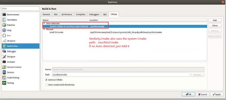

Config QtCreator ---- Qt Cmakes
  1. Select Cmake -->
  2. Similarly,Cmake also uses the system Cmake , if no Auto-detected , just Add it :
Path: /usr/bin/Cmake

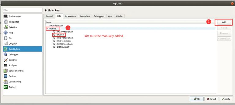

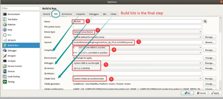

Config QtCreator ---- Qt kits
  1. Select Kits
  2. Configure "Qt version"、"Compilers"、"Debuggers" and "Cmake" configurations in Kits.
The picture below uses rk3568 as an example:

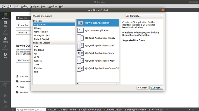

  1. Bring up "New" dailog using "File" -> "New File or Project..."
  2. Select "Applications" -> 'Qt Widgets Application"
  3. Click "Choose..."

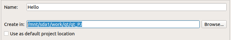

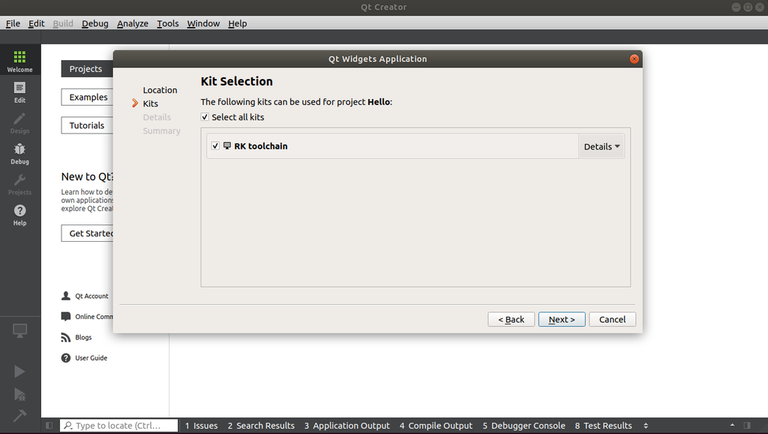

  4. Use "Hello" as name
  5. Create in "/mnt/sda1/work/qt/qt_PJ"
  6. Click "Next"
  7. Check "RK toolchain"
  8. Click "Next".

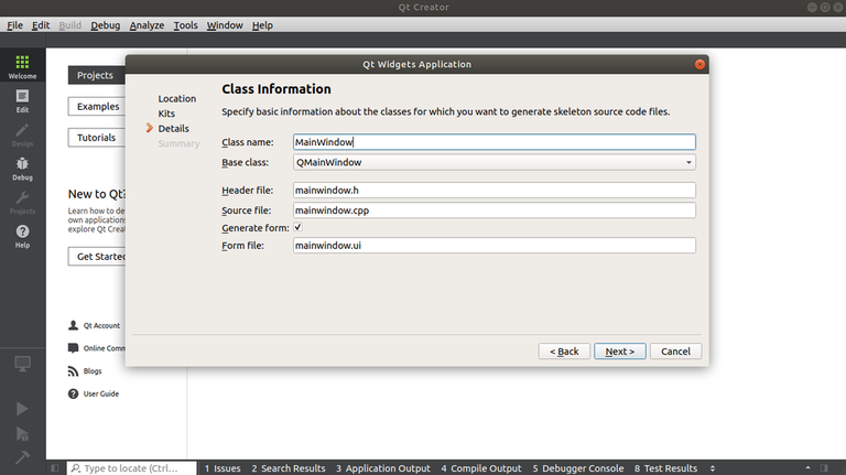

  9. Use default settings for "Class Information"
  10. Click "Next"

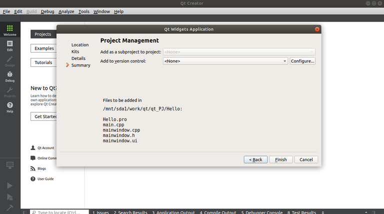

  11. Use default settings for "Project Management"
  12. Click "Finish"

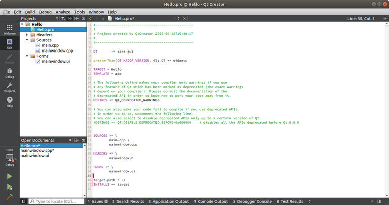

  13. Double click "Hello.pro" to switch to editor window
  14. In new project it is necessary to add following two lines into qt project file. target.path = .INSTALLS += target
  15. Press "Ctrl+S" to save file.

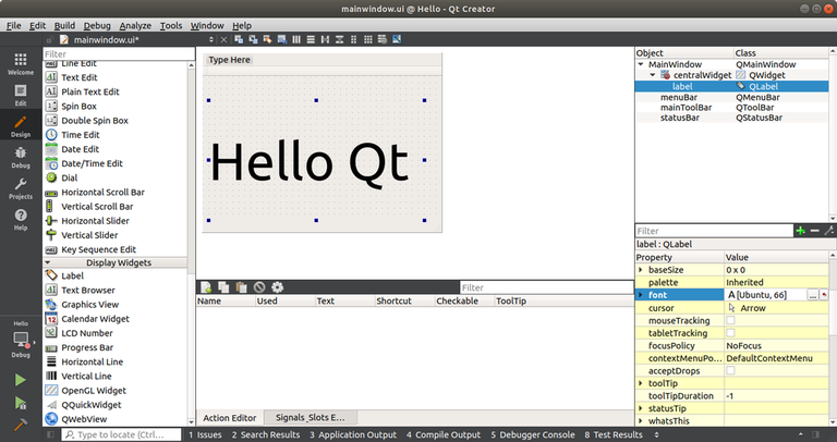

  16. Double click "mainwindow.ui" to switch to Design mode
  17. Drag & drop one Label widget on main form, use property editor on the right side to change text and font size
  18. Save all project files using "File" -> "Save All"

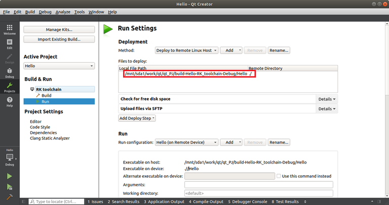

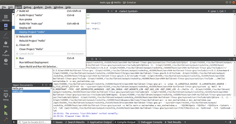

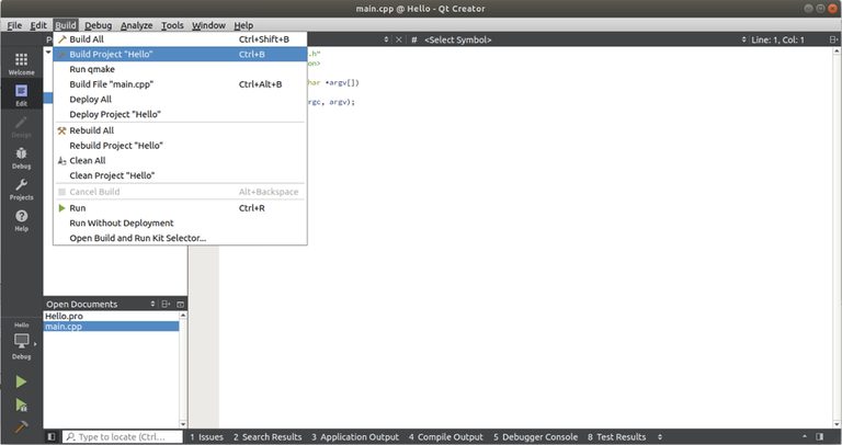

Building the Project

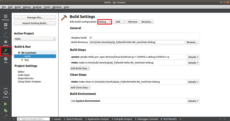

  1. Switch to "Projects" mode
  2. Check if "build configuration" is set to "Debug".
  3. Check if "Files to deploy" is correct

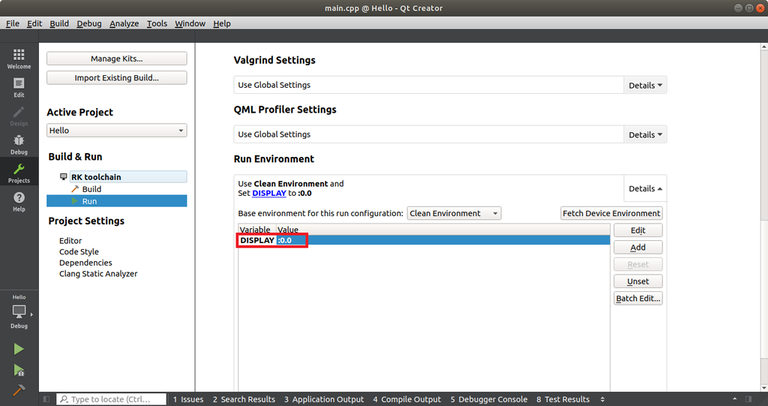

  4. Set environment variable DISPLAY in QtCreator -> Projects -> Run -> Run Environment. The value of DISPLAY is obtained from the rk3399. For example, execute instruction echo $DISPLAY on RK3399.

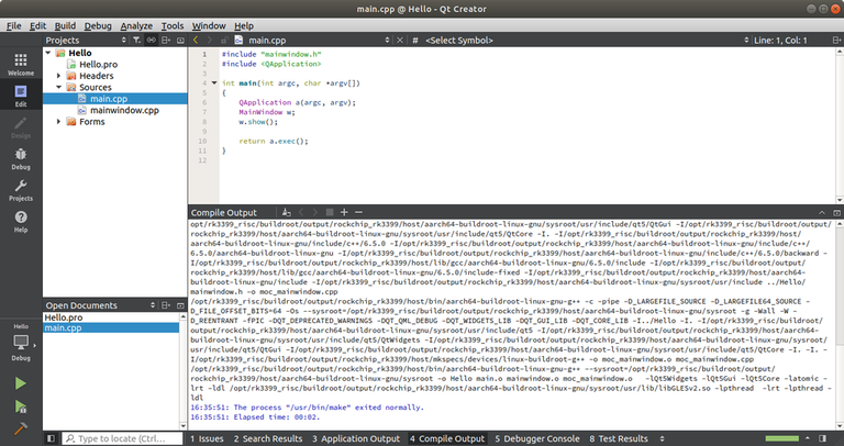

  5. Switch to "Edit" mode

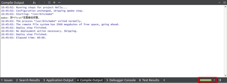

  6. Click "Build" using context menu of project "Hello"
  7. The green "Build" bar means no error occured.
  8. Press "Alt+4" to show "Compile Output".
Deploying the Application
  1. Click "Deploy" using context menu of project Hello
  2. The green "Deploy" bar indicates no error occured.

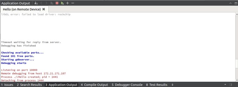

Debugging the Application
  1. Click debug icon to start debugging.
  2. Press "Alt+3" to show "Application Output"
  3. The "Hello" shows up on primary display.
  4. Click "stop" to stop debugging.

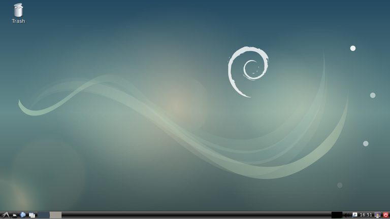

  5. The default desktop returns back.
