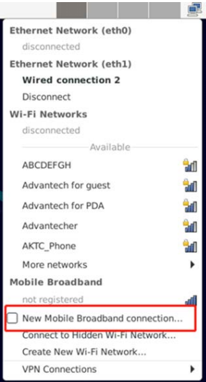

STEP 1: Power on the device, Click network connection icon then choose "New Mobile Broadband connection".

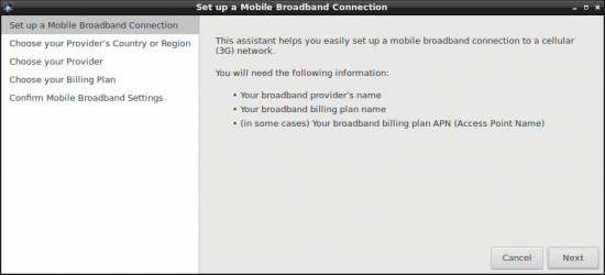

then you will see the following window, click "Next" button to the next step.

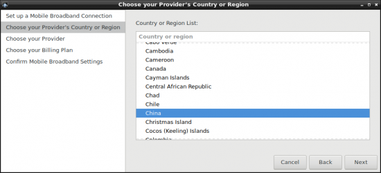

STEP 2 : Choose Provider's country or region of the SIM card you insert in STEP 0.

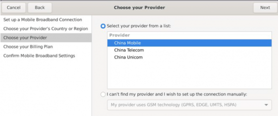

STEP 3 : Choose or Set the Provider's name.

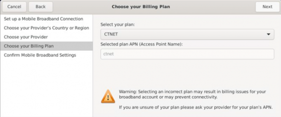

STEP 4 : Choose or Set APN.

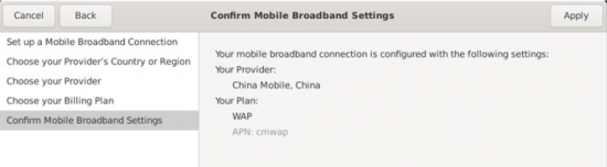

STEP 5 : Confirm your configuration and finish.
