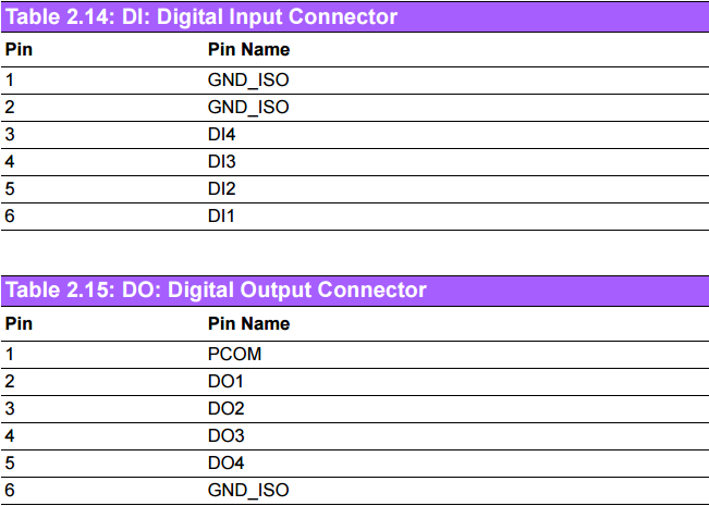

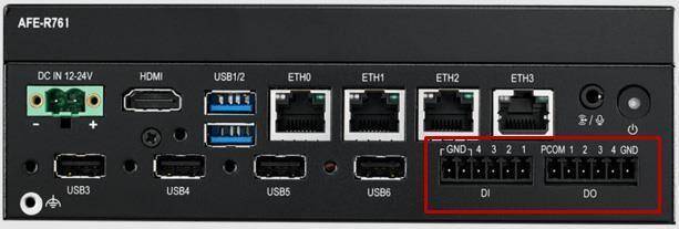

Hardware pin definition:
AFE-R761 supports 4x digital inputs and 4x digital outputs.
DI,DO Ports
GPIO Number
DI1
DI2
DI3
DI4
DO1
DO2
DO3
DO4
Note: The DI GPIO port can only be used for input, and the DO GPIO port can  only be used for output. Do not echo "out" on the DI port or echo "out" on  the DI port.

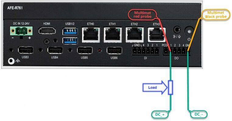

Set and Get DO Status
Take DO1 for example:(The DO interface of UIO-4033 is of sink type,Default state: No output)
# #---- Set 0 to DO1 ----# #
# echo 0 > /dev/DO1
# #---- Set 1 to DO1 ----# #
# echo 1 > /dev/DO1
# #---- Get DO1 status ----# #
# cat /dev/DO1
1
Note:
Setting 0 to make the external circuit NOT conductive. Setting 1 to make the external circuit conductive.
The wiring and measurement methods can be referred to as shown in the following diagram.
Note:
1、There are no specific requirements for the power supply. Just make sure it is within the product POR specification of 5 to 30V DC (and ensure that the overshoot at the moment of power-on does not exceed 30V of the POR). Please be sure to confirm the overshoot at power-on of the POWER Supply being used.
2、When echo is "0", the DO on the UIO is open mode and the level state is high.
3、When echo is "1", the DO on the UIO is closed mode and the level is low.
