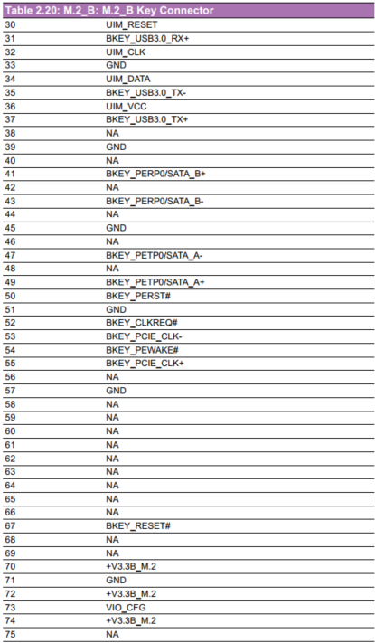

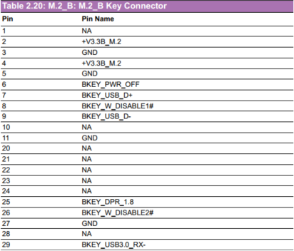

  • 1HW Pin define:
  • 2SW Function: 2.1SATA (model: IM2S3334 - 512GCTB4) 2.2SQF-C8BV2-128GEDE——Bom Option
HW Pin define:
SW Function:
The M.2_B-KEY interface of the AFE-R761 supports two types of signals, and the specific type depends on the configuration you have purchased. One is the PCIE sig�nal, and the other is the SATA signal. To test the M.2_B-KEY SATA signal, can use the SATA disk (model: IM2S3334 - 512GCTB4).
