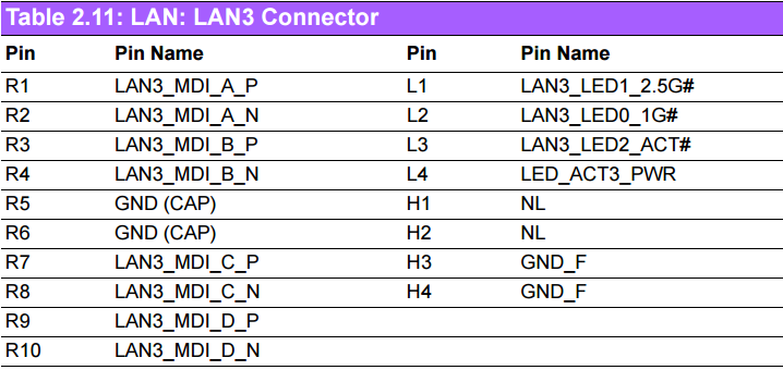

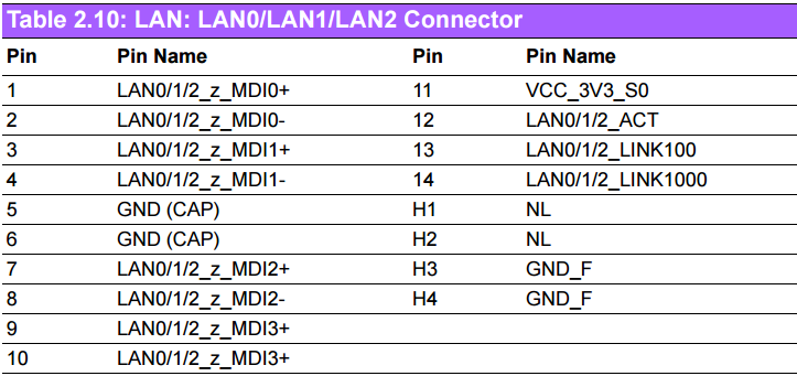

Hardware pin definition:

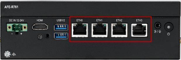

AFE-R761 supports four Ethernet ports: eth0, eth1, eth2, eth3.All ports are using the "DHCP" mode by default. The following configurations and tests are taking eth0 as an example.
