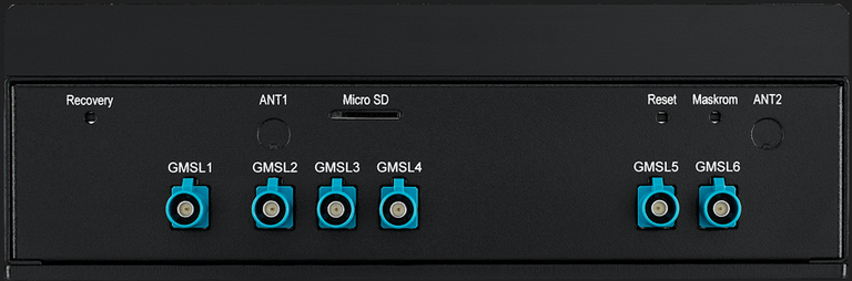

  • 3安装(Installation) 3.1Exploded View 3.2Remove the Bottom Cover 3.3M.2 Module Installation 3.4GMSL/AHD board Installation 3.5DIN RAIL Kit Installation 3.6Wall Mount Kit Installation

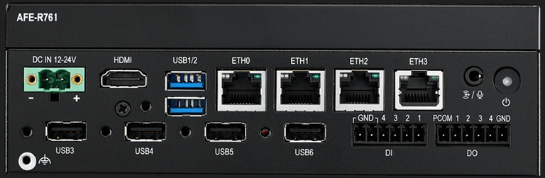

  • Dedicate I/Os for AMR : 1 x 2.5GbE, 3 x GbE, 2x USB3.2, 4 x USB2.0,  2 x CAN FD, 4 x RS-485, 8bit isolated DIO
  • 12-24V DC In, contact: 8KV, air: 15KV, ESD protection
  • Provides a M.2 E Key with PCIE 2.1, USB 2.0 signal and a M.2 B Key with PCIE 2.1/SATA, USB 2.0 signal

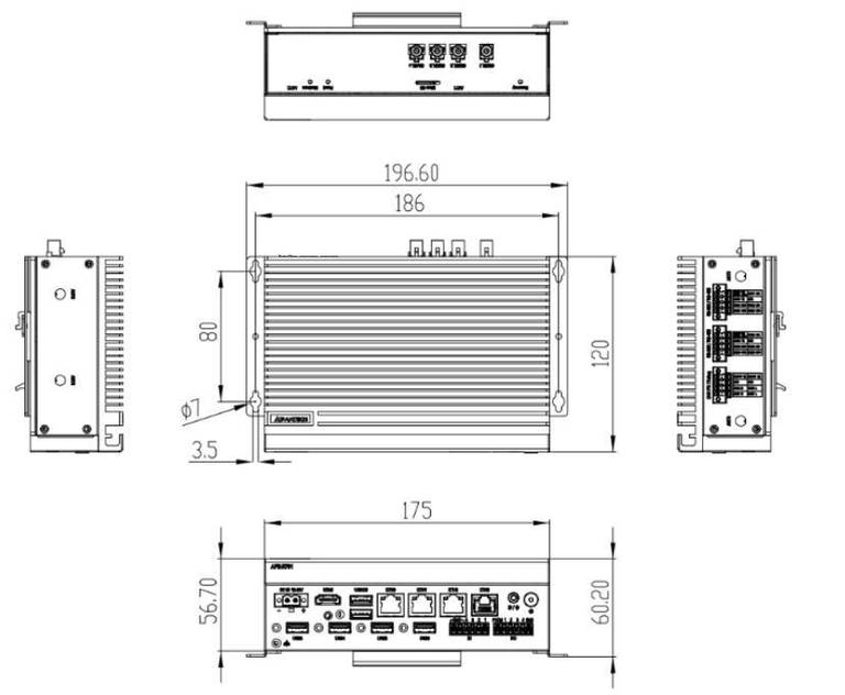

接口尺寸 Board Dimension

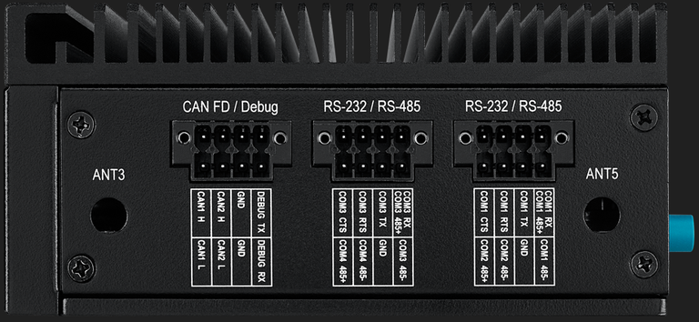

接口引脚定义 (Connector Pin definitions)
Jumper & Switches
The AFE-R761 has a number of jumpers that allow you to configure your system to suit your application. The table below lists the functions of the various jumpers.
Miscellaneous Selection Jumper: SW1
Unscrew the 4 screws on the rear cover, and remove the rear cover. Please refer to the picture to find J1, J2 location.
Jumper List
PositionDescription
SW1COM2/4 485 Terminal
SW2CAN FD Terminal
J1USB0 OTG Mode selection,default USB3.0 host
J2ATX/AT Mode Selection,defa
