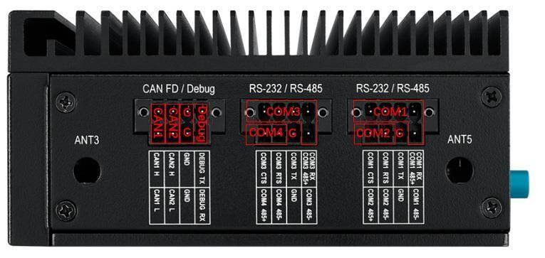

Hardware Pin Definition:
CAN/DEBUG Connector
Pin
1
2
3
4
5
6
7
8
