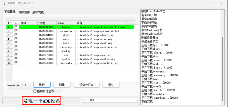

  • 2Open the following file, follow the steps and double-click to install the DriverInstall program, as shown in the figure below:
  • 3Go to the RKDevTool_Release folder and run the RKDevTool.exe program.

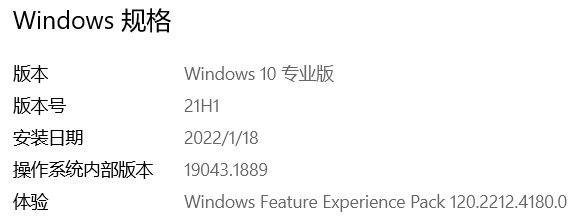

For example, the PC used is a laptop. The specifications are as follows:​

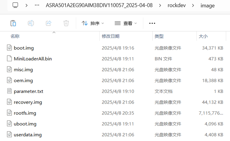

Decompress the downloaded image on the PC.

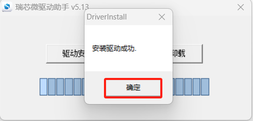

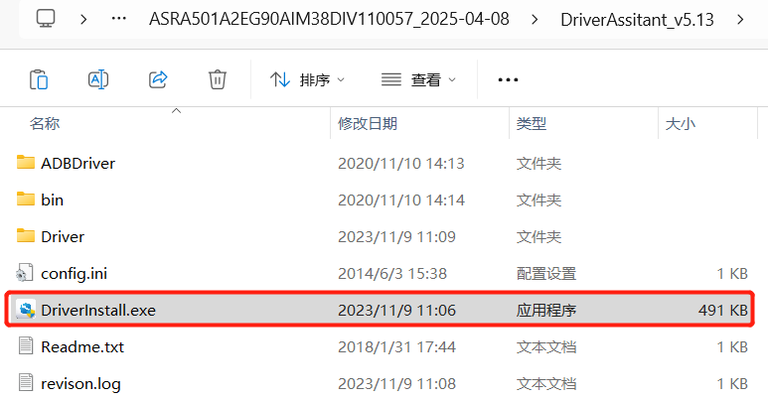

Open the following file, follow the steps and double-click to install the DriverInstall program, as shown in the figure below:​

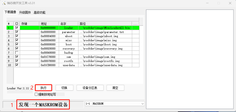

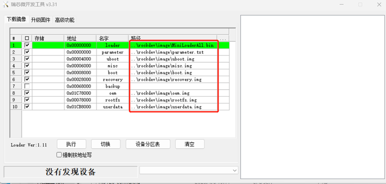

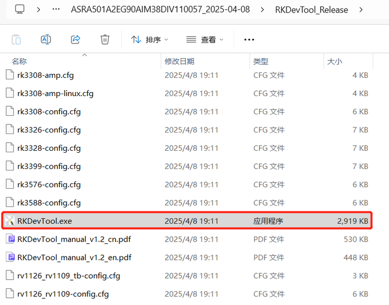

Go to the RKDevTool_Release folder and run the RKDevTool.exe program.​
Note: Please ensure that the path for burning the file is correct.

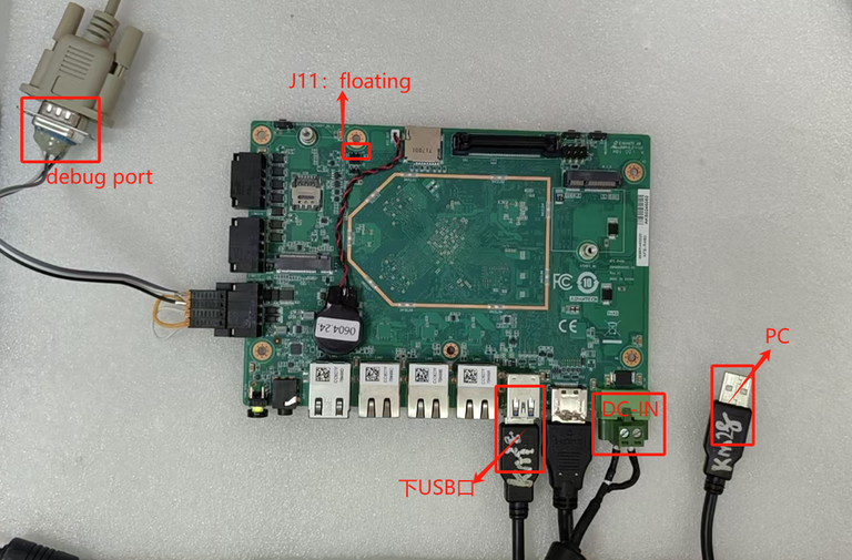

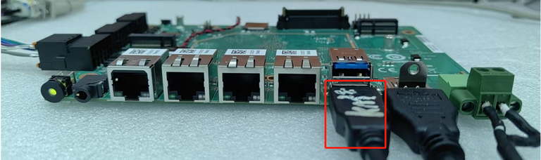

The test environment is set up as follows:​

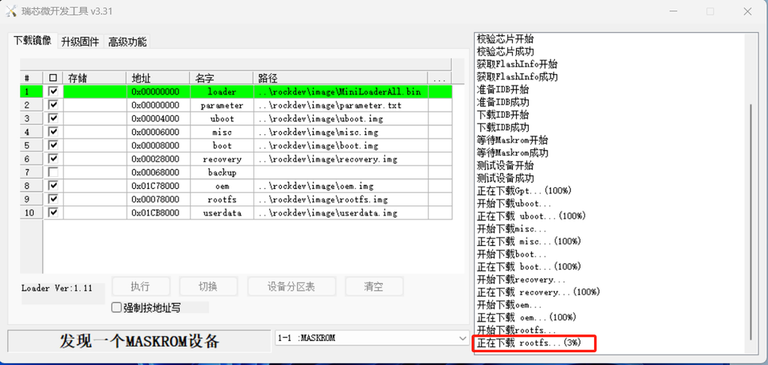

Open the putty tool, enter the MASKROM mode through the debug port, then click "Execute" to start burning the OS.​
Method 1: After powering on and starting up, press "Ctrl+C" to enter "u-boot", input the "rbrom" command, and enter the MASKROM mode.
Debian :
Hit any key to stop autoboot: 0
rkboot # <INTERRUPT>
rkboot # rbrom

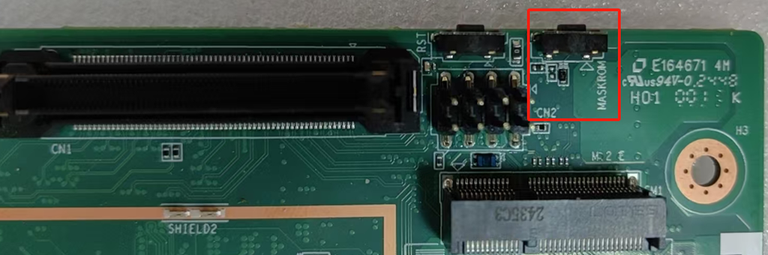

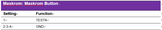

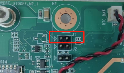

Method Two: Press the "MASKROM" button, then power on and turn on the device, and it will directly enter the MASKROM mode.

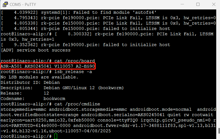

After burning, open putty to check the image version.​
