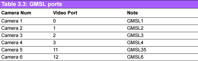

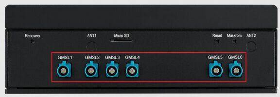

AFE-R761-UxC1 can support 4 ~ 6 GMSL Cameras via AFE-RM02-xPA1 expansion board. The default supported resolution is 1920 x 1080 @ 30fps. Please note that the supported voltage is 12V.

| GMSL:GMSL Camera Connector |
| Pin |
| 1 |
| 2 |
| 3 |
| 4 |
| 5 |

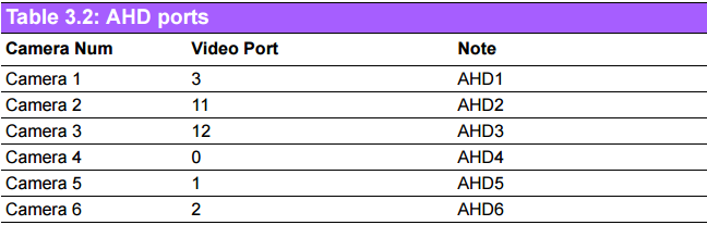

AFE-R761-UxB1 can support 4 ~ 6 AHD Cameras via AFE-RM01 expansion board. The default supported resolution is 1920 x 1080 @ 30fps.
Please note that the supported voltage/current is 12V/200mA.

| AHD:AHD Camera Connector |
| Pin |
| 1 |
| 2 |
| 3 |
| 4 |
