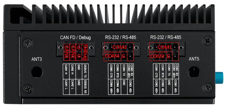

Hardware Pin Definition:
CAN/DEBUG Connector
Pin
1
2
3
4
5
6
7
8

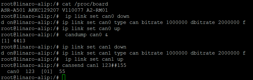

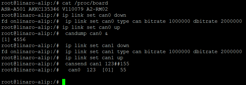

Send and Reveive Data
  • As receiver
# #---- As receiver ----# #
# ip link set can0 down
# ip link set can0 type can bitrate 1000000 dbitrate 2000000 fd on
# ip link set can0 up
# candump can0 &
  • As sender
# #---- As sender ----# #
# ip link set can1 down
# ip link set can1 type can bitrate 1000000 dbitrate 2000000 fd on
# ip link set can1 up
# cansend can1 123##155
# #----If no error, the receiver will receive the following data----# #
Can0 123 [01] 55
See more details of the usage of “candump” and “cansend” :
# candump --help
# cansend --help
