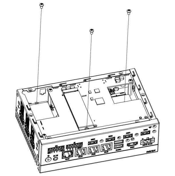

hardwareRockchipRK3588AFE-R761_wiki_dataAFE-R761 M.2 Module InstallationAFE-R761 M.2 Module Installation Remove the bottom cover (2.1.2). 2. Install the M.2 module with 1 x M3x5L screw (per socket). 3. Replace the bottom cover and fix it in place with 4 x M3x5L screws.
