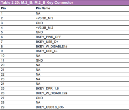

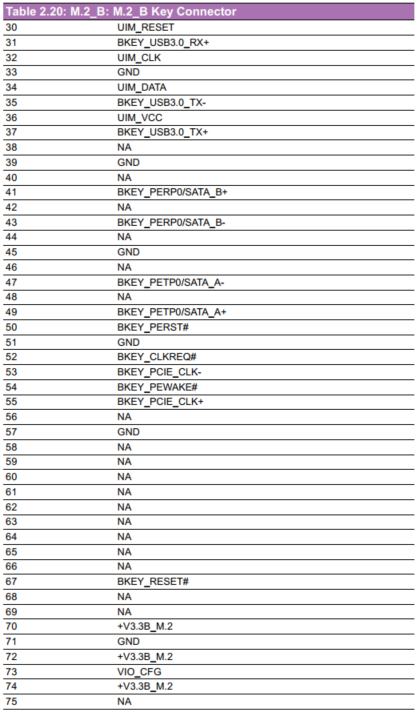

  • 1HW Pin define:
  • 2SW Function: 2.1SATA (model: IM2S3334 - 512GCTB4) 2.2SQF-C8BV2-128GEDE——Bom Option
HW Pin define:
