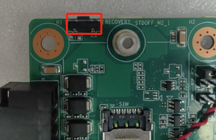

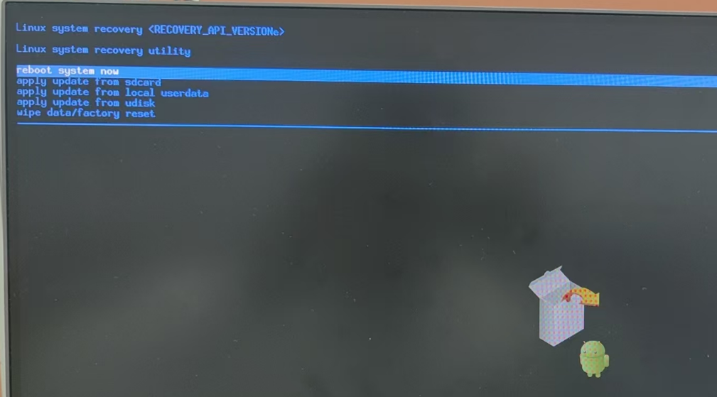

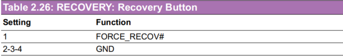

hardwareRockchipRK3588AFE-R761_wiki_dataAFE-R761 RECOVERYOn this pageAFE-R761 RECOVERY HW Pin define When powering on or restarting, hold down the recovery button for a long time as shown in the following figure: SW Function: Please operate according to your actual needs.
