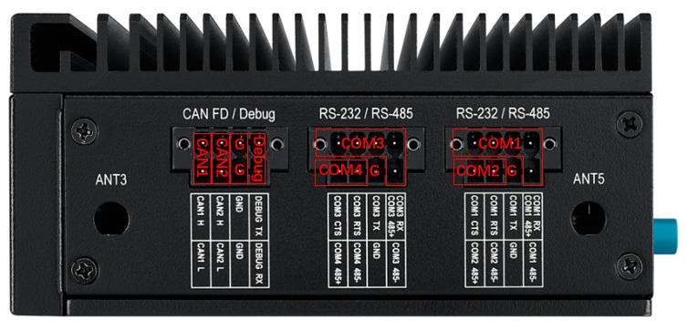

- 1HW Pin define:

HW Pin define:
SW Function:

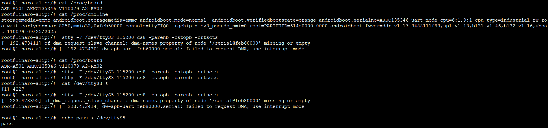

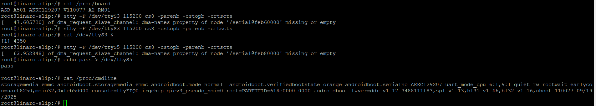

Send and Receive Data
Taking COM4 as receiver and COM2 as sender:
# #---- COM4 as receiver ----# #
# stty -F /dev/ttyS3 115200 cs8 -cstopb -parenb -crtscts
# stty -F /dev/ttyS5 115200 cs8 -cstopb -parenb -crtscts
# echo pass > /dev/ttyS5
# #----If no error, the receiver will receive “pass”----# #
pass
