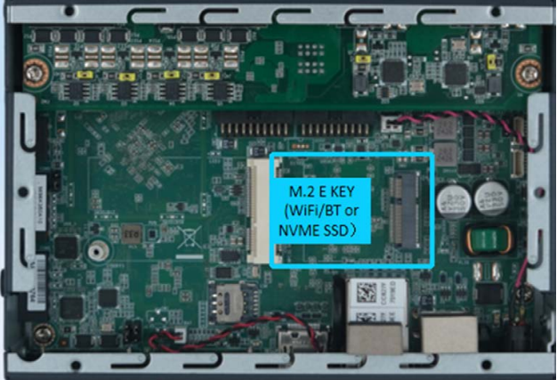

AFE-E630 M.2 E-Key

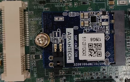

AFE-E630 supports one PCIE port. Using PCIE disk (SQF-C3AV1-128GCEDC) to test PCIE interface.​
Note:
  • Make sure the device is power off before insert PCIE disk, otherwise the device and/or PCIE disk may be damaged.
  • Make sure PCIE disk is partitioned and formatted
