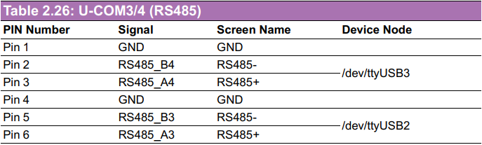

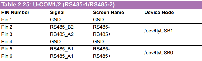

UIO-4035 both have four RS485 ports.

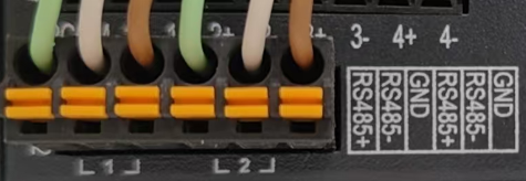

The following figure shows the connection mode.
Taking COM1 as receiver and COM2 as sender :

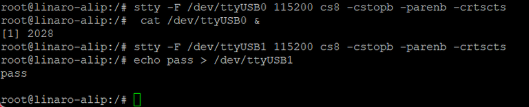

# #---- COM1 as receiver ----# #
# stty -F /dev/ttyUSB0 115200 cs8 -cstopb -parenb -crtscts
# cat /dev/ttyUSB0 &
# #---- COM2 as sender ----# #
# stty -F /dev/ttyUSB1 115200 cs8 -cstopb -parenb -crtscts
# echo pass > /dev/ttyUSB1
# #----If no error, the receiver will receive “pass”----# #
pass
