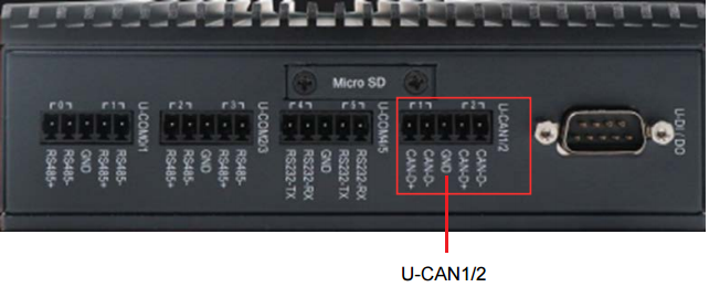

UIO-4031 CAN-FD:U-CAN1/2

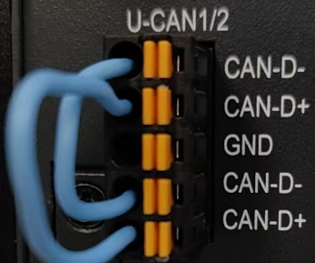

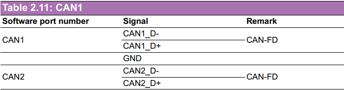

Mode of connection:
U-CAN1_CAN-D-=>U-CAN2_CAN-D-
U-CAN1_CAN-D+=>U-CAN2_CAN-D+
