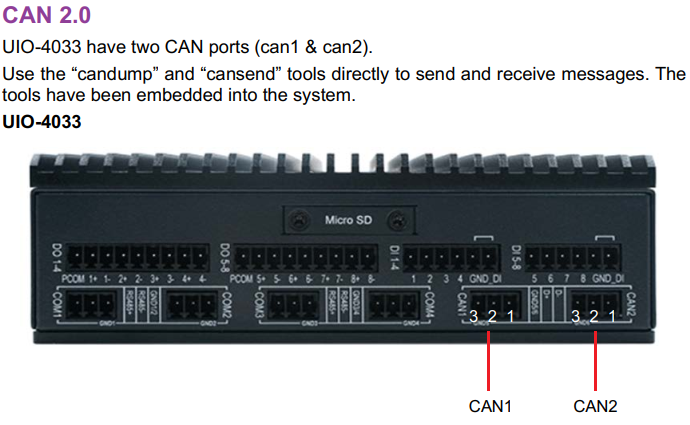

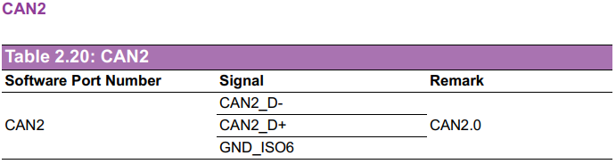

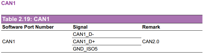

UIO-4033 CAN2.0:CAN1、CAN2
Send and Receive Data​

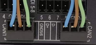

Mode of connection:
Taking can1 as receiver and can2 as sender:
